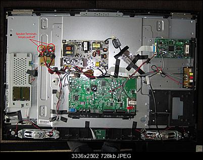

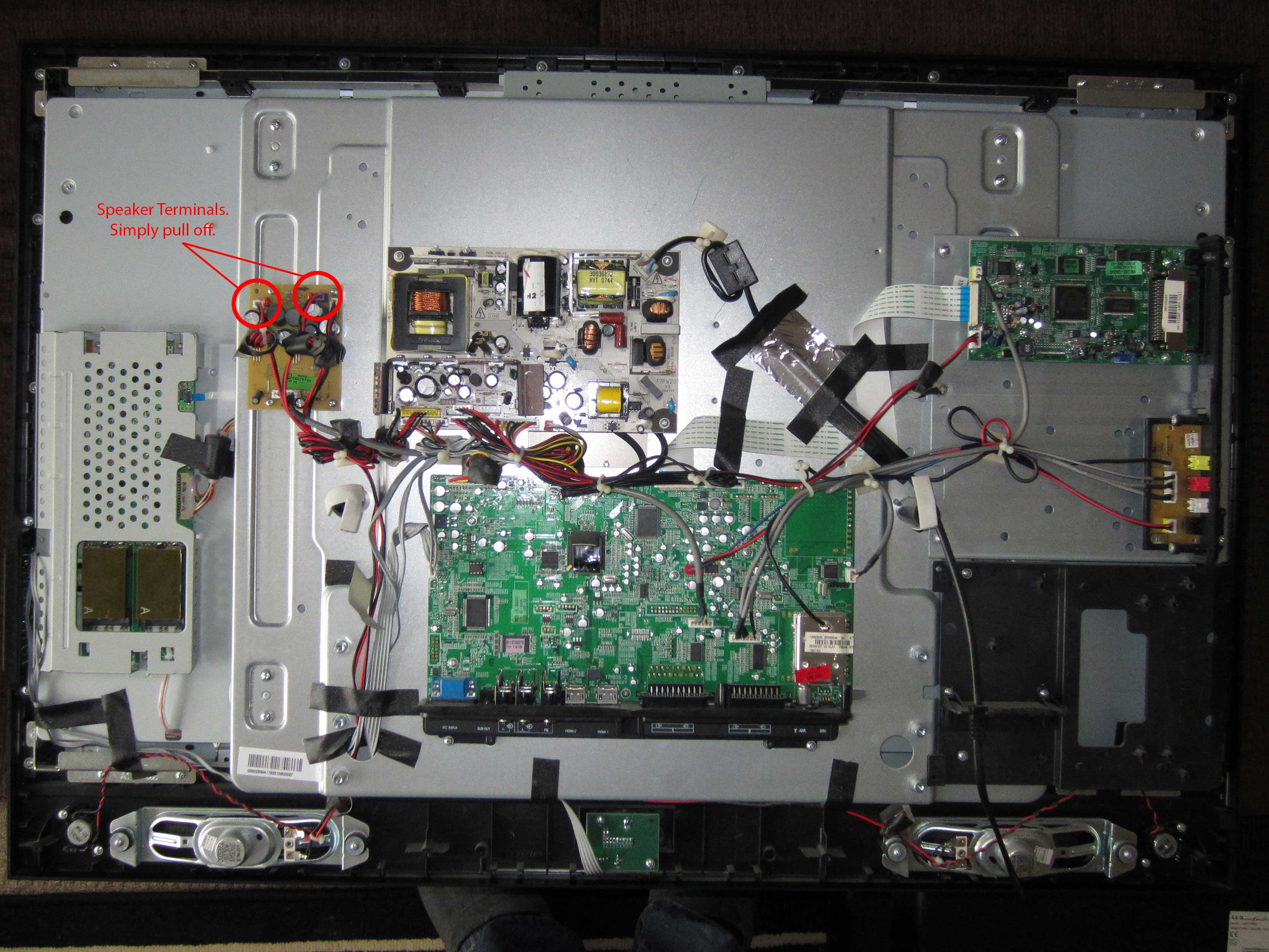

    Just in case anyone wants to know, for the model I worked on: Wharfedale LCD37F1080P, you can disconnect the speakers as circled in the image:
    Easy peasy.
    Edit: Just wanted to say, man those speakers are tiny! And this is an old tv about 3" thick, imagine how crappy todays super thin ones are!! Why do they bother?!?
