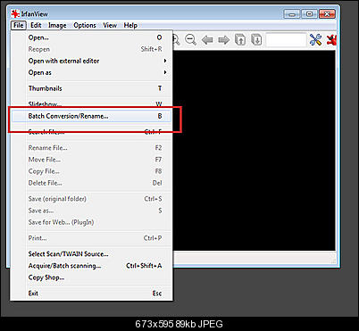

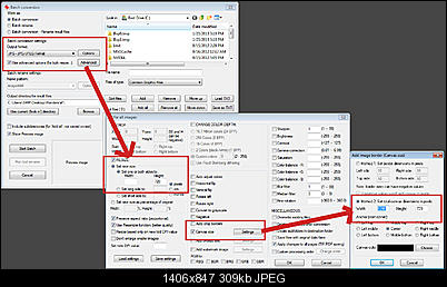

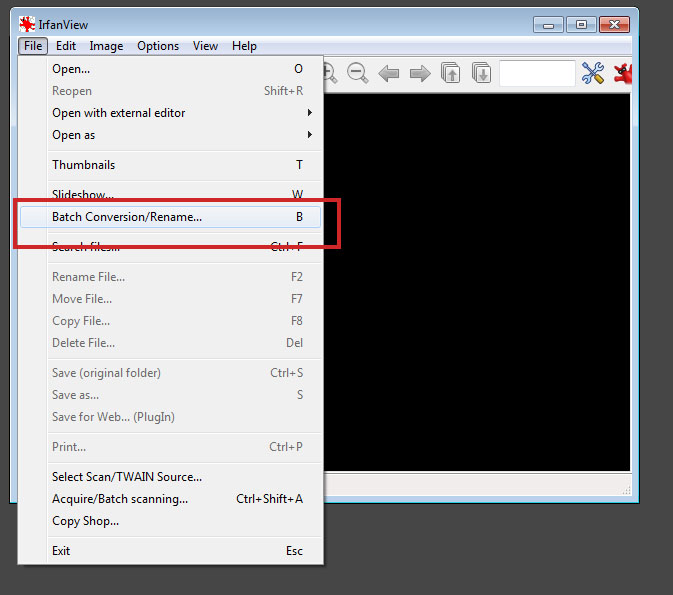

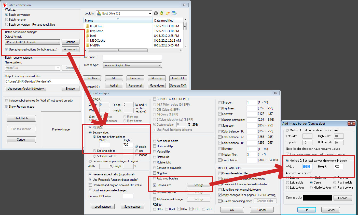

  14. Sure it does.
    I bet this is where FastStone ripped it off from.
