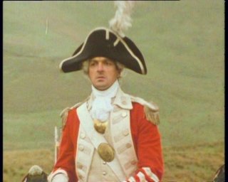

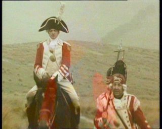

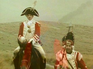

  1. I have an old PAL DVD which is nothing like I've seen before. I assume it was shot in PAL (well it's an old Australian mini-series shot in Australia) and it's interlaced, but seems to still have blended frames of sorts. It's kind of like the colours from one frame bleed into the next. And the interlacing is nothing like I've seen before. Instead of the fields containing every second scan line, it's almost like it's progressive video, but for every second field, the whole image has simply been squished down a bit. There's often no actual motion from field to field, just field blending of some sort where the colours almost seem to be a frame ahead of the actual video.
    QTGMC seems to clean it up fairly well (the video is very noisy) and eliminates most of the bobbing up and down, but the "bleeding" between frames remains. And given the way it's "interlaced", if it's actually interlaced, de-interlacing to 50 fps just seems to result in every frame being repeated. It's not something which is terribly noticeable when watching the video at normal speed, but is there any way to "unblend" the frames, or am I dreaming and just need to live with it?
    Here's a screenshot of three successive frames to show what I'm trying to fix, and attached is a little sample of the video. Stepping through it frame by frame should make the problem fairly obvious.

  2. Interlaced YV12 chroma was incorrectly treated as progressive chroma at some point. That has caused the colors of the two fields to blend together. I don't know any way to fix the problem. Did someone use VirtualDub in the preparation of this video? That's a very common source of this problem -- VirtualDub doesn't handle interlaced YV12 properly.

  4. jagabo, the video is directly from a pressed DVD. It's not a "home video" of any sort.

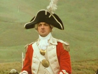

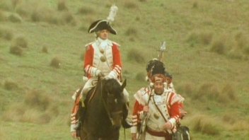

  16. Well QTGMC came to the rescue a bit. Again.
    I just used this:
    QTGMC(sharpness=0.7)
    SelectEven()
    And it did a good job on the scene changes. I guess when I ran a little test encode before starting this thread I didn't notice. My earlier screenshots were taken with standard de-interlacing applied. Once QTGMC did it's thing it pretty much eliminated a bad frame one side of every scene change. So my screenshots went from the three I posted above compromising the scene change, to just two frames, so to speak. One crappy intermediate frame is no longer there. The color difference compared to my earlier screenshots is something I applied manually and the picture was resized to the correct aspect ratio this time.

    It also stabilised the colours nicely in places. In the case of the soldier lifting his arm as discussed in the sample I posted.... well it couldn't do much about that, but where there was less movement and the chroma seemed to still move a frame ahead or behind the action, it now looks a lot more stable. Like it's part of the correct frame. A bit hard to explain really, but QTGMC did a pretty good job.
    Thanks for the interest guys.

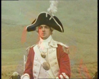

  17. While I was at it, I though I'd pan and scan it and encode a 16:9 version too. I'm not sure I'll do that again in too much of a hurry. It took adding a fair few "trims" to the script to do it.
