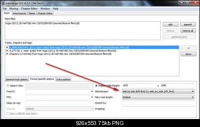

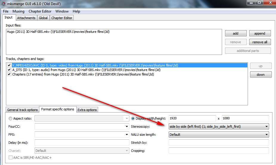

    if it's a player that follows mkv rules you could try re-muxing with mkvmergegui and set the video specs to left image first.

  4. Thanks for the replies guys.
    Cornucopia, I'm using a Sony Bravia TV which unfortunately does not have "image correction" or any swap images feature. I'll leave turning the glasses upside down as the last resort
    I play my movies using VLC player and connect the PC to the TV via HDMI. So is there a better player that suits my needs? I tried mkvmerge and doesn't seem to work with VLC or MPC HC. Also, do you have any recommendations for players that support AVISynth?
    Thanks a lot for your input.
