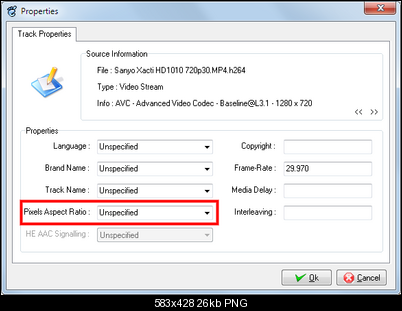

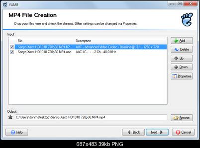

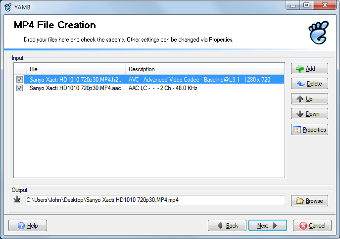

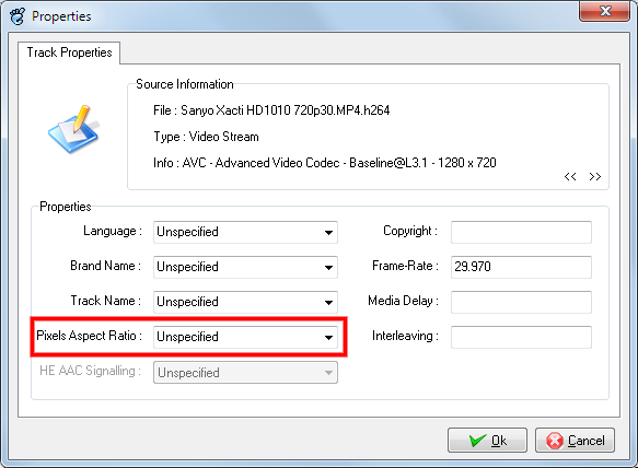

  4. In YAMB: Select the h.264 elementary stream. Press the Properties button. Set the "Pixels Aspect Ratio".
