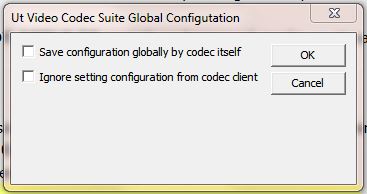

    I need to install the Ut Video codec on my Windows 7 machine. I haven't installed a codec before.
    On install a window pops up with check boxes for "Save configuration globally by codec itself" and "Ignore setting configuration from codec client"
    I'm not sure which of these to check (which one/all/none?).
    Any input is appreciated....

    Here is screenshot...Name:  UT Video Question.JPG

  4. If you want to force all programs to use fixed settings (ie, the programs can't change the settings themselves) enable the second item. If you want to let UT save it's settings in the registry, and default to the saved settings, enable the first option. You can change the settings any time by selecting Start -> All Programs -> UT Video Codec Suite -> Global Configuration.
