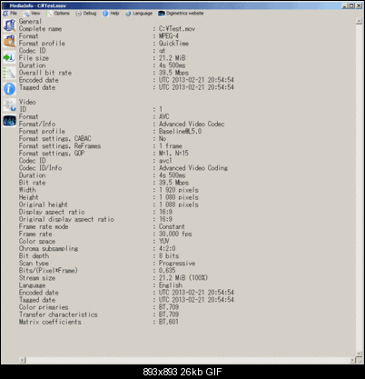

  17. OK, so here's a screenshot from MediaInfo, for a 4.5 seconds clip.
  18. P.S. Sorry, I was talking about the bit-rate, not fps w(hich is 30)
  19. OK, so about my last question- would mpeg2 encoding with ffmpeg be the best solution in this case...?

    No mpeg2 is not the best solution, nor is re-encoding one or 2 more generations down to any other intermediate (except maybe lossless/VL). Stick with your originals. Figure this remuxing thing out first. Your bitrate is high to keep quality UP, given that your GOPs look like: IPPPPPPPPPPPPPP. This isn't quite as easy to edit as all-I-frame video, but it's not terrible (like some super-long-GOP xvids & AVCs). Try AVIC again: put "h264" in both slots (type them in if they aren't in the list).
  22. I used again avic, put h264 manually and checked with MediaInfo. Now Codec ID is h264 (before it was avc1); everything else is the same.
