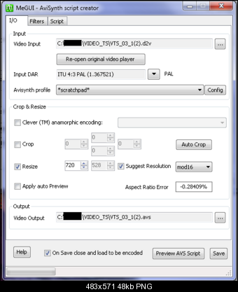

    I'm trying to backup my anime dvd to an x264 MP4 with MeGUI, but I have a few concerns.
    I want to either not resize it and have it be anamorphic to 4:3 OR resize it to full screen with minimal loss.
    Also, I used the x264 settings from http://ayumilove.net/ayumilove-megui-x264-encoding-settings-guide-hd-quality/
    But it gives a bitrate of 729, which I feel is a bit low.
    The original DVD is anamorphic with the MediaInfo stats:

    Oh, I see what you mean. I'll try and be a bit clearer.
    The DVD has a resolution of 720:576, but displays as 4:3. I want to know the resize settings for MeGUI that will give the best results.
    Also, I notice that most high quality anime's have a bitrate between 1400~1800. So when I get an output of 729kbps, I feel like there's been too much compression. I used the x264 settings from http://ayumilove.net/ayumilove-megui...de-hd-quality.
    I would like someone's opinion on this.
  4. Are you cropping the video at all? Assuming for the moment you're not.....
    Theoretically, the best method to use is one of the anamorphic options which doesn't resize. "Encode non mod16" doesn't resize and it doesn't adjust the cropping (if you're cropping), so the video is encoded "as-is", and it relies on the player resizing it correctly as it would the original DVD. Not all hardware players will display the encoded video correctly if you use anamorphic encoding, so it's something to consider before using it.
    The next best option is to resize "up". Hit the "config" button next to the AVISynth Profile dropdown box and the option to enable resizing "up" is in there. There's also an option in there which tells MeGUI how much it's allowed to fudge the aspect ratio. If you crop the video it enables MeGUI to resize to exact 4:3 or 16:9 aspect ratios when using anamorphic encoding, without having to crop the video to exactly 4:3 or 16:9 dimensions. If you don't want MeGUI to "fudge" the aspect ratio at all, set it to 0%.
    Once resizing "up" is enabled, change the mod16 setting next to the resize area to mod2. You want to leave the height at 576 and increase the width until the aspect ratio distortion is as low as you can get it. You'll end up with 788x576, using your screenshot as an example.
    Now for the more tricky bit. 788x576 isn't 4:3. That's because MeGUI has selected ITU resizing in the Input DAR section. ITU resizing isn't exactly 4:3 (or 16:9). You can change that to straight 4:3 resizing manually. If you do, you'll also need to change the resizing a little. 768x576 will give you a zero aspect error and it also happens to be exactly 4:3.
    The third best resizing option is to resize "down". Instead of increasing the width, you reduce the height. ie 720x540. Depending on the DVD you're encoding that might lose you a little fine detail compared to 768x576, but often it won't. Often you can go all the way down to 640x480 (still 4:3) before you have a chance of seeing a difference. It just depends how much detail the original video actually contains. Use the preview function to compare resizing methods to see if you're losing detail resizing down compared to resizing up etc (keep in mind the preview doesn't display the correct aspect ratio if you use anamorphic encoding, but don't worry about it, it'll still be encoded correctly).
    Back on the ITU resizing subject..... there's no way to know for sure if a DVD uses the ITU resize method or the straight 4:3 (or 16:9) resize method. As a general rule, they're more likely to use straight 4:3 (or 16:9) resizing. In my opinion. The difference isn't all that great anyway.
    If you go into MeGUI's options, under the Main Configuration tab, there's a checkbox labelled "Use ITU Aspect Ratio". If you uncheck it (which I do) when you next open a DVD, MeGUI will default to displaying exactly 4:3 (or 16:9) in the "Input DAR" section, rather than default to ITU resizing.
    Hopefully that helps. The whole resizing/aspect ratio thing for DVDs can take a bit to get your head around, but eventually you will. I did, so I assume anyone can....
