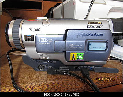

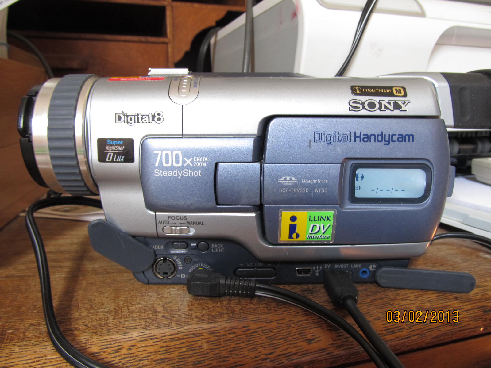

  6. Click image for larger version
Name:	high 8 008.JPG
ID:	16585this is it a Sony High8 DCR-TRV 330
    Oct 2005
    666th portal
    wrong. read the f'ing label on the cam. DIGITAL8 not HIGH8.
