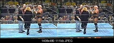

    Using SeparateFields().nnedi3(dh=true) rather than QTGMC() gives better image quality when the video is bouncing, worse when it's still. Worth a look. nnedi3 on the left, qtgmc on the right:
    setmtmode(5,8)
    function DebounceVertical(clip source)
      last=source
      mdata = DePanEstimate(dxmax=0)
      DePanStabilize(last, data=mdata, initzoom=1.05, dxmax=0, dymax=4)
    src=Mpeg2Source("E:\Downloads\Shake.d2v", CPU=6, Info=3).Trim(0,200)
    setmtmode(2)
    ned=SeparateFields(src).nnedi3(dh=true).DebounceVertical()
    qtg=QTGMC(src).DebounceVertical()
    StackHorizontal(ned,qtg)

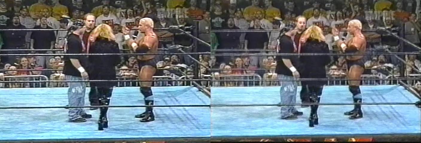

    Oops. Forgot to post the output. Still some noise in the darks, but the object was to stop frame hopping. Some dark ghosting from the original tape is evident, and watch banding in the black background. Upping the bitrate helps. This is how many generations, now? Five? Ten?
