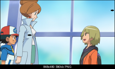

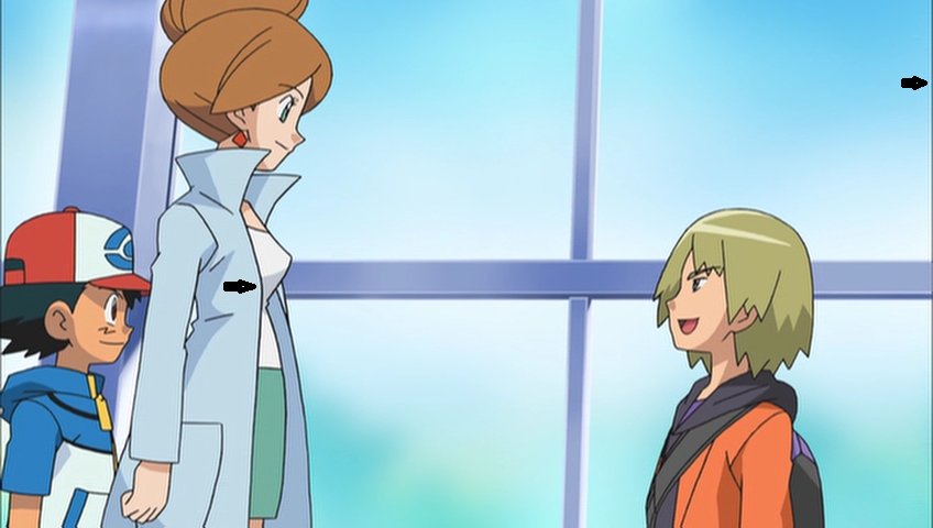

    How to fix this (black arrow)?

    What's wrong with it?
  3. Originally Posted by hech54 View Post
    I think he means the line along the right side and the slightly lighter colored video to the right of it. When you click on the picture and see the larger size you can see it better.
    If it bothers you so much crop it away. Me, I don't think it's worth it.
  4. Member hech54's Avatar
    Jul 2001
    Yank in Europe
    There are two arrows. Aside from the fact that it is amine I see nothing wrong.
  5. Banned
    New York, US
    There is mild but visible halo or ghosting on along both sides of edges. Hard to say without a video sample, but deHalo_Alpha or similar plugins might do the trick.
  6. Originally Posted by hech54 View Post
    Hehe, I didn't even notice the second arrow until you pointed it out. I think sanlyn's right that there's some mild edge enhancement. And I'd also recommend DeHalo_Alpha if jentayu7 feels something should be done about it.
  7. Originally Posted by sanlyn View Post
    There is mild but visible halo or ghosting on along both sides of edges. Hard to say without a video sample, but deHalo_Alpha or similar plugins might do the trick. The O.P. might also want to think about adjusting luma and chroma levels for display other than PC-only.
    I've already tried dehaloing filter like DeHalo_Alpha but it didn't work. Did you know any ghosting filter for AviSynth 2.5?

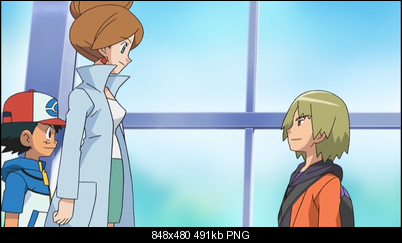

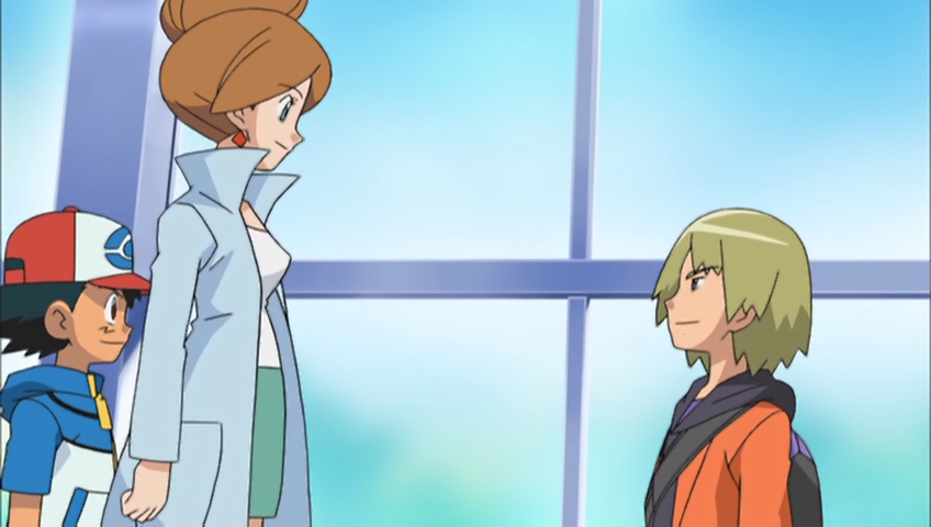

ID:	16590Click image for larger version
    This is the result when I use YAHR dehaloing filter
