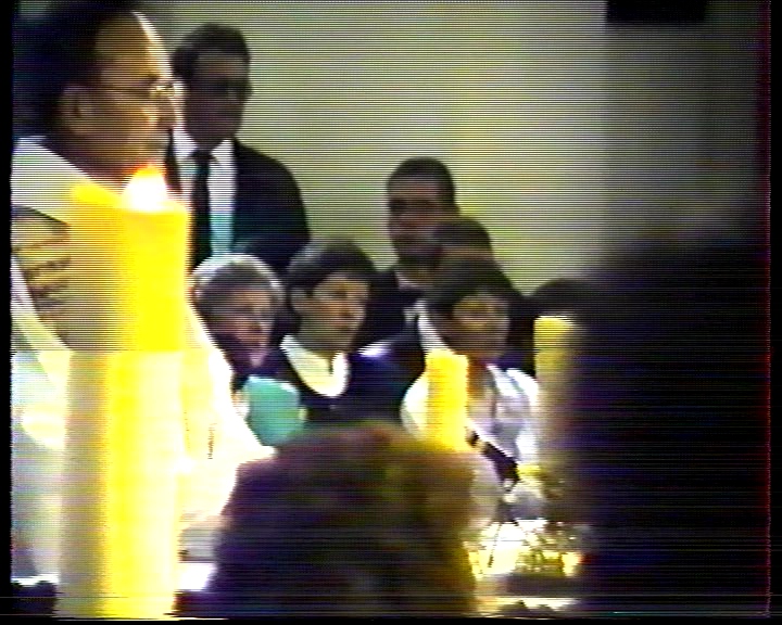

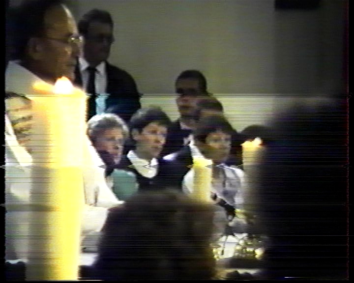

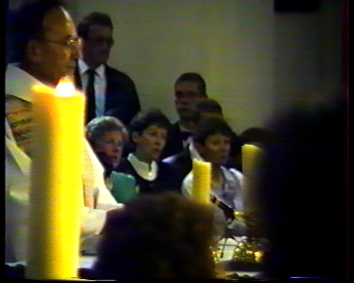

    I have a problem when I'm restoring VHS.
    VHS have certainly physically be dommaged and when I attempt to read them I get luma problem like in the attachement.
    When I use the hitogram() function in avisynth, I see the first is verylow when picture is damaged.
    Do you think it's really a luma problem ?
    Do you thlink it's possible to store luma, to detect bad luma and replace it by the stored luma of the frame-1 ?
    thanks for your help.

  4. Obviously the luma levels are different during the good and bad fields. We can't tell much about the chroma because JPEG encoding has blended the chroma of the two fields together.
    If the bad spots are only a few fields in a row you can use a function like ReplaceFramesMC() (aka RX()) to replace them with motion interpolation. Or, if there's very little motion, simply duplicate the good frame just before or after the bad sequence.

    "Luma error" IMO is far from the worst problem , even if some dark shadows and many brights are wiped out forever and won't come back. The worst problem is MJPG compression artifacts and the kind of coarse, ugly skin shadows that compressed MJPG is noted for. Nopt to mention heavy grain that hides banding, so it sneaks up on you when grain and noise are removed.BAnding under the noise is almost visible below, and prominent along skin shadow edges, with shadow discoloration looking just like that in JPG photos. Odd, but even though Red is oversturated in the original, the oiverall color balance is too green (evident in the non-existent "whites" and "grays", while many "blacks" aren't black.
    [Attachment 16615 - Click to enlarge]
    The Red stain along the right wouldn't budge, so I removed 22 pixels from the right, 12 pixels of noise from the bottom, and fixed borders so the image could be resized to the proper 1.5:1 ratio in a 720x576 PAL frame. With much of the noise gone, in upper right you can see the return of the original video's color banding. It's most obvious when the cameras moves. Skin tones and shadows were a real challenge, and there's the temptation to make the priest's vestments "blazing" white, but that's not what vestments look like. The white hat of the lady in green, the white shirts, and shadows in white areas wrere guides for finding the white band gray balance, with black hair and a black bowtie the guide for RGB 16 black. How the original scene looked is anyone's guess, but at least the priest doesn't look plastic and ladies don't have cyan-tinged 5 o'clock shadow. Beyond that, more sharpeners and more denoisers can't overcome the losses from fuzzy MJPG compression.
    [Attachment 16616 - Click to enlarge]
    My script started with jabago's idea (I added 2 more frames to his list), then added:
    SmoothLevels(for dithering to tv range), QTGMC ("medium"), DFTTEST, ChromaShift(c=-2), then DeHalo_Alpha + LSFMod() + GradFun2DBmod() defaults, and finished with AddGrainC(1.5, 1.5) to try to fend off banding. The attached "v5.mkv" is re-interlaced. The Resizer was Spline36Resize. The bulk of color and gamma corrections were in RGB with gradation curves for primary and secondary correction. There is no way to fix those whites and skin shadows in YUV. Usually people don't bother with color anyway but head straight for the sharpeners, so I'll just leave it at that.

    The comments in my post (#20) can be visualized more clearly if you click on one of the images to view them in the forum's viewer. Then you can click "Prev" or "Next" buttons to switch quickly between the two images. Thanks to jagabo's script for leading the way with the basic luma/chroma fixes and frame replacements, which looks pretty good. All I did was add more cleanup and go farther into color.
