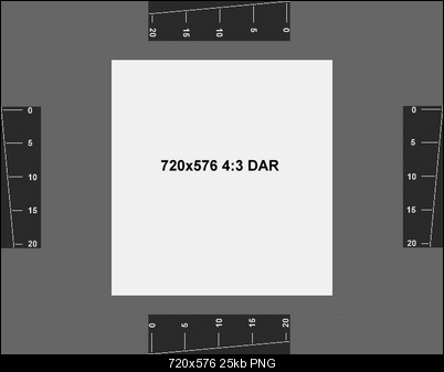

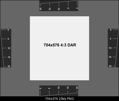

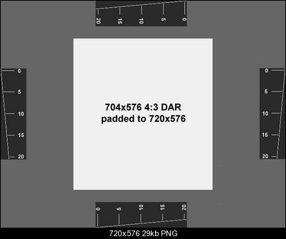

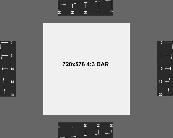

    If you want to work with some clearer test patterns:
Name:	704x576.4x3 DAR padded to 720x576.png
    With devices that follow rec.601 PAR scaling the white box should be square in the first two images (704 and 704 padded). With devices that follow MPEG 2 scaling the box should be square in the last image (720).
    The 704-padded-to-720 image has the edge markers moved out rather than just padding with black borders. That way you can tell if the player crops the edges of the frame or includes it.

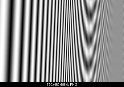

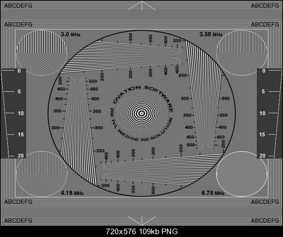

    Yes, I have such patterns. Most are set up for NTSC but you can pad the top and bottom of the frame to make PAL versions.
Name:	Resolution slanted lines 720.png
    But it's very hard to compare this type of pattern because of moire problems.
    THAT was a useful edit! Thanks, also for the other patterns.

  18. I had a chance to make a PAL DVD from the earlier AR test patterns. I made three 4:3 DAR m2v encodings, one from each image (no scaling of the images before encoding). I made a fourth m2v using ReStream to add a sequence display extension to the 704-padded-to-720 m2v, indicating the 4:3 DAR was in a 704x576 sub frame. From the top down on the DVD menu:
    1) 704x576 4x3 DAR padded to 720x576: This uses rec.601 PAR (assuming 704x576, not ~702x576) with the frame padded to 720x576. When following the rec.601 spec the full frame should appear slightly wider than 4:3 (or only the inner 704x576 should be displayed at 4:3 DAR). The square should appear square. When following the MPEG 2 spec the entire 720x576 frame should be 4:3 and the square should appear slightly taller than it is wide.
    2) 704x576 4:3 DAR padded to 720x576 SDE704: This is the same video as #1 but with the addition of an MPEG 2 sequence_display_extension flag to indicate the 4:3 image appears in the inner 704x576 sub frame. Following either the rec.601 or MPEG 2 specs the entire frame should be slightly wider than 4:3 and the square should be square.
    3) 704x576 4:3 DAR: This uses rec.601 PAR with a 704x576 frame. With both rec.601 and MPEG 2 decoding the entire frame should render 4:3 and the square should appear square.
    4) 720x576 4:3 DAR: This program uses the implied MPEG 2 PAR. With MPEG decoding the entire frame should be rendered as 4:3. The square should be square. If rendered with rec.601 scaling the frame should be wider than 4:3 and the square should be wider than it is tall.
    The VIDEO_TS folder was burned to DVD and played on my Blu-ray player, an LG BD670, hooked up via HDMI, upscaling to 1920x1080p60. This is a region 1 NTSC player but can play PAL DVDs. The LCD TV it was hooked up to has pixel-for-pixel capability so it can display every pixel of a 1920x1080 intput (no overscan simulation). The Blu-ray player's upscaled HDMI output followed the MPEG 2 spec for all 4 videos. I was able to see every pixel of each clip (nothing was cropped).
    1) The entire 720x576 frame was scaled to 4:3 DAR. The square was rendered too narrow, measured on the LCD TV screen as 37.2 cm wide, 38.2 cm tall.
    2) The entire 720x576 frame was rendered slightly wider than 4:3. The square was the right shape (38.2 x 38.2 cm). I was a bit surprised by this. I've never seen a commercial DVD use the sequence_display_extension like this so I didn't really expect it to play properly.
    3) The 704x576 frame was scaled to 4:3 DAR. The square was square (38.2 x 38.2 cm).
    4) the Entire 720x576 was scaled to 4:3 and and the square appeared square (38.2 x 38.2 cm).
    I played the VIDEO_TS folder via a network share on my WDTV Live. This was also hooked up to a 1920x1080 LCD HDTV with no overscan simulation. I was able to see very pixel of each clip. The WDTV Live's behavior was similar to the Blu-ray player except it ignored the sequence_display_extension in #2, displaying the picture the same as #1.
    I don't currently have anything set up to test the analog output of any players.
    VIDEO_TS folder attached as a ZIP archive.

  21. Originally Posted by fvisagie View Post
    it's a CRT display
    There's your problem. As I noted in post #11 CRTs typically have large AR problems. Never use a CRT to adjust aspect ratios. Unless the CRT's AR was just calibrated (most have internal adjustments for AR among other things). Even then you should be careful as the AR can vary with picture brightness.
    And I thought I was seeing things! Thanks for the confirmation.
