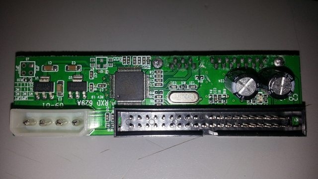

    there was 2 changes however. there are 2 red LED's on the adapters. when I short the slave adapter (I tried both positions on the cable adding the shorted unit in the slave slot and in master slot of the ribbon cable)
    in both positions the SHORTED adapter one of the red led's no longer illuminated AND the "other" master drive does now show up in windows.
    but the slave drive still persist in not showing up (but no longer prevents either from showing up)
    I tried both my 80 wire cables the one marked primary slave and the unmarked on. no joy.

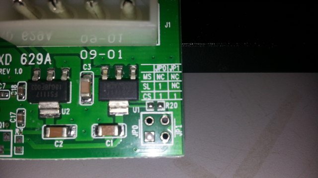

    these are the ones I got from a US seller from amazon.com (so I would not have to wait for the chinese one turns out it did not matter)
    but I noticed they are DIFFERENT note the second image. what do I do to set CS ??
    if I could properly program this I could do each machine for $9. this one cost $6 the chinese ones are a little less than $3
    if the chinese ones are master and I "set" the amazon one to "slave" they should play nice together

  11. does anyone know how to make sense of the instructions on that second sata card I have.
    I do not understand what 1 and NC mean for each position desired.
    what do I "jump" for each one ?
    I just can't figure out what it means. does NC mean No connection?
    then it has a 1 and NC does that mean jump JP0 but No Connetion JP1
    and for CS (which is what I really want) does that mean I have to jump "BOTH" connection. ??
  12. 1 means connected, NC means not connected. Yes, connect both for cable select.
  13. damn got to wait till I get home to use the sodering iron since the one pin is "filled" the other one all 4 are filled. so gonna have to solder in a connector can't just jimmy it with some wire means I have to wait till next wednesday to test it

    It is typical to use a two pin header connector for this situation. http://www.allelectronics.com/make-a-store/item/DHS-40/2-X-40-PINS-SNAPPABLE-HEADERS/1.html

  16. yep but I ain't got any of those so wire and solder it is plus I have to desolder the holes (some of them are filled)
  17. Sometimes when I'm lazy I'll just drag a big glop of solder between the two holes.
  18. hahaha I was thinking EXACTLY that but then thought. yeah Mr Murphy REALLY hates me and my soldering skills so no hehehe
    Sep 2006
    You most likely don't have to remove the solder just heat it and push the lead through then add additional solder

    I hope we can read success on this. Since a SATA cable is a single-thread-user, I don't think Master, Slave or Cable-Select choices would make much difference. However, I bet this card needs to match the Drive's Setting for this. If the drive is set to Master, then set the Card to master.
    I don't think soldering would be necessary - just use the Jumper on the drive itself to match this adapter card's setting - whatever it is (and I can't determine if the soldered hole in JP0 means one or the other. But I think "matching the Drive to this card" is all that's necessary. Since the drive is easily jumpered, I'd try those settings, over and over, and see if there is a "behavior change".
    Yup, from that pic its set to slave actually.
