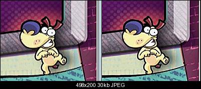

  6. If the video has jagged (aliased) edges from deinterlacing you might be able to reduce the frame size by half then use a smart enlarging function like nnedi3 to upscale with better results. But you'll have to do that with AviSynth in Windows. Sample crops from a bobbed video and after fixing with nnedi3:
    Image Attached Images

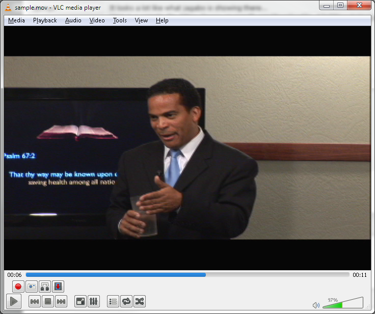

  12. I'm a MEGA Super Moderator Baldrick's Avatar
    Works in vlc.
    Yup, jagged edges.

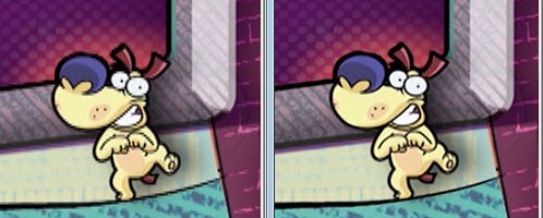

  17. I just realized ffmpeg can read the ProRes mov file. Here's a sample where I tried to reduce the buzzing around the lapel at the cost of a little overall sharpness. You can probably do a little better with some fine tuning.
    ffVideoSource("ProRes sample.mov")
    SeparateFields()
    SelectOdd()
    BicubicResize(360,240)
    nnedi3_rpow2(2)
    Sharpen(0.3)
