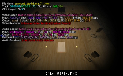

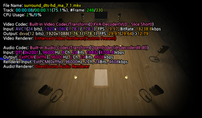

bobolinkeuphoric, the audio output in your screenshot is really weird. You are doing something wrong in your setup.

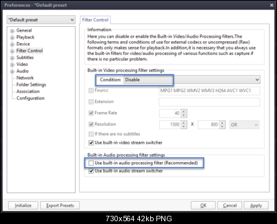

Disable the following built-in processing filters in the screenshot below and what version are you using? The latest version is 1.6.47995.
I guess there is another raw audio filter (maybe ffdshow) in your filter chain from your screenshot. Disable it if you can.Last edited by sheppaul; 30th May 2014 at 21:13.

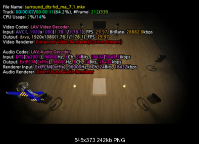

Yes, im guessing its something with my setup. But potplayer is the only one I have problems with. No point in trying too hard to make it work, just wanted to mention it. This on the latest potplayer with the above settings.
Using dxva native just freezes the player.
What I have found out with lav audio\video is that with dts-hd and dxva copy on, the player just goes frame to frame. Disable dts-hd, and it starts playing fine with just dts. Disable dxva or set to intel quicksync it works with hd audio.
To get it to play with dxva I can start it with dts, then when its playing enable dts-hd and it works. -

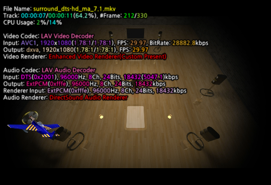

That doesn't mean anything. You should check filter > lav audio decoder > status tab. It should say "dts-hd ma".
(If you don't have dtsdecoderdll.dll it most definitely doesn't decode dts-hd ma. It can't.)
You should also check LAV video the same way. It should show "active". Try changing the DXVA modes, if you didn't so far. Also what kind of Video card you have? -

Yes, you can see the filename in my screenshot above but i have no idea why the OSD info displays DTS instead of DTS-HD.
