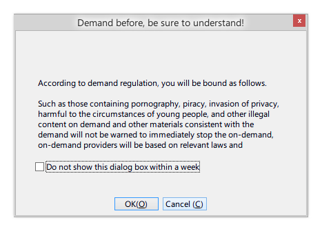

  22. Anyone know what shortcut I must have pressed to get this dialog window? Not sure what function it's for.
  23. Originally Posted by After Hours View Post
    Hotkey for showing random engrish text?

    This looks like some text that should appear when you use the normal version of PotPlayer executable and try to access the streams from the Daum site,
  25. Originally Posted by Havokdan View Post
    Strange, as I was using the VideoHelp English version and wasn't accessing anything from Daum. Must be a shortcut I wasn't aware of, even though nothing in the menu suggests it. *Shrugs*
