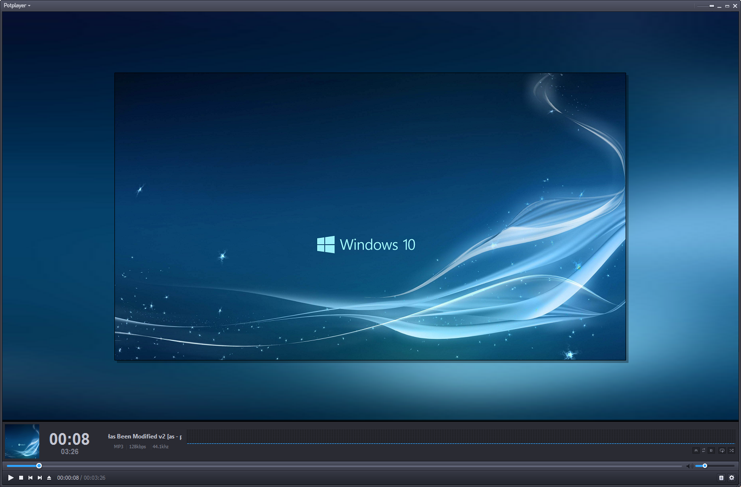

  12. Greetings
    I am a long time user of potplayer and i had a question.
    When you use album art when playing audio it never fills the screen passed a certain resolution.
    An example here https://forum.videohelp.com/images/imgfiles/IQCxO2r.png
    This is a full desktop resolution image just to make sure that it is not to small.
    Slideshow does work but that doesn't use the folder images otherwise i would use that.
    Anyone happen to know what it causes and if it is fixable? Sometimes i just want to full screen my music with a nice image while doing something else.

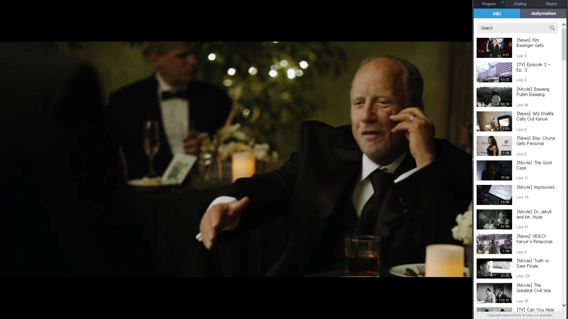

  22. How can I get rid of this so I never have to see it again?
    https://forum.videohelp.com/images/imgfiles/qqqWcnT.png
    It is just one of the worst features. The beginning of the end of this player.
    It pops up constantly when I move my mouse into view. I want it gone, erased, forever.

  25. Originally Posted by Budman1 View Post
    Default skin, that in itself doesn't solve the issue, this comment however gives a great step by step. It's too bad the dev included this cancer.
    > I'm not 100% sure, but not all skins display that window correctly, so you need to switch to default one. Then you should see tabs 'Program' and 'Playlist'. Click blue arrow in 'Program' to detach the window from main program and after that you can close it with x. Additionally you can delete 'Html' folder in PotPlayer catalogue in Program Files. Nevertheless, the folder will be recreated after next update.
  26. Member Budman1's Avatar
    Jul 2012
    NORTHWEST ILLINOIS, USA
    Thats why the link to the step by step was included.
  27. Member
    Jan 2013
    Germany
    Got rid of that shitty screen [while keeping BlackBoxVFD skin] by toggling a "Broadcast" [and possibly "Default Open"] selection/setting.
