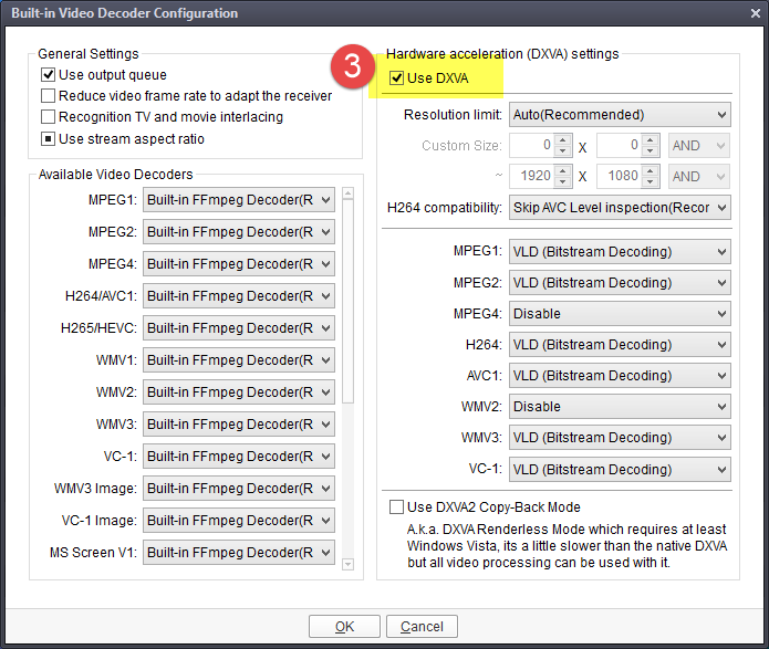

  10. hi guys im having a problem with pot player .
    when i paly HD Movie cpu usage is very high
    but in the previous versions there was no problem .
    since this version( PotPlayer1.6.47450) i have this problem . the cpu usage is very high when i play HD Movies
    could you help me out ?
    thanks

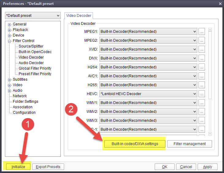

  11. Check if the previous version is still working with very low cpu usage.
    If you have no problem with a previous version, follow the steps.
    Install the latest version: http://get.daum.net/PotPlayer/Beta/PotPlayerSetup.exe
    If you still have a problem, i think you need to report it.
  12. Thank you so so so so much brother . it worked .
    i installed the latest version and did what you sail and it workd . and now the cpu usage is very low thank you so much .

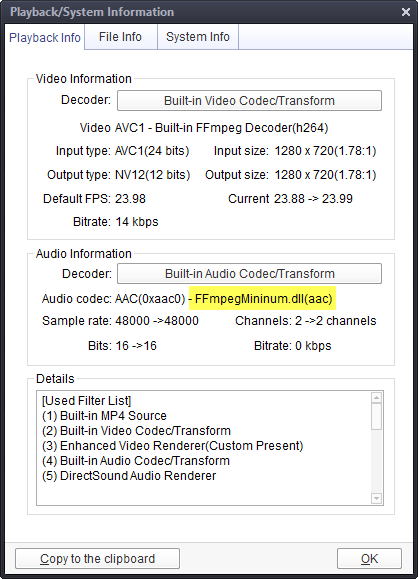

  13. i just wanna know if this change can effect the quality of the video file i play?
    Generally it won't...
    By the way, your installation procedure seems not complete.
    AAC decoder should be like the following screenshot.
    You need to install an additional decoder in the end of the installation procedure.
    If not, you'll have a trouble with some video.
  14. yeah, i forgot to do that . sorry .....
    thank you so much for your help bro .
