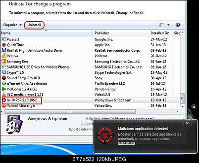

    I attempted to install an application but failed. Since then, my system got corrupted and started malfunctioning. I am neither able to run the applications which were already installed, nor to uninstall them. Clicked the shortcut and also tried to run from the program, but both failed. Tried to uninstall them thro system and also by using CCleaner but couldn't. Pop up message was flashed from antivirus which is attached. However, a few programs run by clicking the short cuts. Couldn't activate system restore also.
    Could anyone give me solutions / remedial measures.Click image for larger version

    Perhaps try an offline scan like Windows Defender offline.
    Download it from Microsoft, create the CD and boot from it.
    http://windows.microsoft.com/en-US/windows/what-is-windows-defender-offline

    a couple of things come to mind, first things first, i'm guessing your antivirus is blocking execution of those programs (as that pop up indicates), turn off the heuristic active scanning and try to launch/uninstall.install the programs you are having problems with. if it works, then perform the installs/uninstalls you want and run a complete virus scan.

    @deadrats - Actually, I disabled the antivirus function in my av program when I started to install the application, despite which the pop up flashed. Anyway, thanks for your help.
    Mar 2011
    India
    @davexnet - I scanned the system with Windows Defender offline as you said. It detected two Adware files and removed them.
    Now, everything works fine except Avidemux 2.6.1. The moment I open a file, it crashes. However, these adware were not detected by the paid software. Thanks a lot.
