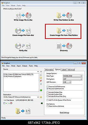

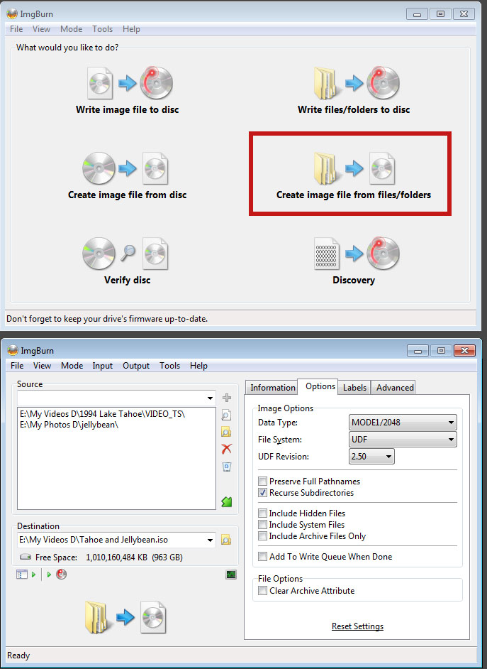

  18. If you're using imgburn and already have a video_ts folder, your next steps should look something like this to create the iso:
    Then use imgburn again to burn the iso to a disk.
