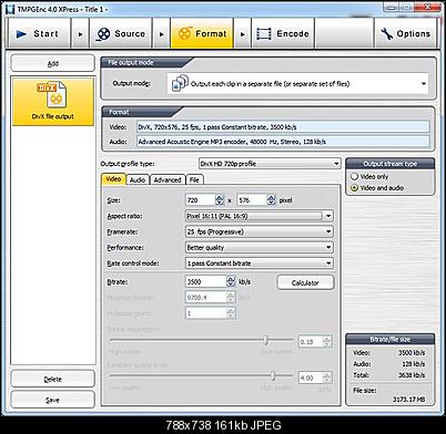

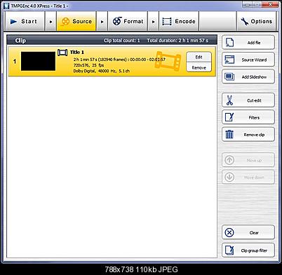

    First I select the main video file from the DVD, using the Source wizard.

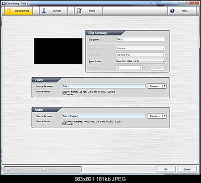

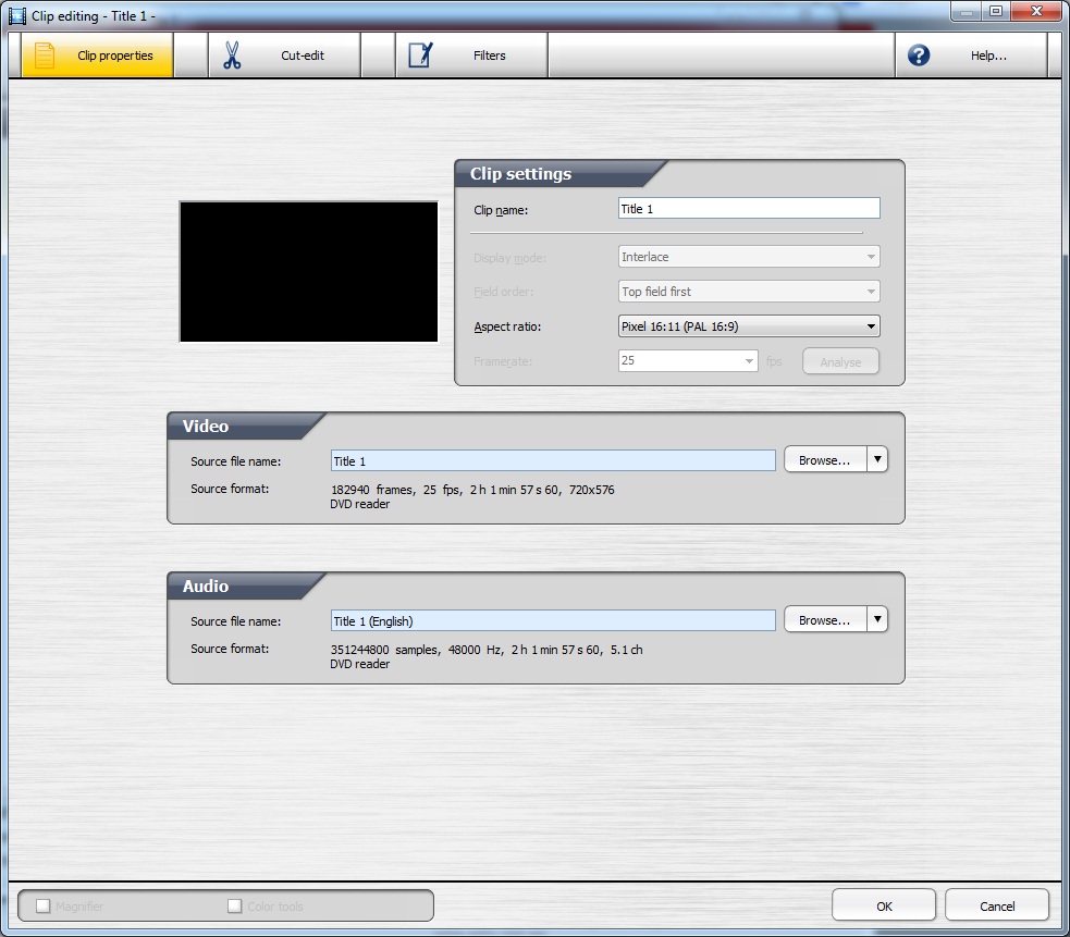

    I hit "edit"
Name:	clip properties.jpg
    Again 720x576pixels, aspect ratio PAL 16x9

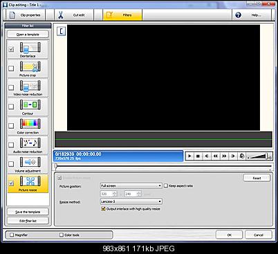

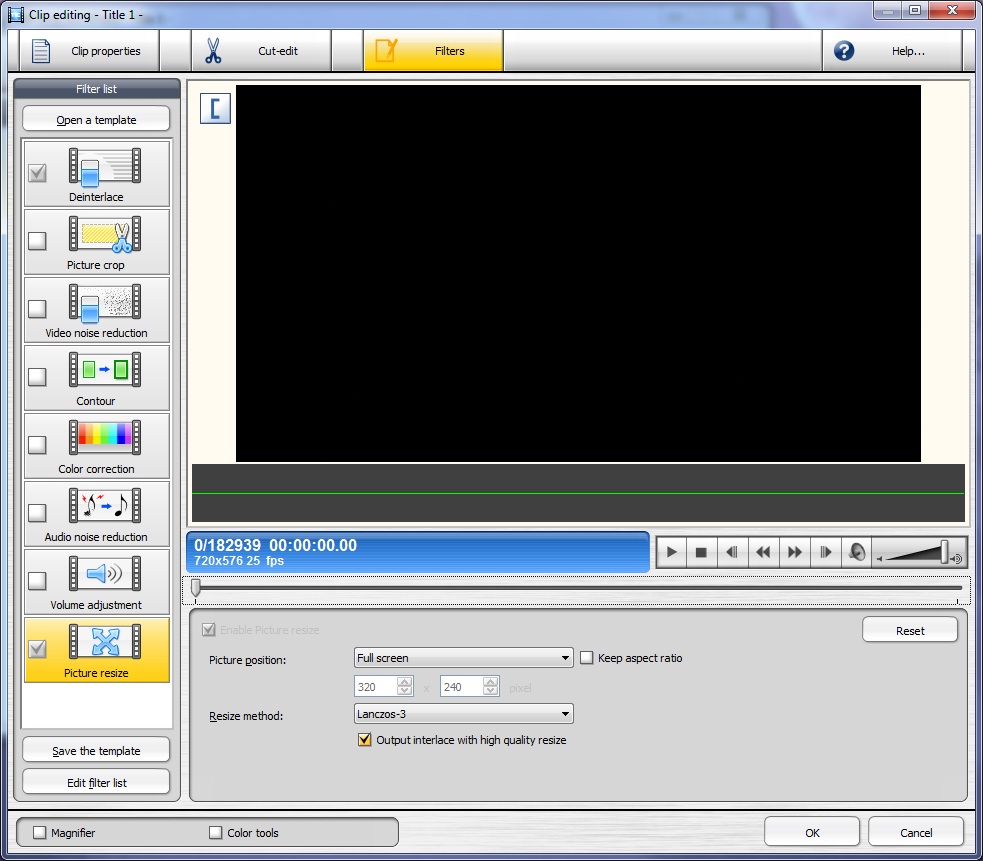

    I hit "filters"
    The filter "picture resize" is always on, I can't turn it of. Someone suggested to turn of the "keep aspect ratio" I tried it with this one on and off, both with the same result. I also tried changing "full screen" into "full screen (without border) with the same result.
    After this I hit "OK"

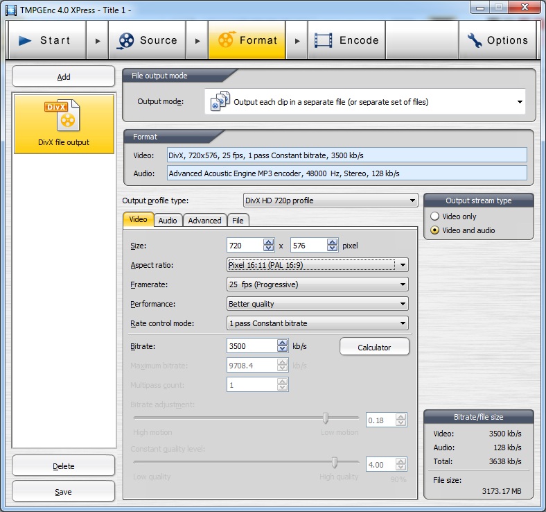

Name:	File Output.jpg
    As you can see, the divx should be 720x576 pixels, aspect ratio PAL16x9, just like the original DVD.

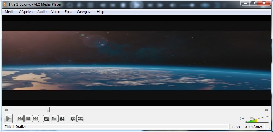

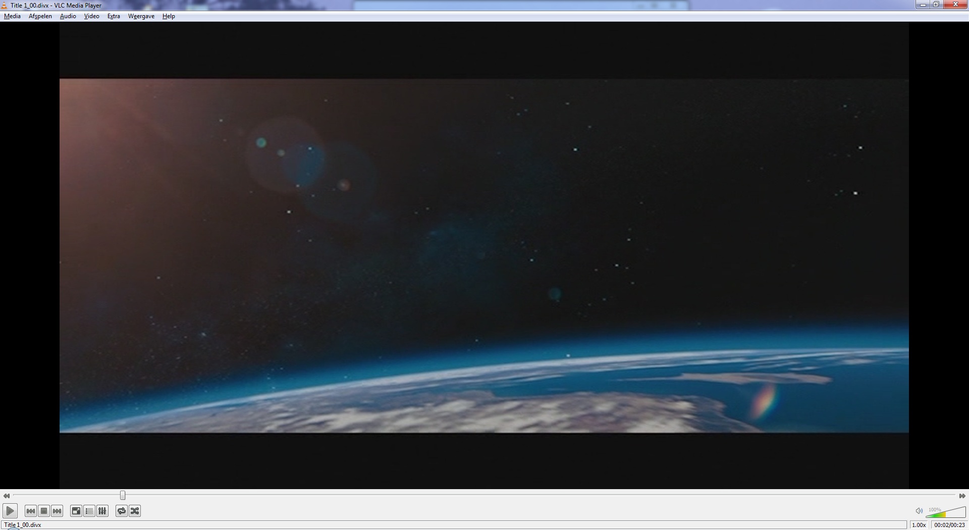

    And this is a screencap from the outputed file. It has a big annoying black border. When I try to play it on my TV the border is even bigger
    I'm at a loss, so I really hope someone can help me out.

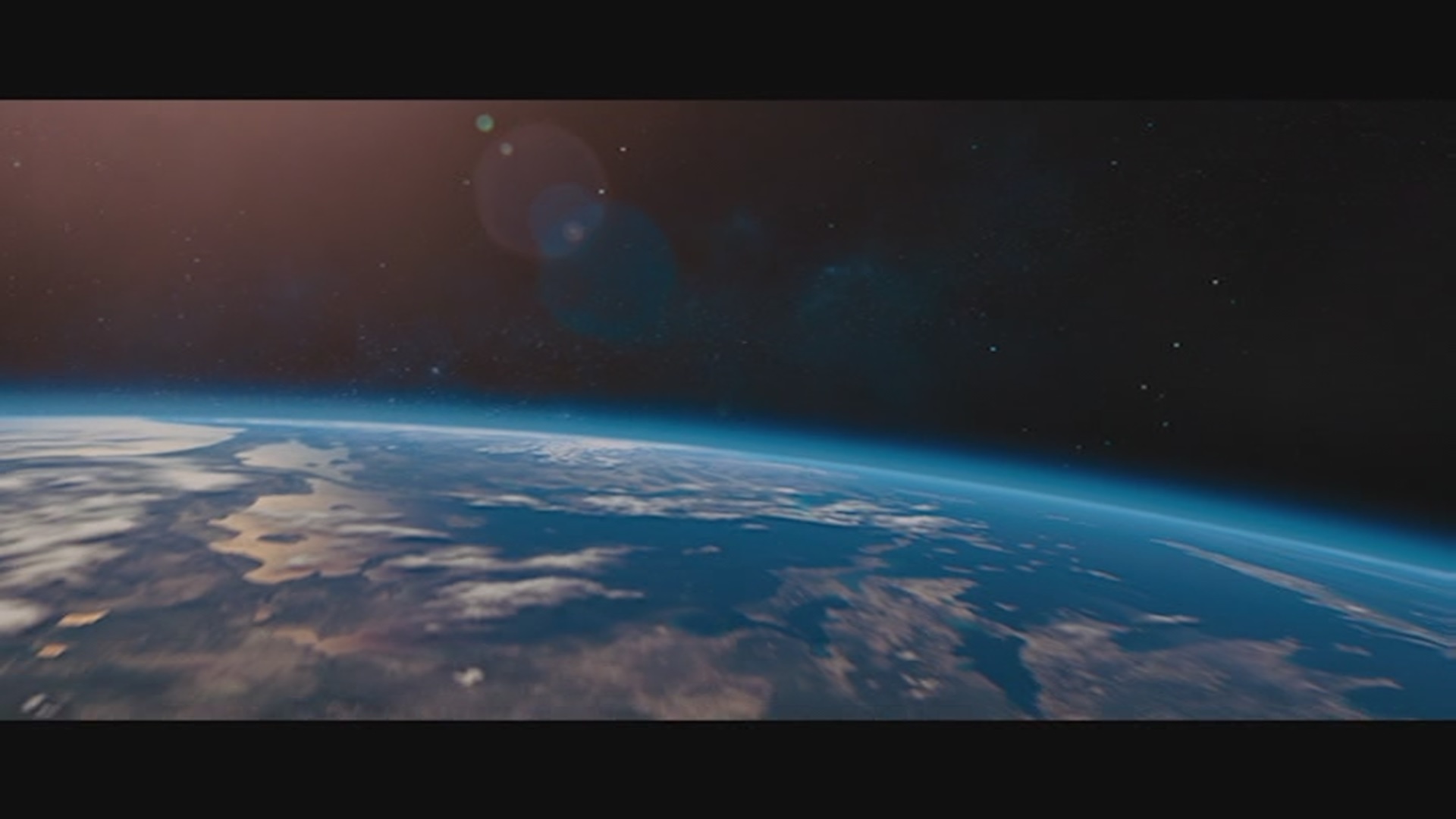

    It should have borders at top and bottom because it's wider than 16:9. Around 2.4:1 aspect ratio.
    If you zoom to full screen you shouldn't get any borders at left and right.

    720*576 is the Storage Aspect Ratio of the dvd - in fact EVERY PAL dvd - you do NOT want to re-encode to that.
    16:9 is the Display Aspect Ratio of the DVD - there are only two 4:3 and 16:9 - but most movies are not exactly this.
    You must re-encode to what the actual aspect ratio for the particular movie is - that info should be on the box - ie 2.35 to 1, 2.40 to 1 etc. So you get your calculator out and divide your desired width by the first number. Thus for 2.35 to 1 your encode would be, using 720 pixels width, 720 * 304 (306 rounded down to the nearest division of 4, you can also use divsions of 8 and 16).
    Whether that program allows you to do this I do not know. Most users here would use free software sunch as Handbrake or avidemux.

    Oh. And your target bit-rate is rediculously high.

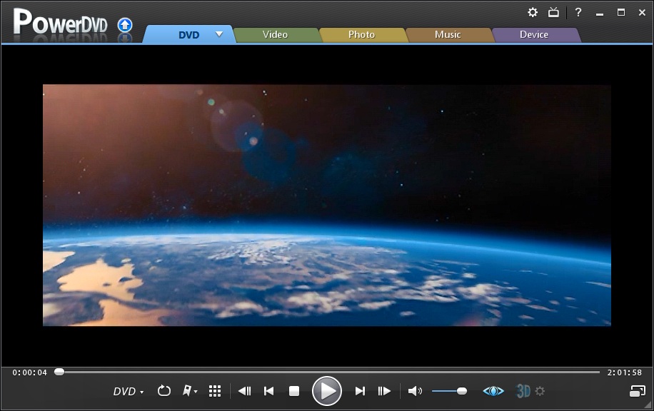

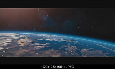

  5. @Baldrick: I know it should have border at the bottom and top, but there shouldn't be any at the left and right. I tried zooming, but then half of the subtitle is removed as well
    @DB83: at the backside of the box there is a white square with 2.35:1; I'm guessing this is what you meant?
    So I tried again with 720x306, tmpgenc changed this to 720x308. Guess this doesn't matter to much?
    Now it is all distorted, streched.
    The above one is the original DVD, the other one is what I end up with. Both shots are at the same moment in the movie.
    Any more help?

    Check the VLC player settings . These are clearly wrong

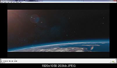

  13. Well, I tried playing the divx on my TV using my DVD-player. The image looked a bit streched, and there were two big black bars at the top and bottom. Each of these was nearly as big as the image itself.
    @DB83: of course I played the original DVD in VLC, using the settings you named earlier. These are also the default settings. To me everything looks fine this way. To make sure you agree I'll post a cap.

  18. Try this:
    Keep your original TMPGenc settings with the following changes:
    Under resize use full screen without borders
    Under format set your size to 1024x576, Aspect Ratio 1:1
    Try a small sample and see if that works.
  19. @smrpix: when I use a size of 1024x576, AR 1:1, I get a movie which plays just fine on my pc, without the borders. However for some reason my DVD-player can't play it. It just displays a message that the file is unplayable; it doesn't tell me what the problem.
    Using autoGK I get a file which plays fine on both the pc and the DVD-player, with just small borders at the top and bottom. So that would be fine. However the picture is all grainy; looks like the resolution is way down all of a sudden. I didn't make any changes to the resolution myself.
    Well, I just couldn't stand the fact that I didn't get the hang of tmpgenc; I mean, I'm a PhD so I should be able to do this....
    I took a better look at the file autoGK made. It has 720x304 pixels, which is as DB83 recommended in the first place. However when I tried DB83's advice the first time tmpgenc changed it to 720x308, which I accepted. So this time I reencoded the movie, this time with 720x304 pixels. Thus not accepting the change tmpgenc made.
    The result is a perfectly playable movie, a clear image, and no borders at the sides. So I guess we finally did it.
    Still I think it's uncanny how much effect such a small change is size (308 to 304) has on the endresult.
    @DB83: somewhere you told me the bitrate is way to high. A bitrate of 3000 is just the default setting of tmpgenc and on other boards I find the same number. Would you recommend a lower number? It would save a lot of extra diskspace.....
  20. Glad it worked out. 304 is divisible by 16, 308 is not. Seems to be a requirement of your player.
