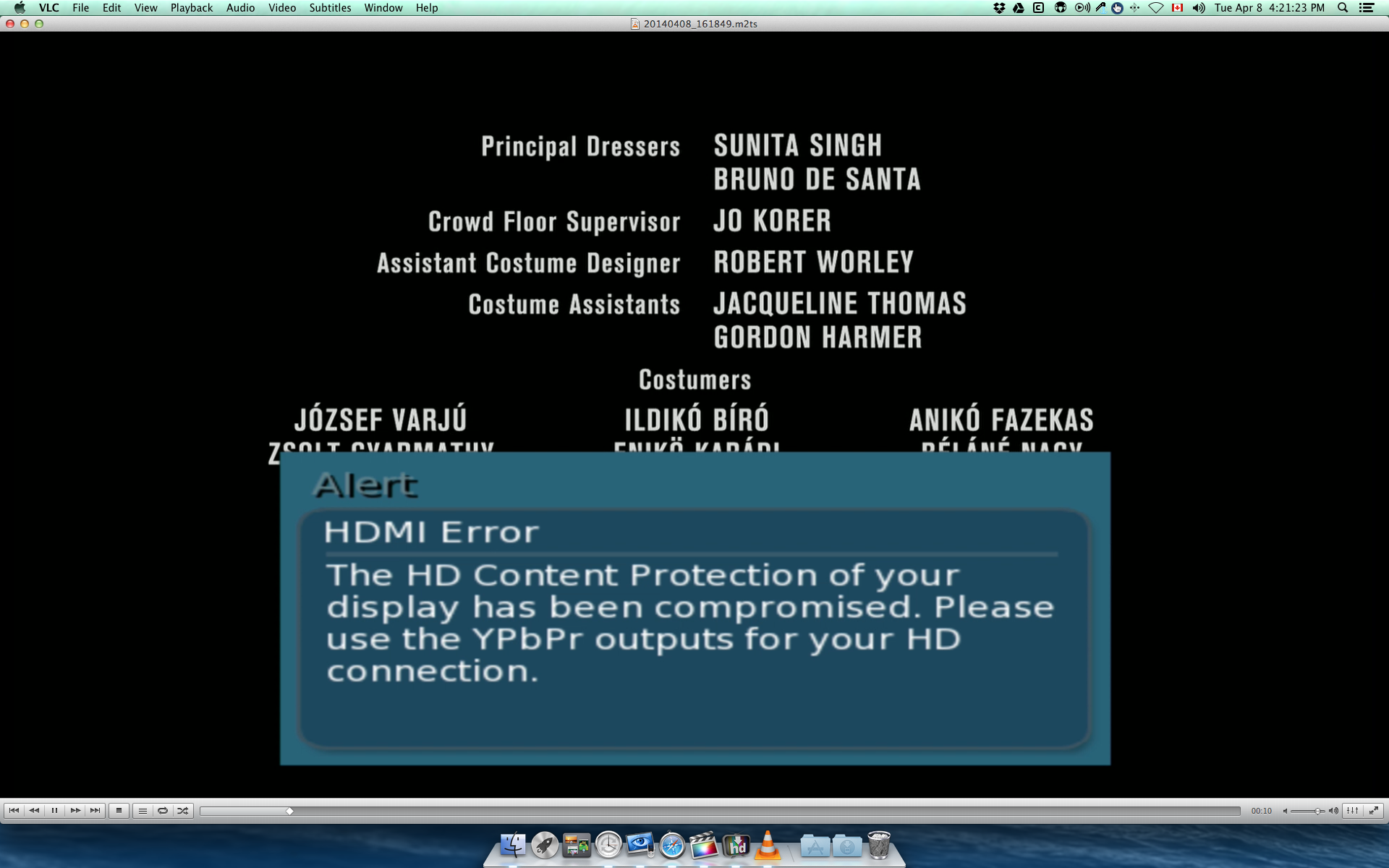

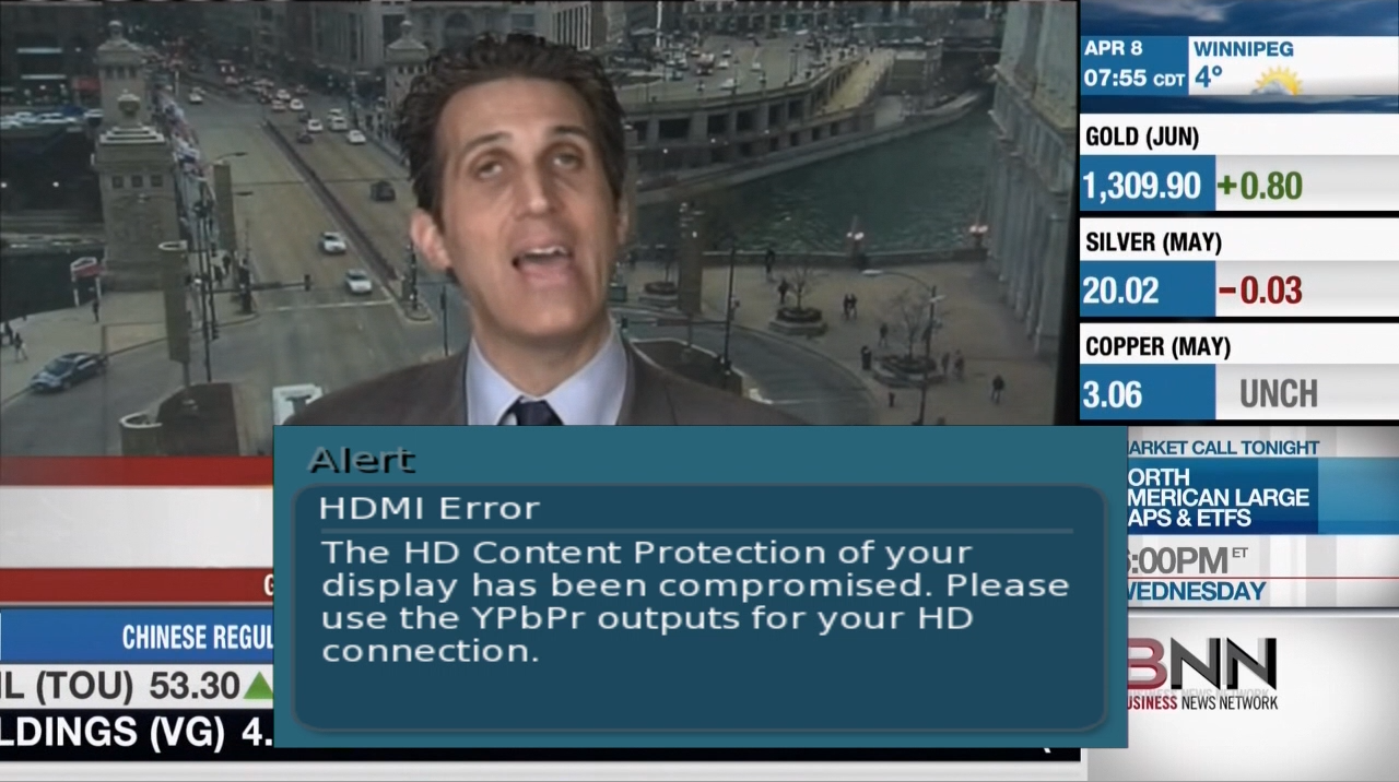

    Hi everyone,
    I need a bit of help and I wanted to know if you guys have any idea why this is happening:
    I recently purchased a HD PVR 2. I have 2 set top boxes with Shaw in Canada, one of which is 1080i and works fine. The newer Motorola DCX3510-M I have seems to have a problem when used with the HD PVR 2. When using HDMI cables in and out, sometimes the picture on the TV does not appear at all and when it does appear, it appears and disappears every few seconds. Running the latest HDPVRCapture 3.4.0 I can initiate a recording however same thing happens and it goes out and comes back on, but on my desktop it shows an error of "HD Content Proection of your display has been compromised, use the component cable ...". Which I tried but it doesn't give out a 1080p signal and instead it gives a 480i signal. Any help would be much appreciated. I tried the troubleshooting of the HD PVR 2 support page which states, I should change the resolution on the set top box. That didn't help either as you can see in the second picture I have posted. The thing is I am under the impression that there is some sort of restriction Shaw has put so it can not be used this way. I can not even access the advanced settings by turning the motorola set top box off and press the menu button. It only gives me the option to change resolution from the front panel display of the motorola and nothing appears on the TV.
    Thanks,

  10. Most set top cable boxes require HDCP. You'll need an HDCP stripper. See this thread for some examples:
    https://forum.videohelp.com/threads/334145-HDCP-strippers

    Thanks a lot, I just purchased a 4k hdmi1.4 splitter which I think should do the job as I understand from the posts from others.
  12. Carefule, not all HDMI splitters remove HDCP. Only a few.

    I did realise that only some would do that. I found a few on eBay and they hint at HDCP compliance. How can one make sure they are actually removers too?
    Here's a link to what I found.
    http://www.ebay.com/itm/261285978120?redirect=mobile

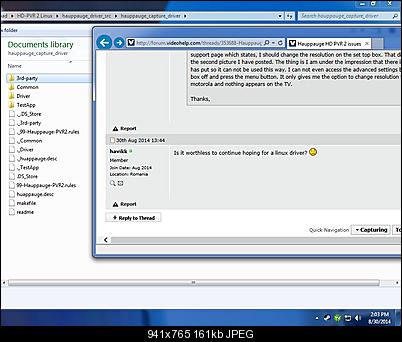

    Is it worthless to continue hoping for a linux driver?
    Yes there hope see sneak peak screen below and for Colossus/Colossus 2 as well but there not ready as for win that I don't know
