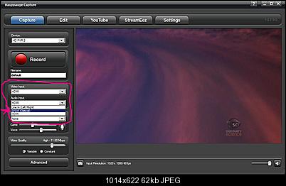

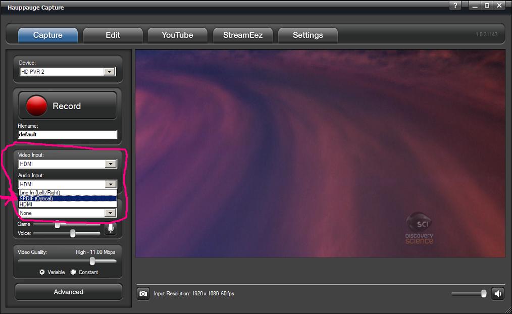

    I don't use it but does this apply?
    There's not much to do but then I can't do much anyway.

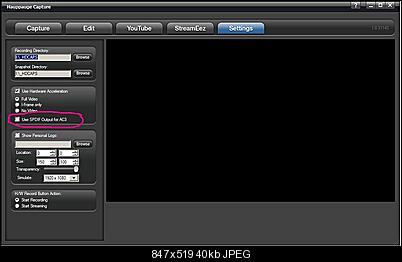

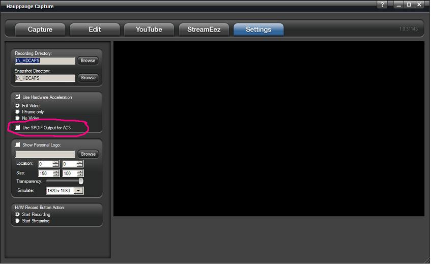

    What about this does it not work?
    Maybe you've seen this thread on the AVS forum... http://www.avsforum.com/t/1460986/hd-pvr-2-1512-owners-thread especially post #3 and #14 where 2 users said earlier driver versions had a bug which showed spdif input as a second hdmi. (Not sure if it applies to all PVR2 models)

    I told you that Tool doesn't work with AC3 only Showbiz works with AC3 recording
    spdif input if self does work
    That bug is in Showbiz

    Got Showbiz installed. Unchecked disable AC-3 for HDMI in both Showbiz and Hauppage Capture. Test captures from both using different sources still shows all caps being in AAC 2 channel stereo. Only thing I can think of at this point is to uninstall the older TME software which may somehow (though I don't see how) interfere with capping with the new software even when it's not active. Drivers or ?? Maybe...
    Got SPDIF audio as an input working now. It's at a setting I don't even have 384 Kbps. The default setting is 192 Kbps. Still recording in AAC though according to media info and VLC.
