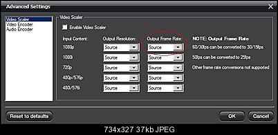

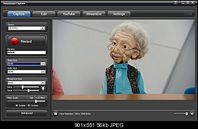

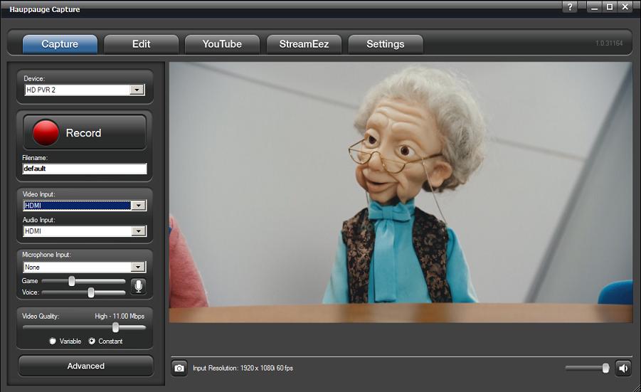

    Did you guys notice the new capture app on the Hauppauge site. Based on the posted file date it's been out since May 24 2013. There is a full download which contains all the usual apps and another for just the capture app and the beta drivers.
    Hauppauge Capture and Beta driver:
    http://www.hauppauge.com/capture/
    HD PVR 2 Installation CD
    Windows Driver, Showbiz and Hauppauge Capture applications with StreamEez and Personal Logos
    http://www.hauppauge.com/site/support/support_hdpvr2.html (click on the beta tab)
    You can now disable video preview completely or just view I frames but the setting applies during normal pre-capture preview and not just during capture. You can also do voice over mic capture. It kind of puts everything under one roof.

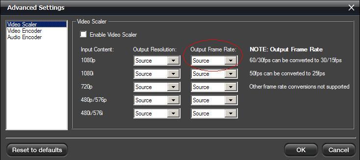

    I had hoped it would do 1080p 60fps based on the red circled in the pic below but I did a quick test and the file came out at 29.97fps. (the pic above is a 1080i tv source and not used for the 1080p 60fps test)

  11. Yes, I saw that app when I was playing with an HD PVR 2. And you are correct, it can't capture 1080p60 as 1080p60, it captures it as 1080p30. And although it can downscale 1080p to 720p, it does so after decimating. So you can't get 720p60 recordings from a 1080p60 input. That's what I was hoping for. Hauppuage support even told me it could do that before I got the device. But after I got it they admitted it couldn't.

    Yes, I have tried the new Capture App, it works OK, needs some tweaking to get it right. I think it doesn't show the status of the audio (2.0 or 5.1) while it's active.

    ..And although it can downscale 1080p to 720p, it does so after decimating.
    but 1080p should be the same as 720p, telecine wise. just different "width" resolution. and the downscale should only be the change in pixel width dimension. the exception would be as you noted, that it decimates 1080p down to 1080i, or, given the original (frame-based @ 60fps) the 3:2 telecine cadense pattern PDPDDPDPDD for 720p (and 1080p) would change (or, downconvert) to the (field-based @ 30fps) 3:2 telecine cadense pattern PPPii for the 1080i source.
    ..And you are correct, it can't capture 1080p60 as 1080p60, it captures it as 1080p30. And although it can downscale 1080p to 720p, it does so after decimating. So you can't get 720p60 recordings from a 1080p60 input. That's what I was hoping for. Hauppuage support even told me it could do that before I got the device. But after I got it they admitted it couldn't.
    i'm leaning toward the conclusion that the hdpvr is just a (for lack of better term) transparent capturer. that is, it captures *only* the source resolution, thus, 1080 / 1080, 720/720, and 480/480, and the "upgrades" in features are all real-time sofware conversions, because the data rate is so low or low enough for these types of features to be done in real-time during live capturing, like the one everyone seems to be looking for in this topic, conversion without decimation, or worse, distortion/artifacts.
    i don't know of anything, content-wise, that is broadcasted or bluray public releasable that is 1080p. i always assumed the content was 1080i and the usual 3:2 telecine cadense of PPPii. i would assume 1080p is the same as 720p, only the pixel demension difference. the telecine (for 1080p) would still be the same as it is for the 720p sources. but, assuming there is 1080p public releaseble blurays, then i would guess it does in fact contain the 3:2 telecine cadense pattern PDPDDPDPDD, progressively, just as the 720p does.
  20. Originally Posted by vhelp View Post
    The problem is that the 1080p60 source is decimated to 1080p30 or 720p30 by discarding every other frame. That leaves film based material with a duplicate frame every 5th frame. It wouldn't mind if it simply resized 1080p60 to 720p60. I would accept the loss of resolution in my recordings. But I find the jerky p30 decimation unwatchable, much worse than the judder or 3:2 pulldown of 30i, or 3:2 frame repeats of 60p. Sample (from the HD PVR 2, trimmed and remuxed with AviDemux) attached.
    i'm leaning toward the conclusion that the hdpvr is just a (for lack of better term) transparent capturer. that is, it captures *only* the source resolution, thus, 1080 / 1080, 720/720, and 480/480, and the "upgrades" in features are all real-time software conversions
    No, the scaling is done on the device before it's sent to the computer via USB.
    But many devices output 1080p60, even if the source is something else. Games can be rendered 1080p60. I don't want to change my HTPC to output 1080i30 or 720p60.

    Originally Posted by SHS View Post
    If you using USB 3.0 port you may run in to some problem you try out this set of driver here ftp://ftp.hauppauge.com/Support/HDPVR2/HDPVR2_Driver_1_4_31143.exe
    Note for the late Hauppauge Capture Tool keep eye on there face book page and I should point out that it dosen't support AC3 you have use Showbiz or WinTV 7
    Any here a tip for all if your doing any PC Gaming Recording
    http://www.shspvr.com/howto/spdif-optical/spdif.html
    I can't speak for component input but I was only getting aac audio at first with the capture program over HDMI when I only installed that new driver with the capture app. It was ignoring my settings. I had to install the full bundle containing Showbiz, WinTV7 etc... on the "Beta" page I referenced in my earlier post (#70) which includes the 1.4.31143 driver as above (you have to open the beta tab in the link I provided to see it). After that under "Advanced" and "Audio Encoder" uncheck "disable HDMI ac3 support" in the capture app. Then close it and open Showbiz and make sure it is unchecked there too. Then reopen the capture app and now it should cap ac3 over hdmi. I unplugged the pvr2 after doing this and rebooted the PC and it works.
    What's missing in the capture app is the feature to stop the cap after a set time like there is in Showbiz.
