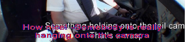

    My original video file is in .mkv format: if I run the original in GOM PLayer and choose to show the subtitles there, they are positioned perfectly. If I do exactly the same thing with the DVD files produced by AVStoDVD, then they are misplaced: the screenshot shows what I mean.

    The result when I then burn the modified VOBs to a DVD: disappointment. There has been no change at all, the subtitles are just where they were originally. I attach a screenshot of the lower part of the screen, to show the original (white) and modified (pink) positions as shown in DVDSubEdit..
    Am I doing something wrong? I guess (literally) the problem arises because my mkv file is 1280x720 resolution and AVStoDVD creates VOBs which are 720x576? I can't believe that this problem is not fixable, even so...

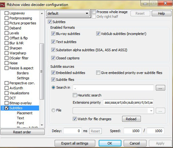

    1. You need to go into ffdshow video decoder configuration (or the DXVA decoder if ffdshow is set to use that). Do the following for both if you are not sure which is being used. Scroll down the left-hand pane until you find 'Subtitles' and remove the tick in the box. See screenshot.
    2. Now use AVStoDVD to create your VOB files from source avi/wmv/mp4 etc., as usual. Don't include any subtitle files, if present.
    3. Join all the VOB files which start with 'VTS_0' just created into one large file. There are a number of freeware programmes to do this (eg. FreeVideoJoiner, or Freemake Video Converter). Don't include any of the .BUP, .IFO files or VOB files which start with the word 'Video_TS'. This helps to ensure that the subtitles match the video playback in the final DVD.
    4. When that's complete and you have one large VOB file, go back to ffdshow and re-check the box for subtitles.
    5. Start a new AVStoDVD session, using the one large VOB file just created in 4 and also include your subtitle file (srt or whatever) of course.
    You should now have a new set of VOB files in which the subtitles are present and correctly placed. Well, it worked for me anyway. Good luck.
    Martin
