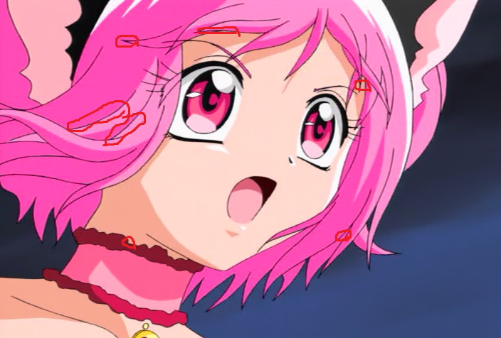

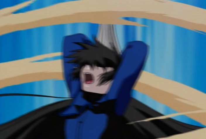

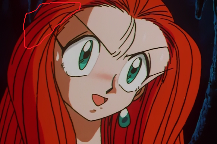

  1. I keep seeing these weird lines that I can't seem to remove. How Do I get rid of them? I tried DAA3 already.

  2. Please don't post bitmaps, use something like PNG instead (lossless compression) , or if you use BMP, at least zip them up
    How was this processed ? Maybe something you did caused it ? More information on the source and what was done with it. You should provide original source samples
    For the 1st & 2nd, if you mean the horizontal lines you can basically get rid of it with vinverse()
    The 3rd one might not really there, it might be the method of taking screenshots (poor chroma upsampling) - another reason to provide a source sample . How did you take the screenshots? What software ?
    It would be better to figure out why they are there and avoid the problem in the first place. If possible.
    Yes. An un-recompressed sample of the source will help with both problems.
  4. I don't have the original source for the first 2 shots. The third shot I will post.
  5. Original DVD shot.

  8. I don't know why you think the less information you give us the better help you'll get. You've already been asked for a sample of the source, not a screenshot. What are you doing after the script? Encoding with something? Where did the screenshots come from? The script loaded into VirtualDub? After encoding with some codec? A media player?
    I suspect DAA3() is the source of the problem -- it's creating jaggy edges, exacerbating something later, during encoding. But since we don't know what you're doing that's just a guess. Going through an YV12 to RGB to YV12 cycle is also causing a little blur in the colors.

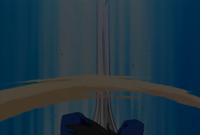

  11. As you can see, there are many small, but irritating things in this footage. I see a weird, blue, tint and vertical lines. I cleaned up some of the grain with dfftest(sigma=20). However, I am scared that I might be over blurring, or washing-out the footage.
  12. I also, detect some color banding on the moving pillars in the second sample. I need to convert back the original aspect ratio of 720x480 4:3 as well.
    Here is a sample:

  16. The samples I uploaded are untouched. In other words, absolutely no filtering has been done on them. They are the original source I am trying to fix. If you look closely you can see some grain in places with lots of motion. those weird lines are definitely there. Look at the fade in at the beginning of the first sample, that's where you can see it the most. Sorry for posting this sample as an uncompressed bitmap, it is the same screenshot from the first post.

    The effect you mention isn't grain. It's motion smear, and is common with lossy compression. You can strongly filter those scenes with NeatVideo, especially its mid- and low-frequency settings with high-frequency filtering turned down somewhat (some would say to use MCTemporalDenoise. Never worked for me with that kind of noise). You will need to increase the encoding bitrate for those scenes. High detail and motion require higher bitrates than scenes with less detail or less movement.

  20. I'm not sure what you're referring to in the last screenshot, but if you meant the obscured lines in the pink hair - that's from oversaturation causing the colors to bleed over the lines in some areas. It's a stylistic choice, but many scenes are not broadcast "legal". I would consider adjusting the saturation before looking at some line darkeners or use some combination
