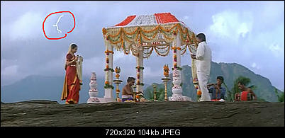

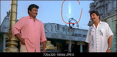

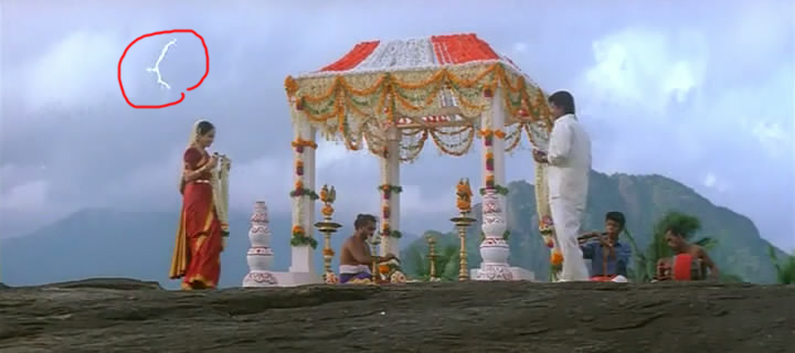

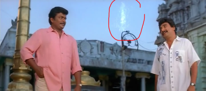

    Hello videohelp members i'm new here.
    how to remove scratches and white color lines and spots in video
    here is the screenshot example.

    already tested with some of the avisynth filter plugins and scripts like descratch,deflicker,RemoveDirt,RemoveDirtMC...
    please help me to clear all those demages in video..
    here is the script i mostly used.. achieved good denoised result..
    DGDecode_mpeg2source("filepath/filename.d2v", info=3)
    ConvertToYV12()
    ColorMatrix(hints=true, interlaced=true, threads=0)
    #deinterlacing
    #croping
    #resizing Lanczos4Resize() or Spline36Resize()
    super = MSuper()
    backward_vectors = MAnalyse(super, isb = true)
    forward_vectors = MAnalyse(super, isb = false)
    forward_compensation = MFlow(super, forward_vectors, thSCD1=500) # or use MCompensate
    backward_compensation = MFlow(super, backward_vectors, thSCD1=500)
    interleave(forward_compensation, last, backward_compensation)
    Checkmate()
    VagueDenoiser(threshold=1.2, method=1, nsteps=6, chromaT=0.8)
    selectevery(3,1)
    LSFMod(Strength=80, Smode=5)
    Undot()
    GradFunkMirror()
    #Grainfactory3(1,1,1)
    YlevelsS(0,1.0,255,0,255,false)
