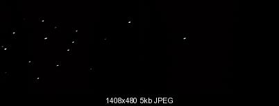

    RemoveSpots() is often problematic with cartoons because of the large motions between frames and stuff that appears only in one frame. There's clear blue sky behind the missing segment in both the preceding and succeeding frames. So RemoveSpots() thought it was a spot. I once had the same issue in a cartoon with a scrolling star field. Most of the stars disappeared after RemoveSpots(). I still have that clip around! Before RemoveSpots() on the left, after on the right:
    The stars were moving to the left and down with each frame.
    This is much less of a problem with non-animated video since it usually has more detail and doesn't have large motions like that.

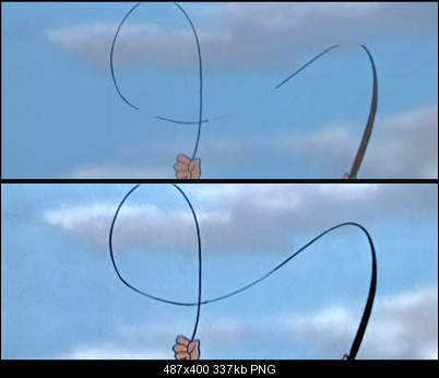

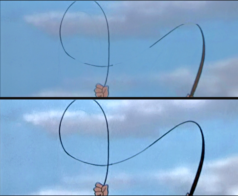

    Right, poisondeathray, I've seen the effect with RemoveSpots a number of times and had to use other means in drastic cases. Out of curisoity (again, since I don't know what the heck I'm doing), I tried an experiment with mt_adddiff() in MaskTools2.
    In the image below, a section of frame 744. The top image used RemoveSpots(). The bottom image used this code:
    rs=mt_adddiff(last,last.RemoveSpots())
    In the bottom image it almost looks as if the broken line was restored. But in fact the "break" is filled with a less-black line. And of course the colors are the added difference between the original and the new frame: brights are brighter, darks are darker. Oh, well....I'll understand masktools one of these days.
    As it happens, this frame didn't have any unwanted dots.

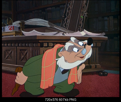

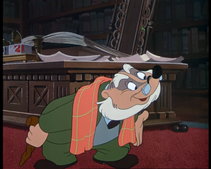

    Now, I have tried to fix the film with some avisynth filters.
    Picture from the source on top, and from the filtered film on the bottom:
ID:	16531Click image for larger version
    There are 2 things that I find strange. For the first that the picture from the source is frame 570, while the second picture is frame 572. It's the same clip, the second picture is just from the film loaded with an .avs script.
    And for the second, the colour is changed in example nr. 2. Is it Mpeg2Source() which causes the change in colour? The carpet is more red in pic 2. I know it isn't any of the other avisynth plugins, because the change in colour is present even if I remove all the other plugins.
    I've used CPU=6 in Mpeg2Source
    UnDot()
    Deblock(quant=30) and
    TTempSmooth()
    and I think the result is quite good. The carpet isn't loosing too much details either.

    Found the culprit: RemoveSpots(). First time I've ever seen that happen.
    Wow, you must be joking or sarcastic ??
    All the dirt/spot removal filters will do that (remove wanted objects) even with the strength turned way down
    They are best used with compositing layers, and masks, never alone
    No, I've seen RemoveSpots and even RemoveDirt make some tiny things disappear, but not as obvious as here. Then again, it makes sense: if the filter thought that piece of rope was a no-no, it replaced it with a section of cloud or sky from another frame. Hate it when that happens, 'cause then I have to write code, map out pixels, etc. In the long run, RemoveSpots is a great time saver, but no plugin is perfect. The perfect "Read My Mind" filter or app hasn't been written yet.
  7. Originally Posted by brusno View Post
    Didn't we discuss this ealier?
    https://forum.videohelp.com/threads/353657-Noise-in-picture?p=2222744&viewfull=1#post2222744
    This is a rec.601 vs rec.709 issue. If you add ColorMatrix(mode="Rec.709->Rec.601") to your AVS script the colors will be the same. The question is which is right. How did you make the two images?
    https://forum.videohelp.com/threads/329866-incorrect-collor-display-in-video-playback?p...=1#post2045830

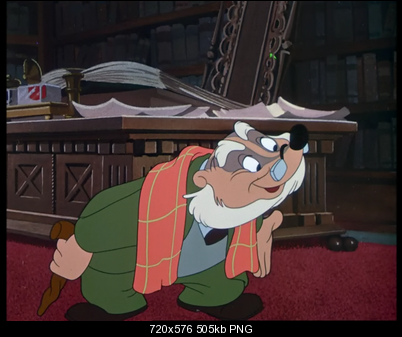

    Wow! The ColorMatrix code worked! The colors are similar to source
    Is it only necessary when showing the filter-results in mpg2, or must it be used when converting to .mp4 also?
  10. Originally Posted by brusno View Post
    The colors were probably correct before ColorMatrix. Ie, I suspect the original screen shot you posted had the wrong colors. What did DgIndex say about the colorimetry?
    Feb 2013
    Norway

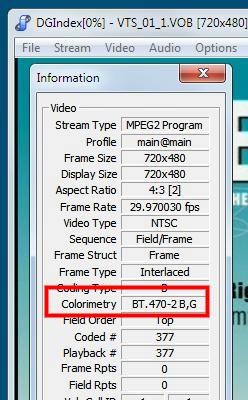

    ah...you mean that the colors are being showed wrong in DGIndex when opening a VOB file?
    I'm not sure what you are referring to with colorimetri. Nothing showed in DGIndex about that. But under video meny; YUV -> RGB; PC scale.
  12. Originally Posted by brusno View Post
    I don't know how how you made your PNG images so I can't speculate on what's right and what's wrong. DVD sources are normally rec.601. VirtualDub and VirtualDubMod use rec.601 whenever they converts YUV to RGB.
    When you save the index or preview the video:
    BT.470-2 B,G is the same as rec.601 for our purposes here.
    Feb 2013
    Norway
    Yes, that is what mine is showing too; BT.470 - 2 B,G*
    So that means that the DVD is rec.601
    I used "snapshots source frame" (shift-1). In VirtualDubMod.
    Feb 2013
    Norway
    It is VirtualDubMod which shows the colors wrong here. (Scarf orange).
    DGIndex and VLC are both showing what you mean are the right colors (the darker tone).
    But when opening the .avs script file in VirtualDubMod, then it shows the right colors. That would be the .avs file without the colormatrix code.
  15. Originally Posted by brusno View Post
    The asterisk means the colorimetry isn't specified in the video stream. Notice that jagabo's picture didn't have the asterisk. And if it isn't specified it's almost certainly Rec.601. DVDs are supposed to be Rec.601.
    What's that mean? That you first opened the VOB directly in VDubMod and got wrong colors, and then later opened the AVS and got the right colors?
  16. As far as I know, VirtualDub and VirtualDubMod always convert YUV to RGB using the rec.601 matrix. In AviSynth you can specify which matrix you want with ConvertToRGB(matrix="rec601") or ConvertToRGB(matrix="rec709"). If you don't specify which you want you will get rec.601. If the source specifies the colorimetry you should follow it. If the colorimetry isn't specified and you're not sure which to use the general rule is to use rec.601 for standard definition, rec.709 for high definition.
    Feb 2013
    Norway
    Yes, the vob and the .m2v file got the wrong color in VDubMod. While opening the vob and the .m2v in DGIndex showed the right color.
    So it seems that it isn't the film which have any wrong color. It's just how VDubMod shows it.
    When I use ConvertToRGB(matrix="rec601"), I get right colors in VDubMod. This indicates that rec601 is what the DVD is. And when I use ConvertToRGB(matrix="rec709"), I get the wrong colors in VDubMod.
    But when I don't use anything it seems that VDubMod is choosing rec709 by default.
    But this is not a big problem, just a strange observation.
    What is more important, is to get the right filters to get rid of unwanted artifacts in the film.
    Also I'm wondering if anyone knows of a program that can show mp4 frame by frame, the same way that VDubMod does with mpg2.

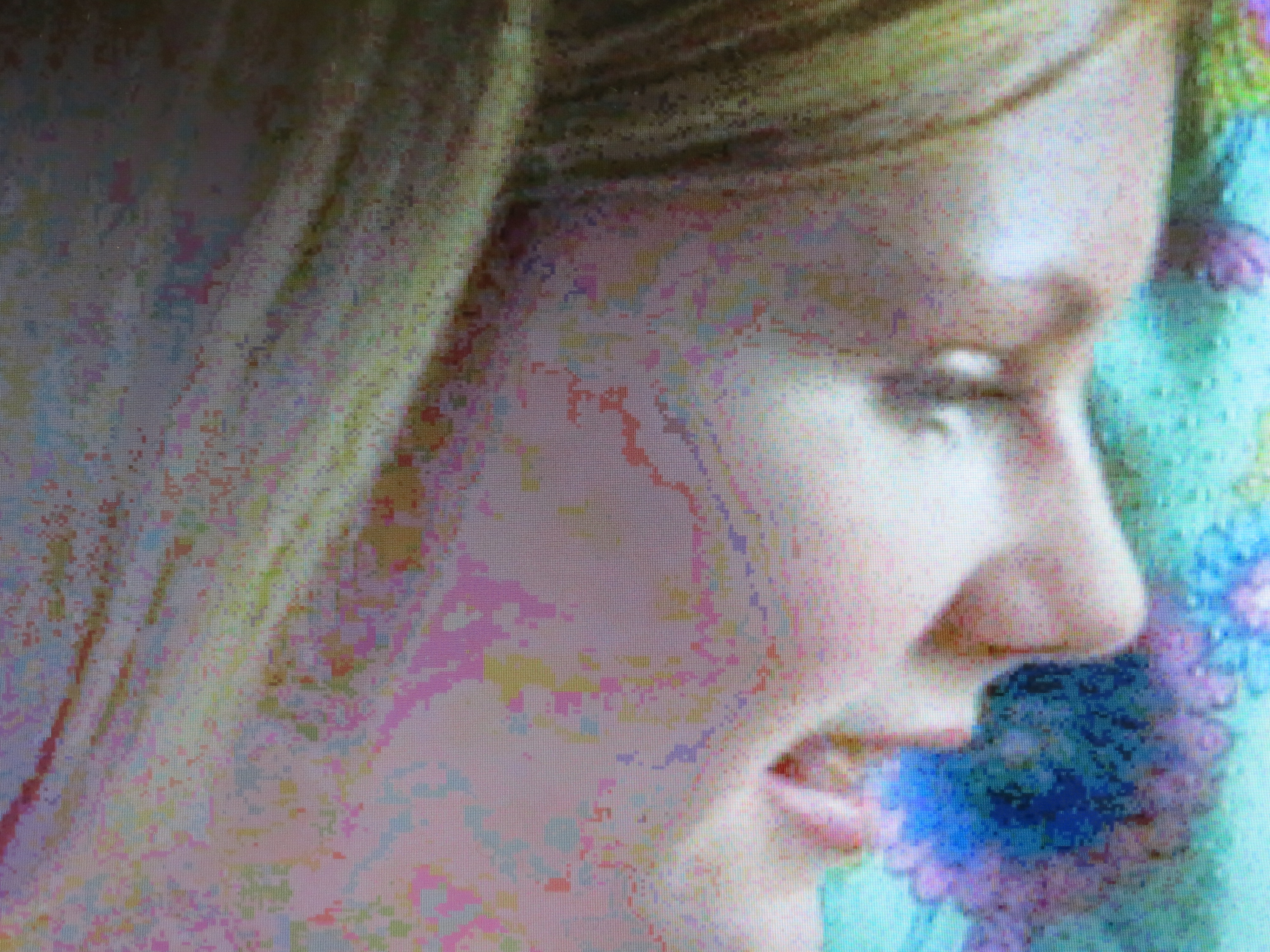

    hello everyone, i have a similar noise / artifact issue but it is only on video or pictures on line, dvd i play are perfectly good!!!???!!
    this is something new, since i changed my modem
    comcast said they needed to update system and required a dociss3 modemImage
    [Attachment 17029 - Click to enlarge]
    [Attachment 17030 - Click to enlarge]
    [Attachment 17031 - Click to enlarge]

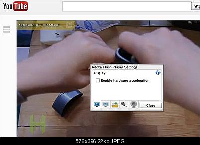

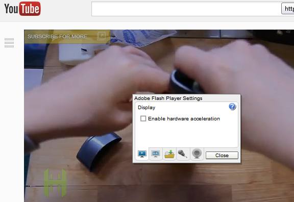

  22. I doubt the modem has anything to do with your problem. Right click on a video while it's playing and select Settings. Change the state of the Enable Hardware Acceleration option.
    Exit and restart the browser.
    Also, update to the latest WHQL certified driver for your graphics card. And the latest Flash player.
