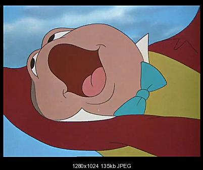

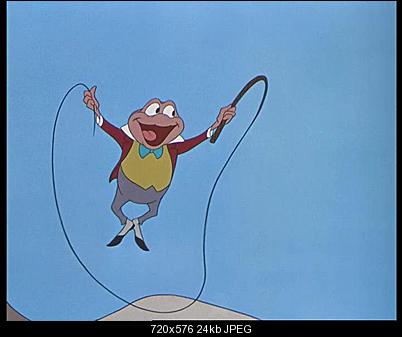

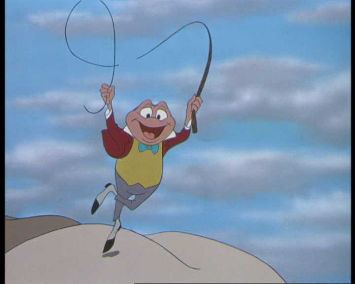

    What is this kind of noise called? And can it be removed by any avisynth filter?
    Or is it just artifacts because of the quality?
    I'm referring to what is in the drawing borders, ie. round the scarlett ribbon, mouth and so on.

    I believe it's mostly block noise due to low bit rate.
    Perhaps a de-blocking filter?
  3. Yes, these are due to low bitrate encoding. DCT ringing and block noise, some chroma noise
    Yes you can improve it with various avisynth filters such as line thinners, antialiasing, denoisers -- BUT -- you should to post an original sample , not a jpeg image (jpeg is lossy, you don't know which are jpeg artifacts vs. original artifacts), and not a resized image (resizing can change the spatial relationships of the artifacts)

    Difficult to say, really. The image is lossy JPG, which adds its own artifacts to images. Which of the problems (macroblocks, mottling, mosquito noise around fading and uneven-density lines) do you think belong to your original video, and which belong to jpg compression? Block noise is in the flat red areas. The image size has us guessing (1280x1024 is .8:1 image ratio, but isn't a stanadrd BD or DVD image size, so one would guess that resizing might have occurred. But that's just guessing. The video's original source is unknown.
    One thing the O.P. apparently doesn't realize is temporal noise changes from frame to frame. But I'd venture to say that if any three frames from the video were posted, the noise would look different in each image.

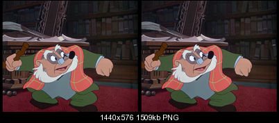

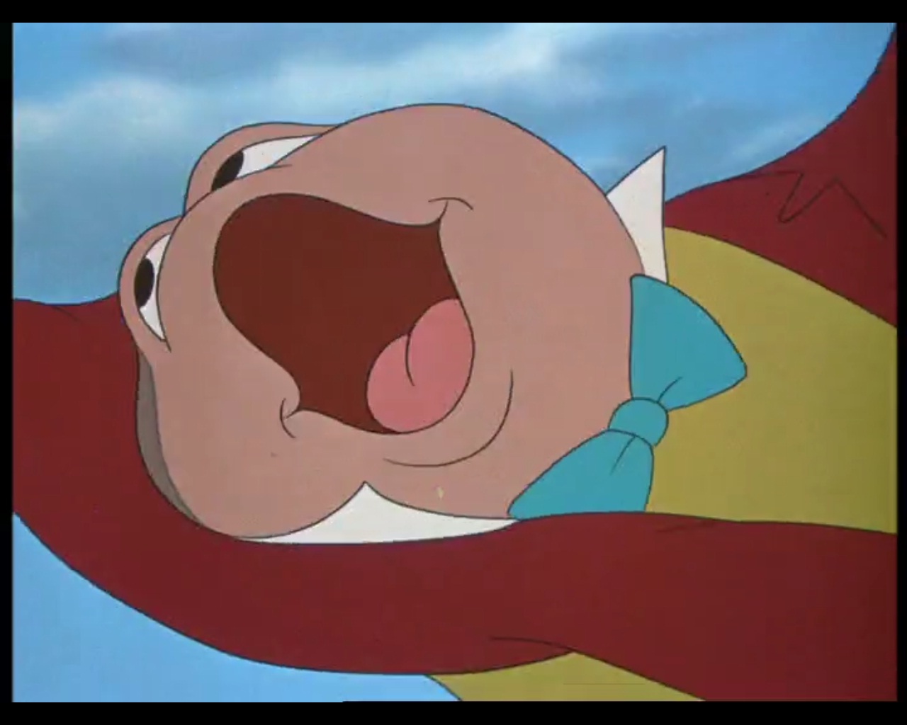

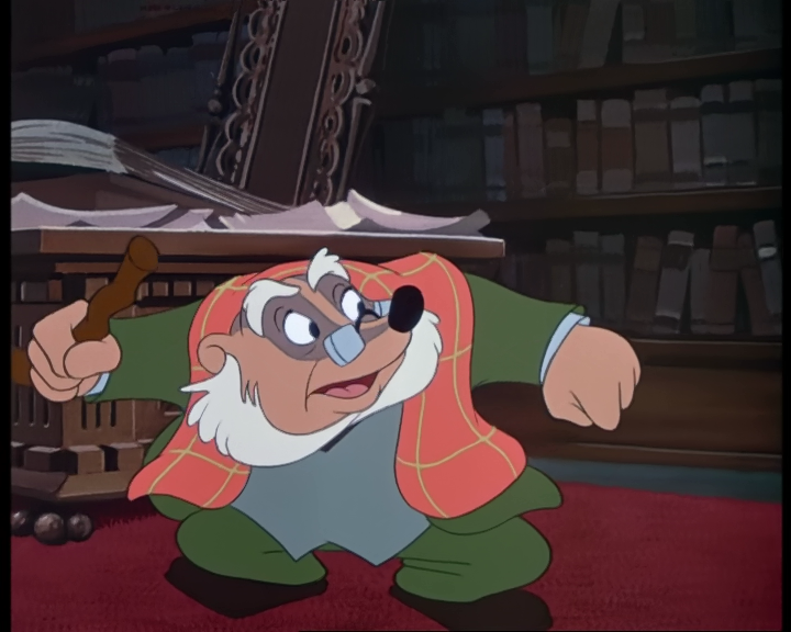

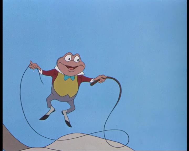

    Here's the mpeg sample opened with Mpeg2Source() with CPU=0 and CPU=6 (no deblocking or deringing, full deblocking and deringing):

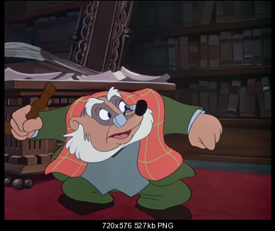

    Adding UnDot() and MCTemporalDenoise(settings="high") gets rid of most of the rest:
    Unfortunately, MCTD at high settings like that also removes some detail and smears some motions in low contrast areas (note the red carpet). That's frame 69 in the sample video.

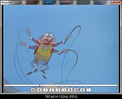

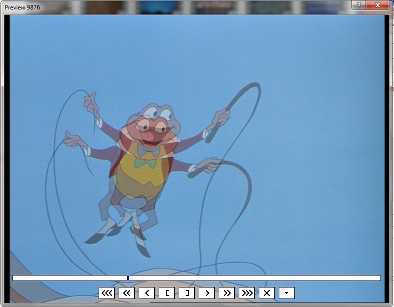

    When looking at the source (DVDShrink ripped) in the "Preview" (stillpictures) window in Staxrip it is been shown as interlaced. You can see the stripes very clearly. But in the "preview" in Handbrake (film) it doesn't show at all.
    Stillpicture from Staxrip-preview:

    When we say "source" video, we don't mean video that has been deinterlaced, deblocked, denoised, etc., etc. Source means "source".
    As it is, your processed MPEG didn't need a great deal of work. But it wasn't the original source. Jagabo's cleaner image sample from the progressive MPEG2 looks fine to me.

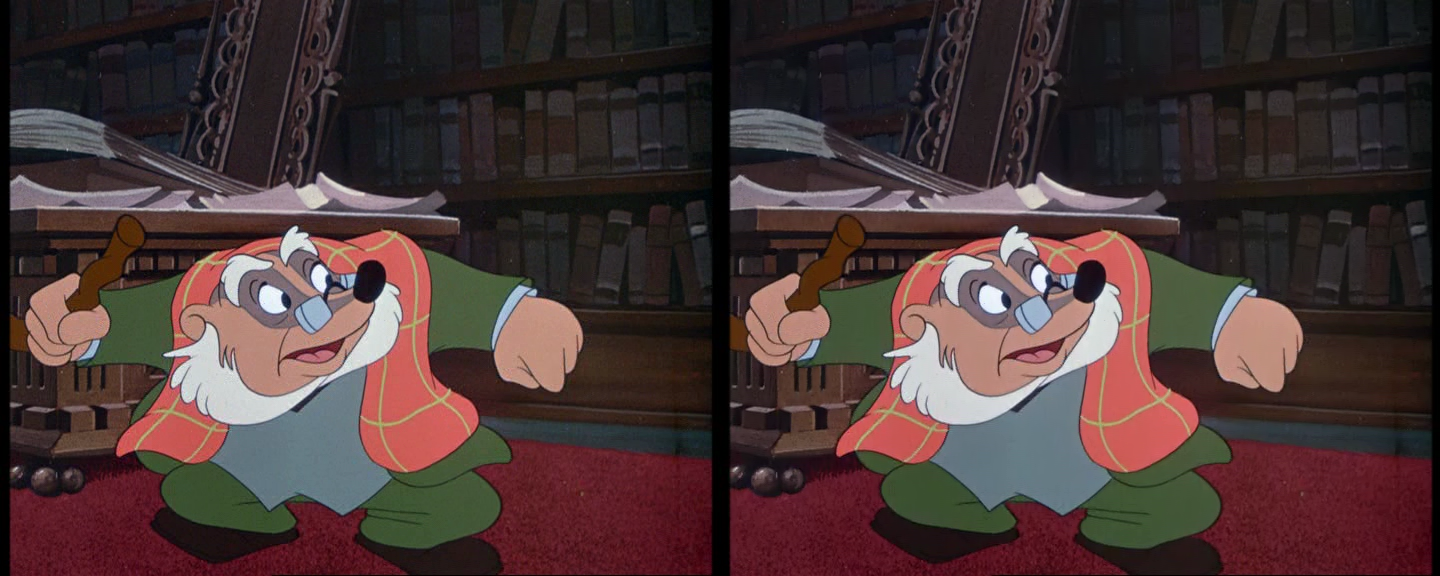

  17. Originally Posted by brusno View Post
    [Attachment 16463 - Click to enlarge]

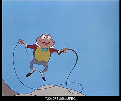

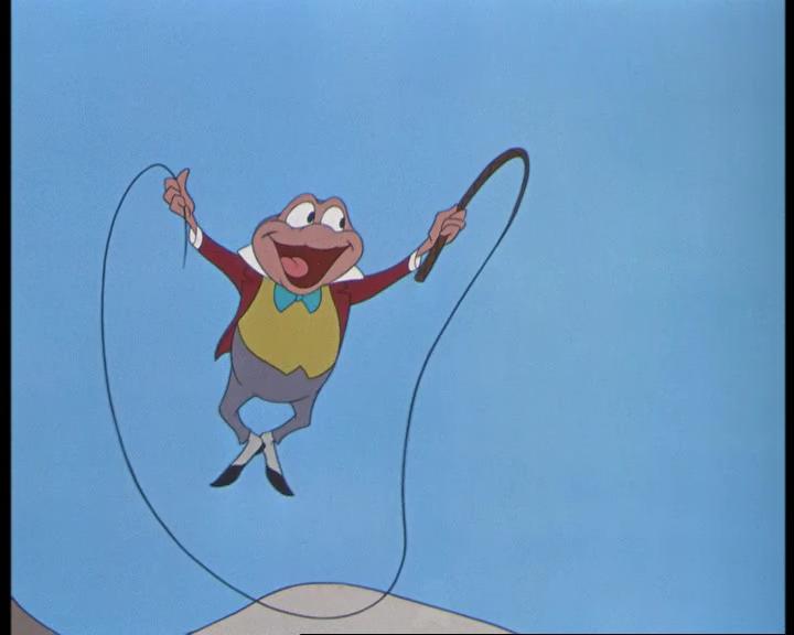

    I don't know what StaxRip is showing but here are frames 828 and 829 from the M2V file:
    I believe those are the two frames that match the fields in the Staxrip image. Though the video is encoded in interlaced mode all the frames in the M2V are progressive. Ie, each frame of the M2V file comes from a single film frame.

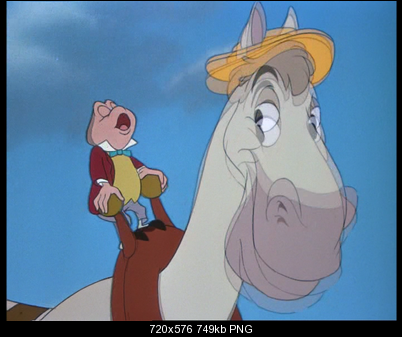

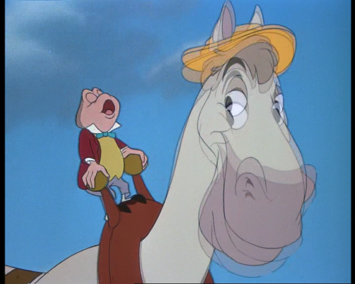

    Mm, look again. You can't go from the interlaced frame in post #14 to the frames shown by jagabo in post #17 without deinterlacing. As it is, your non-deinterlacer might have made some mistakes. Such as broken lines all over the place, one of them shown here (m2v, frame 744):
Name:	m2v - frame 744.png
    But those breaks might be in the original. We don't have the original, so can't say. But there were a few other booboo's (m2v, frame 888):
Name:	m2v - frame 888.png
    Your non-deinterlacer also propogated noise across multiple frames, including dots, So some of that junk can't be cleaned. Shimmer on camera movement is also a problem, due to "non-interlacing" without first doing a little denoising. Flicker is obvious in the m2v, which I'm certain did not exist on your original DVD.
    mkv #1 posted below clears most of the chroma noise (except dots) and all of the flicker.
    mkv #2 has more filtering to help smooth camera pans some more, but it smears detail.
