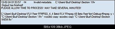

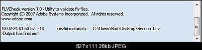

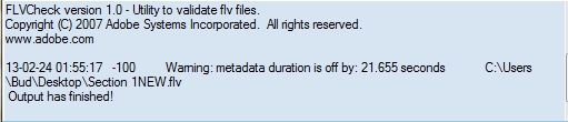

    There seems to be a number of spots in the video that, while most players will play through, FFmpeg will not like. They are areas of incomplete or corrupted areas of 00 00 00 00 00 before an incorrect audio or video start segment.
    If you run FLVCheck and FFmpeg to copy audio and video you get:
Name:	ScreenHunter_469 Feb. 24 01.54.jpg
    and if you attempt to do a copy:
Name:	ScreenHunter_469 Feb. 24 01.55.jpg

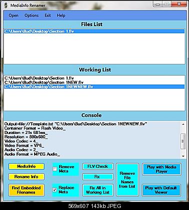

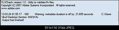

    You get this result with FLVCheck:
Name:	ScreenHunter_470 Feb. 24 01.55.jpg
    If you copy it a gain you will get a correct check but the video will only be the first 21 seconds of the film( where the first bad area is):
Name:	ScreenHunter_472 Feb. 24 01.58.jpg
    I've had this problem my self and its caused by the invalid areas in the video. It can be corrected with a HxD editor but its time consuming and you need a good knowledge of FLV file format.
