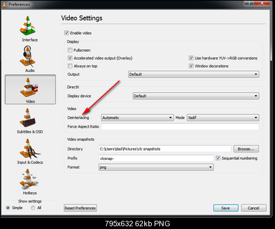

  2. "venetian blind/ ripple effect" during movement suggests to me it's interlaced, and you haven't activated a deinterlacer
    e.g in VLC video=> deinterlace on , video=> deinterlace mode (choose either bob or yadif 2x)

    ehh? you are confused. interlacing is or isn't present in video files, you can't turn it on or off. deinterlacing is a filter that can be applied to the video or not.

    interlaced video is saved as 2 separate fields for each frame. every other line goes into one field the rest to the other. combined makes one frame. it's the way tv has worked from the beginning. computer monitors display an entire frame at once not one field at a time. in order to display interlaced video on a computer monitor it needs to be combined and displayed as one frame, not one field and then the other. hence all the "filters" to de-interlace video. there is no perfect way to do it as the fields were recorded at separate times and putting them back together tends to make stair-stepped pictures. if not done properly it can look like venetian blinds.
    are you sure you are talking about the same video on the 2 different computers? the cam may record either interlaced or progressive depending on the settings.
