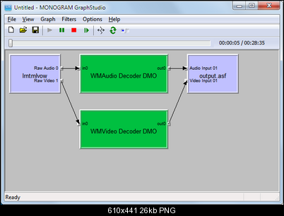

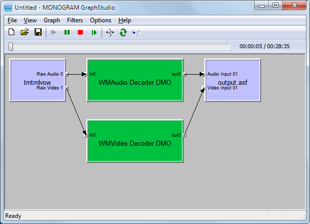

  2. PotPlayer is able to play the mms stream. I was able to use GraphStudio to download and save the video to a file:
    Just add the "WM ASF Reader" and "WM ASF Writer" filters, connect the pins, and press the Play button. I think it's being reencoded though.
    I was able to use the Avi Muxer and File Writer filters to write the compressed output of the WM ASF Reader to an AVI file. That way there was no reencoding.
    I suspect you could use the Dump filter to write the audio and video streams as separate elementary stream files and use some other tool to mux them.

    Admittedly I'm a little confused of GraphStudio - how do you add filters?
    Graph -> Insert Filter. In the pulldown at the top left of the Filter dialog select DirectShow Filters. In the list below that double click on WM ASF Reader. When it asks for a filename or URL tick and enter the URL (mms://...). Press OK. Back at the Filters dialog double click on WM ASF Writer. Enter the filename you want to save to. Press OK. Close the Filter dialog. Back at the main Window connect (drag and drop) the raw audio output pin (the small box on the right side of the filter) of the source filter to the input pin (small box on the left side) of the output filter. Any filters required to connect the pins will be added automatically. Do the same for the video pins. Press Play. Wait until it's done.
