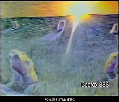

  3. Any video editor with overlay can do that. Just use a black (or whatever color you want) image with an alpha mask.
    Source video:

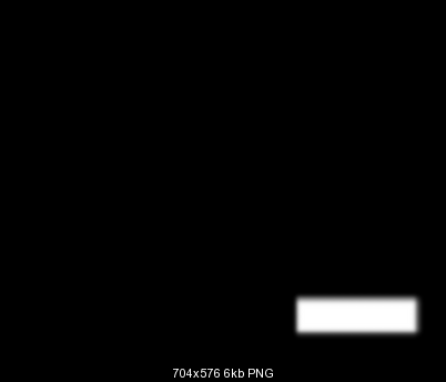

    Alpha mask:

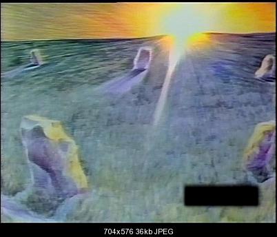

    Overlay (with black image):

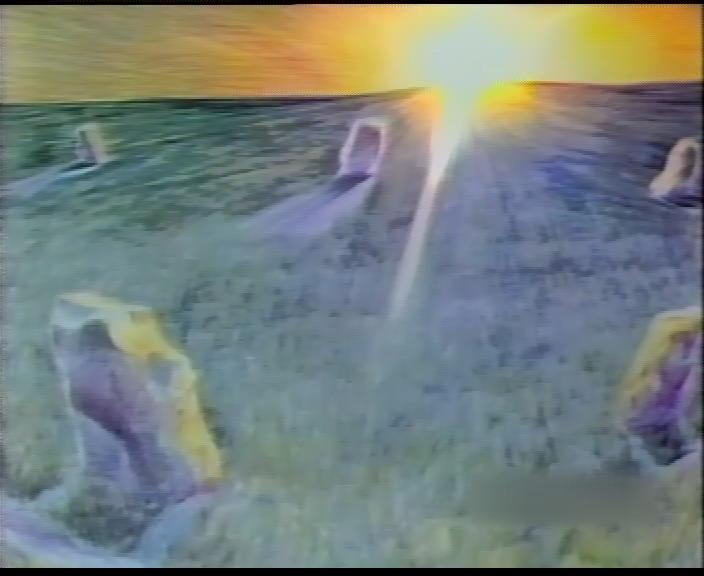

  5. If he doesn't want a black overlay he can use a blurred copy of the original video instead. I find the jittery crap left behind by logo removers to be more distracting than the original logo. Semi transparent logos can be removed with little residual junk/noise. But that doesn't seem to be what the OP is talking about.
    Overlay with blurred version of the source:
