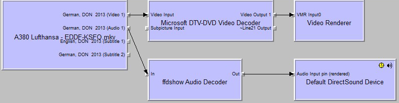

    OK, have set up the programme ready to process the mkv file, with subtitles and all and have taken a screenshot of the graph. Is that what you meant? This is the screenshot, anyway.
    A bit ominous BTW that after running the menu wizard the preview it shows of the menu is just a blank, grey square, rather than an image from the video, as I usually get..

  13. @Martin
    the AVC video stream is not processed by ffdshow, as the audio stream is. That's can lead to problems. You have Windows7 installed, don't you? Download Windows 7 Preferred Filters Tweaker and select ffdshow for video processing. More details in FAQ/General/Q1.5

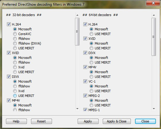

    Ok, I have downloaded and installed the Win7 Filters Tweaker and checked that I have the latest ffdshow installed (the downloaded setup file is ffdshow_rev4499_20130104_clsid .. I believe this is correct for my O/S, which is Windows 7 64-bit.
    When I choose Preferred Decoders in the Tweaker, I get the screen as per my screenshot. It shows 32-bit and 64-bit decoders, but ffdshow doesn't appear on the 64-bit side. Is that correct? The ffdshow version I have is specified as 64-bit.. So do I now enable ffdshow for ALL appearances under 32-bit? Or is the reason I am not getting viewable DVDs down to the lack of ffdshow in 64-bit? Maybe I haven't set up ffdshow correctly? Not really sure if I need to set this up manually from the ffdshow programme - will have to Google it..

  15. AVStoDVD is a 32bit application, therefore ffdshow 32 bit must be installed. If you want to install a 64bit version, you can, but it will not be used by AVStoDVD.
    Select ffdshow for the 32bit side in Preferred Filters Tweaker, then try again the 2 projects with the MKV and MOV as source titles.

    I went ahead anyway after my last post and selected ffdshow in all the 32-bit options. I haven't yet been able to try a .mov file, but files in .mkv format now work fine in AVStoDVD, so thanks for the help.
    The only problem I seem to have is left is that, no matter how I adjust the parameters in ffdshow/subtitles, when I add subtitles to a movie, they all appear too far over to the right, but as this is a different topic, I will start a separate thread for it...
