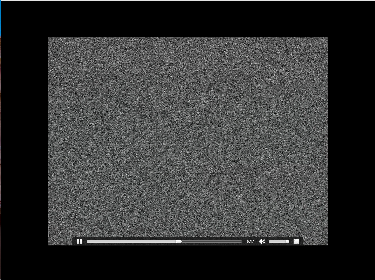

    The idea is to upscale the content the 4:3 source to 16:9 with pillar boxing. This is not really intended for Blu-ray my apologizes for posting into the wrong forum. I have tried a view conversions but it is coming out as a 4:3 center cut instead. The bottom and top are filling the entire region.

    Jan 2013
    The source 4:3 (720x540) content does have black borders on both the left and right..
