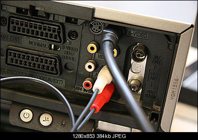

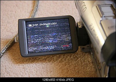

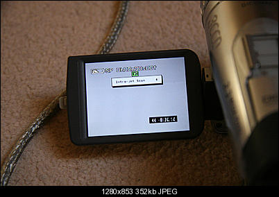

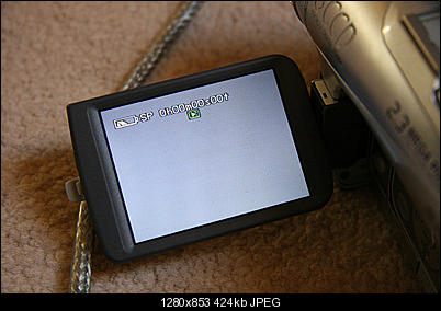

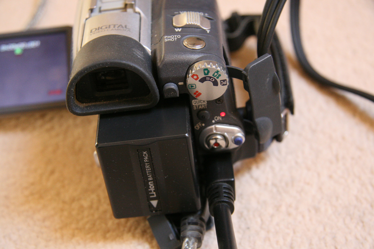

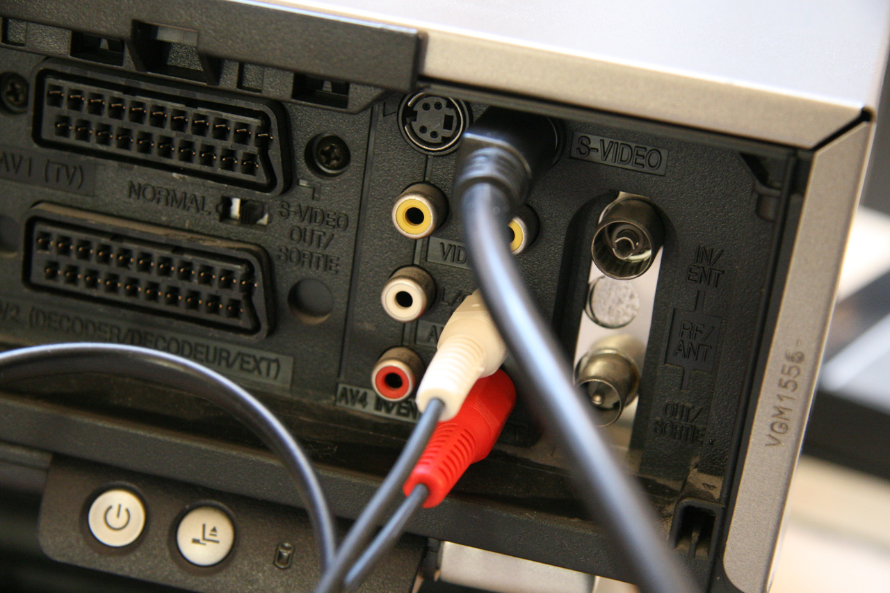

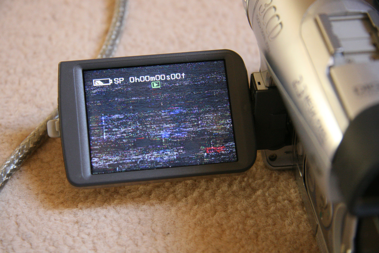

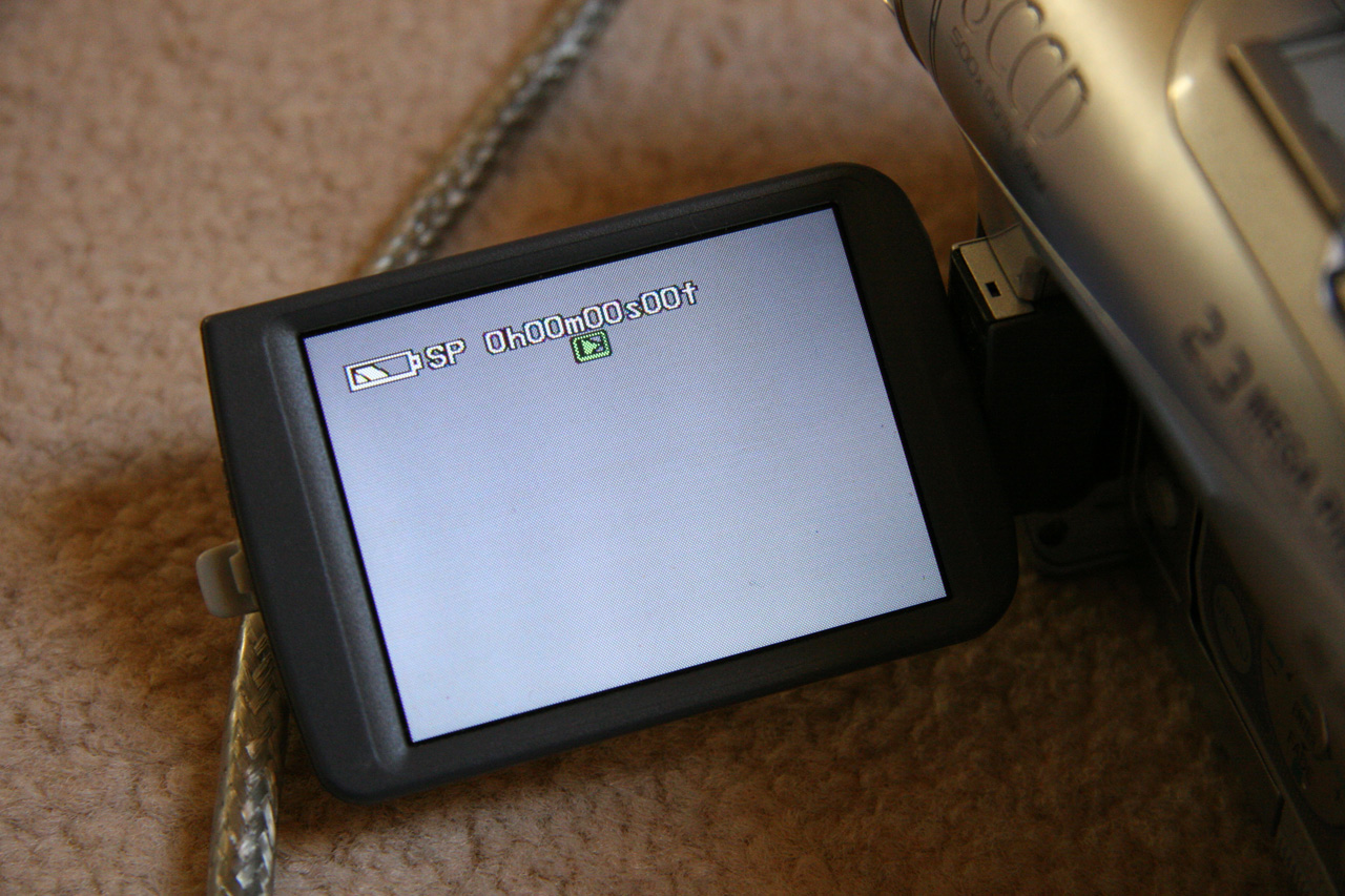

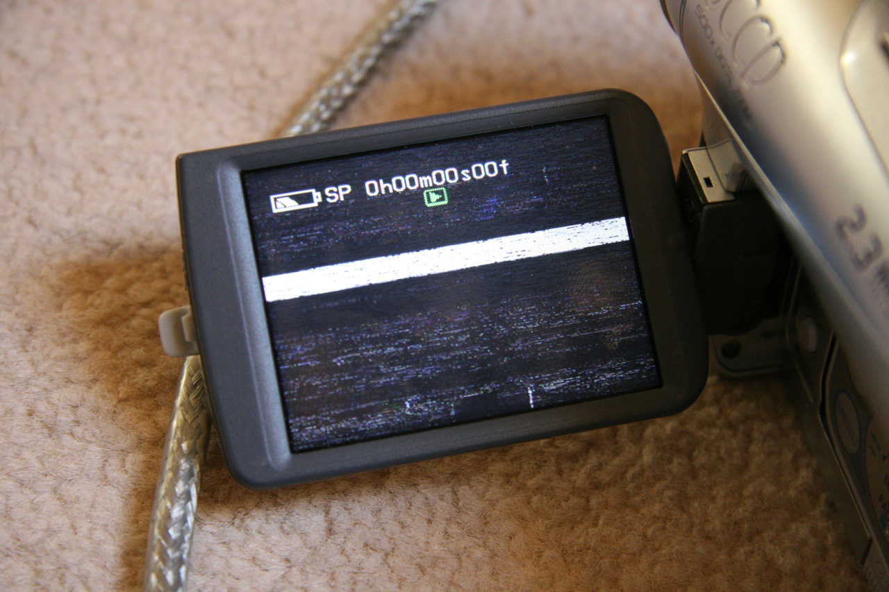

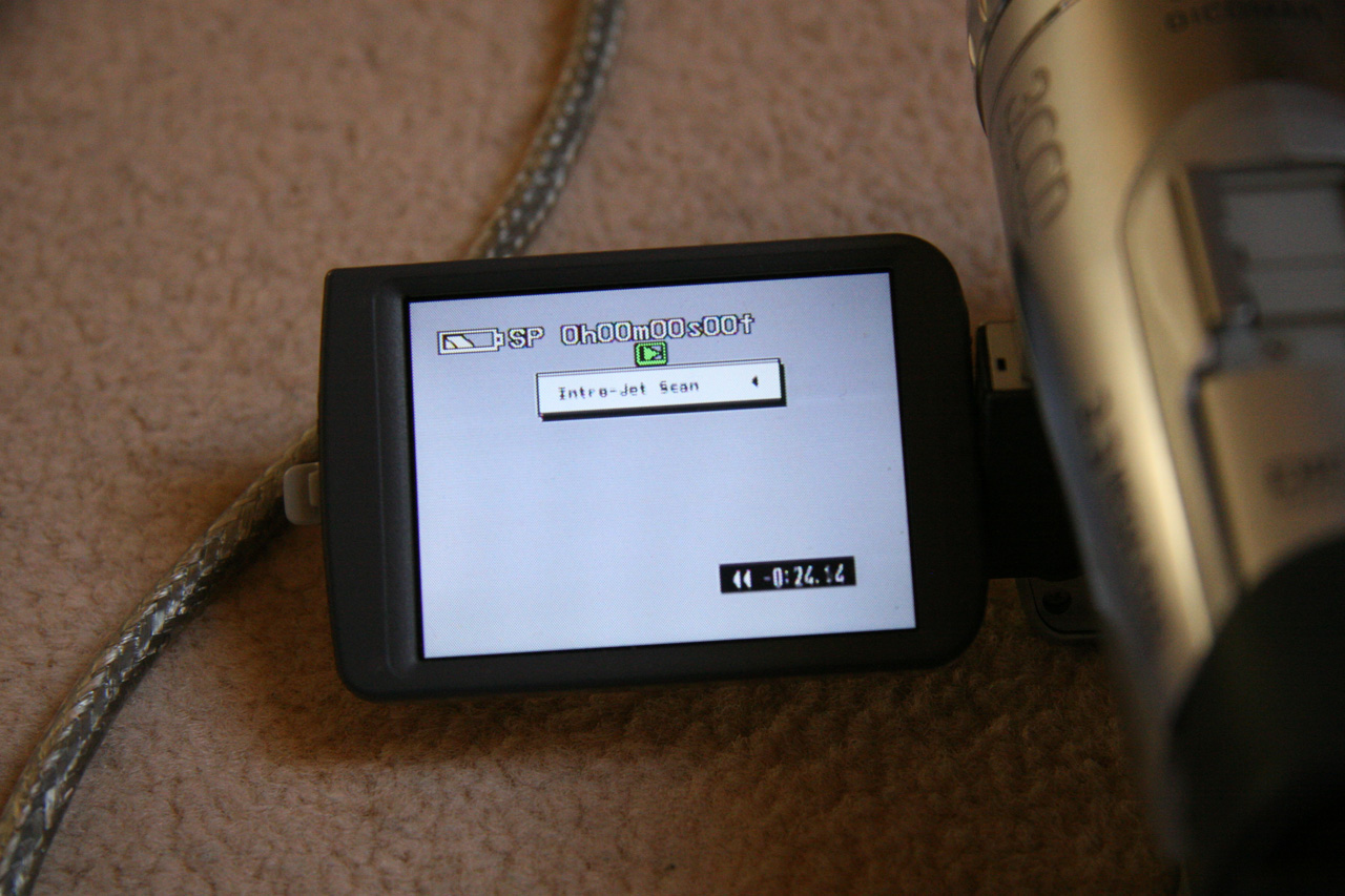

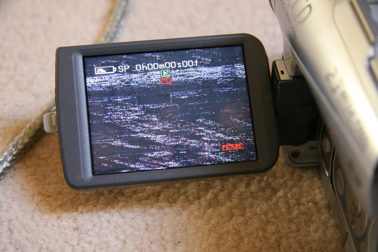

    I left the VCR for a week and today i deciced to do some capturing, but all i get is a grey screen with sound if i press the TBC button i get a really lined picture (SEE PICS)
    i have used svideo, compostie and i tryed the Scart connection and it all i get

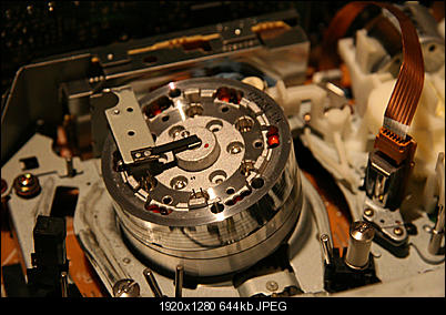

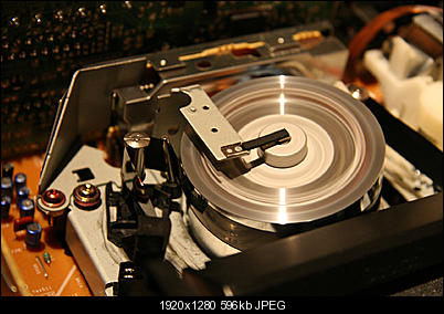

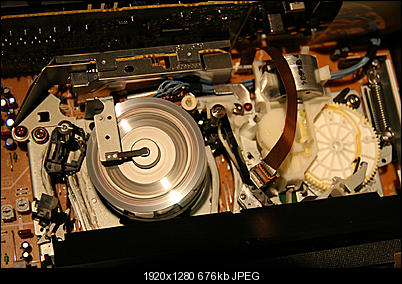

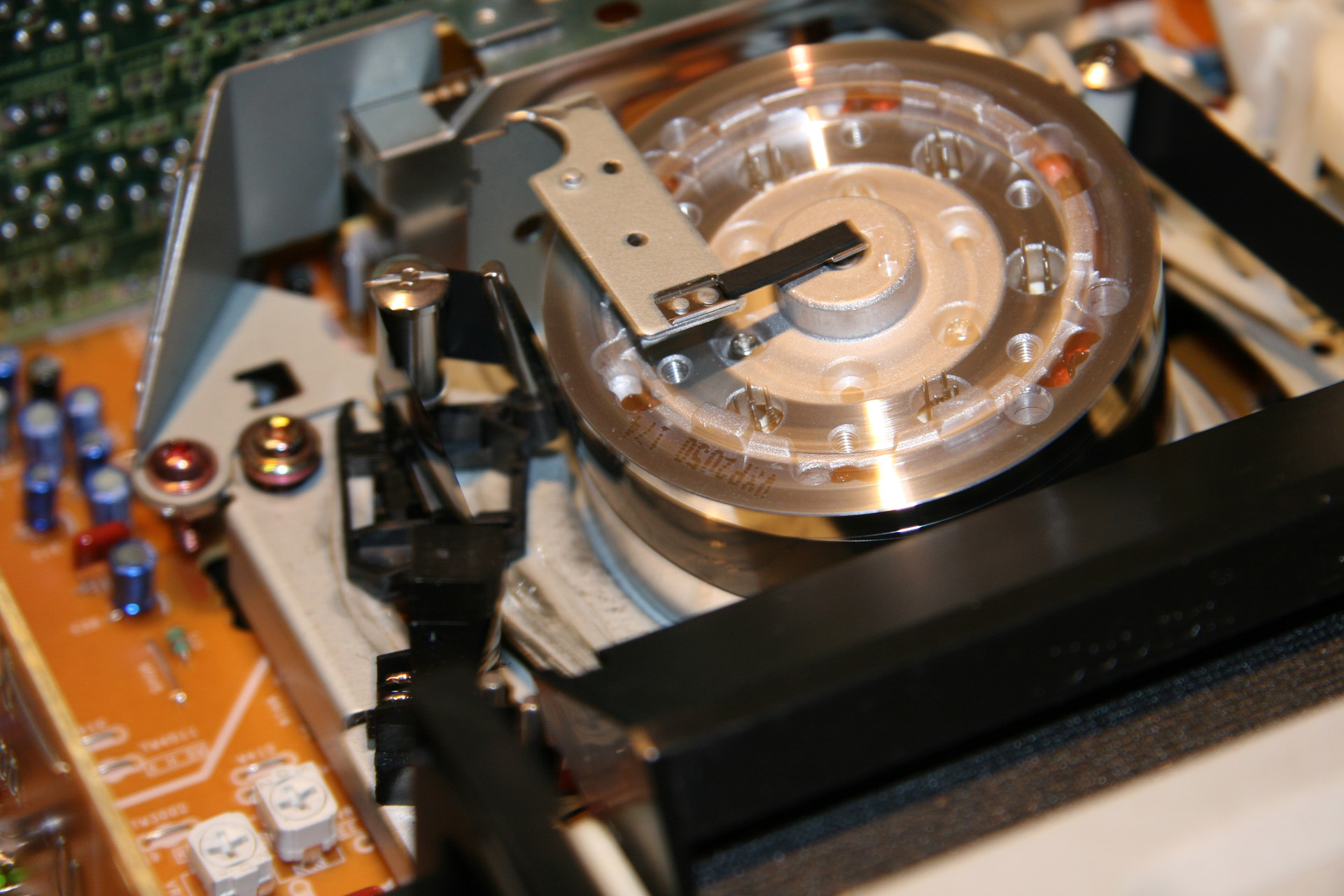

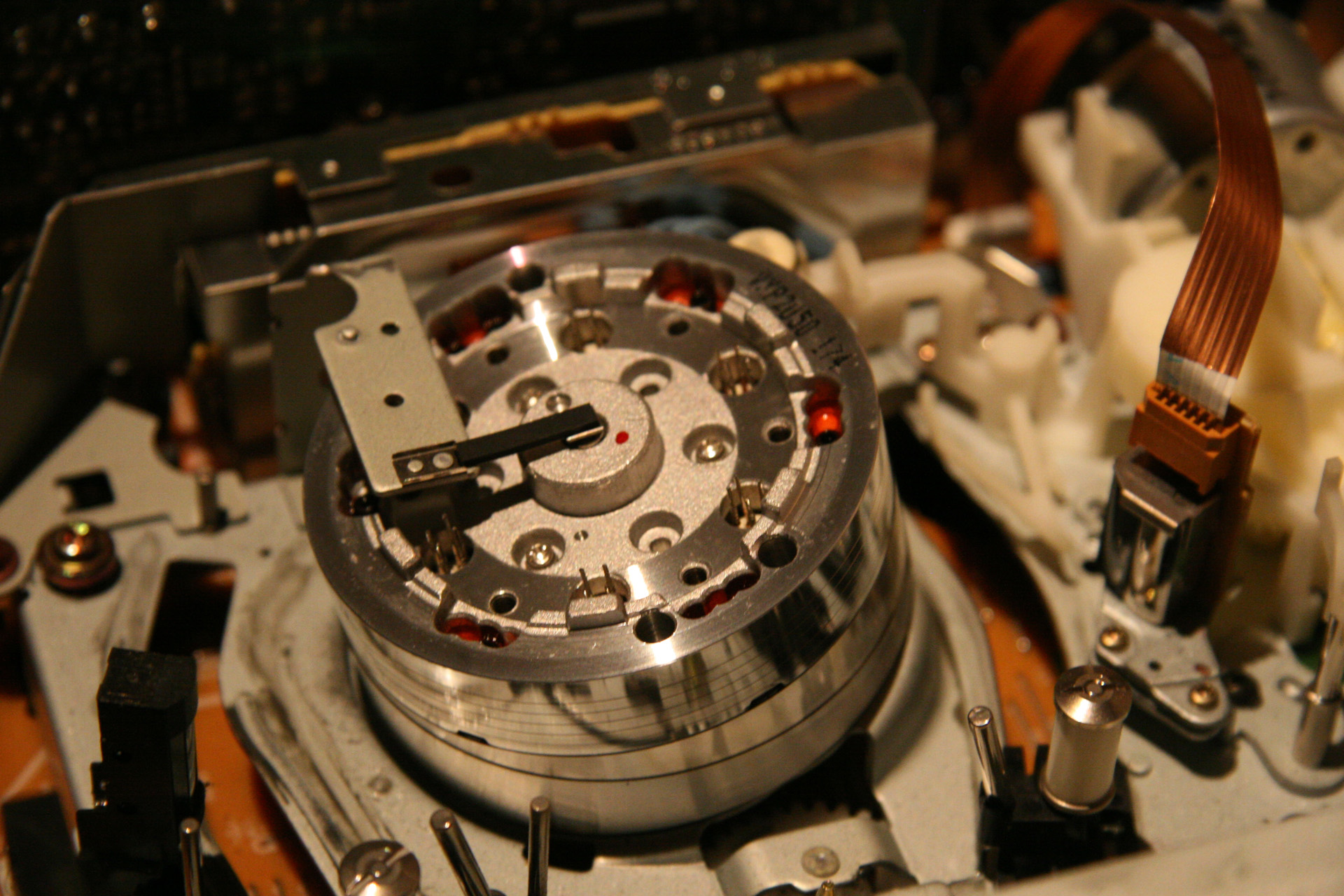

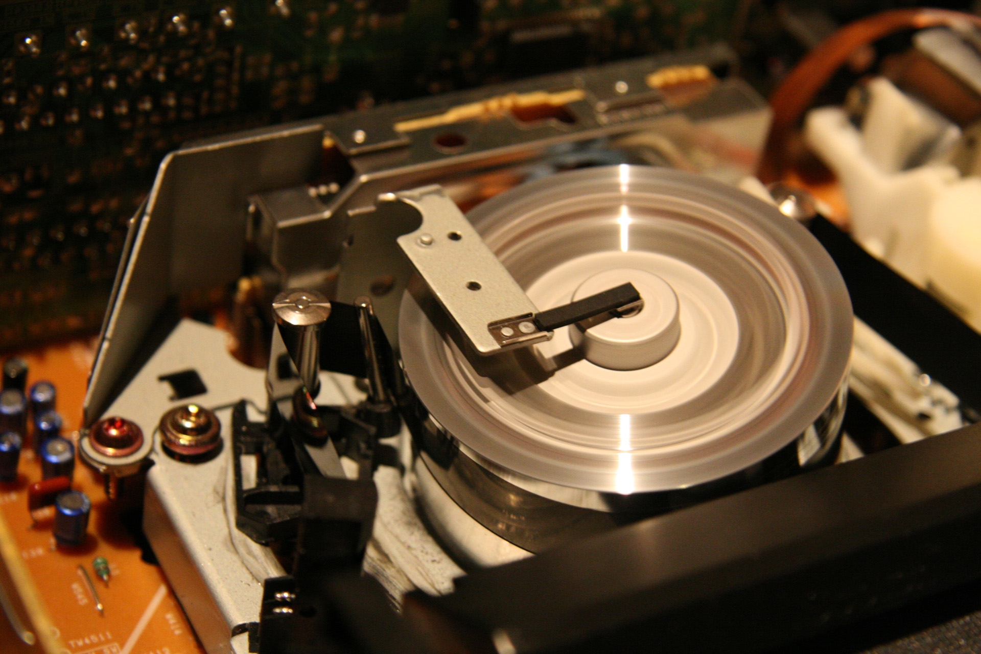

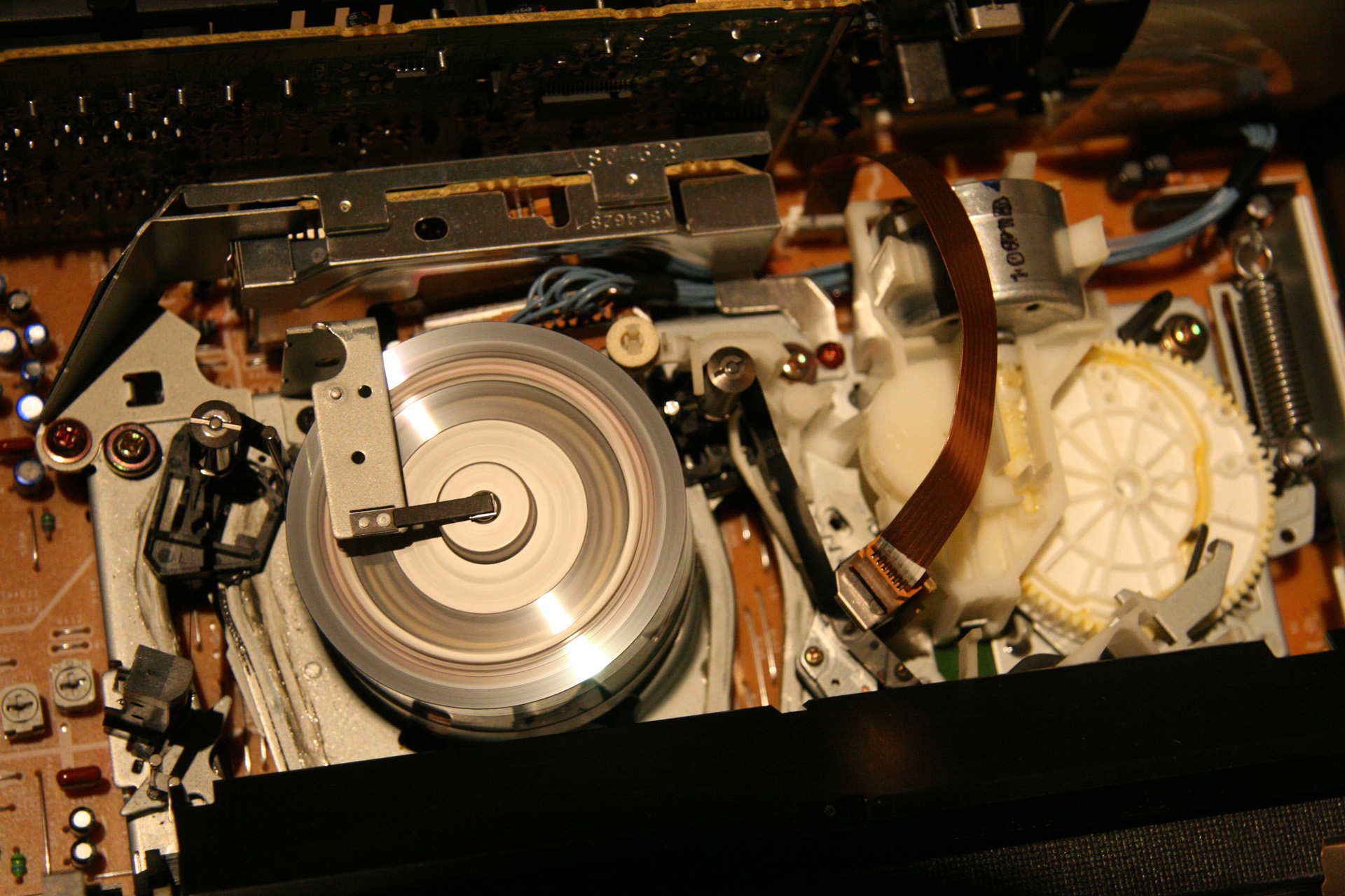

    just opened up the VCR
    Here's a few pics of the insides of the vcr with and without a tape, just followed instructions as indicated by all tutorials clean very lightly with strips of plain paper, unless the damaged has been done by vcr just lying unused for a year.
    Any other suggestions i could try while its opened, or shall i just get it repaired, how much are we looking at to repair costs in ££ or can a repair be attempted by me

    Not sure where white paper ever came from. Would seem to abbrasive for me. The most of I've used was a cotton swap with isproply alcohol.
    Do all tapes display the same issue? Make sure to use tapes that you don't need. Damaged heads can just as easily damage the tapes themselves.
    No idea on repair costs. In general, unless you have a professional or semi-pro deck, it would probably be cheaper to buy a new one.

    you would need to post 30x mag scope pictures of just the heads to make any call. try a normal wet or dry head cleaning tape. the paper may have left soggy pieces on the heads. paper is normally used dry, as a light abrasive not a cleaning sponge.

    This is why I'm very cautious about web "tutorials". Who are these people?
    I was shown how to clean vcr heads years ago by a couple of real pro techs who actually knew what they were doing. You do not touch the heads. Period. You dip a swab in isopropyl alcohol and hold it above the heads, letting the alcohol drip over them. This is really the only safe method.
    However, obviously people used those stupid head cleaners for years without bricking their vcrs. I'm not convinced that it's necessarily the heads. The mechanism may be gunked up by disuse and improper storage.

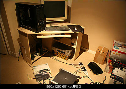

    I'm not saying that this is for sure what the problem is, but nobody else has mentioned it. One of our veterans members has pointed out in the past that keeping electronic equipment in rooms where people smoke can lead to oily residue getting inside the equipment. bob52 - is there any chance this was done with your VCR? That would explain how it could be messed up now after being essentially untouched for a year and have nothing to do with your cleaning attempt.

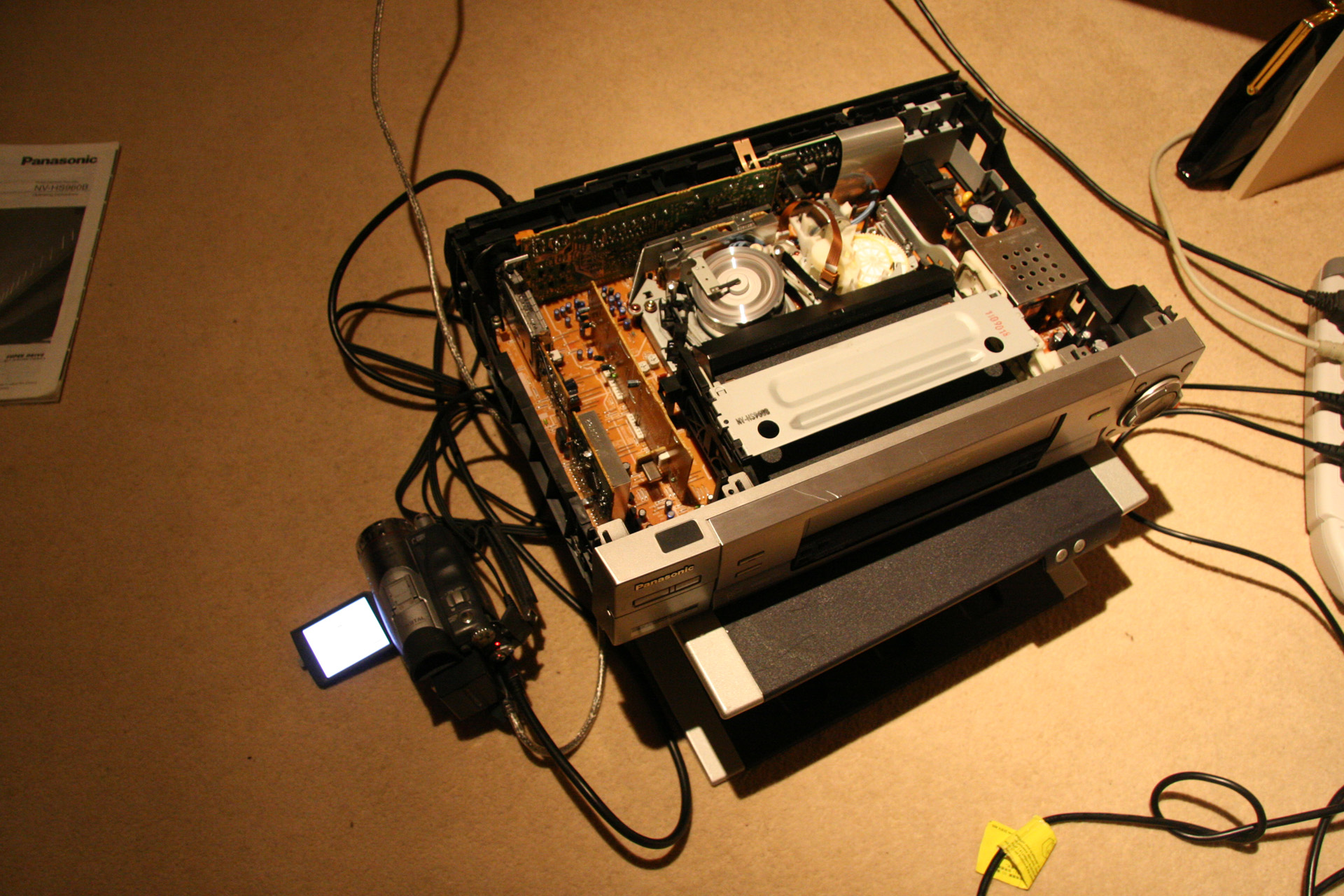

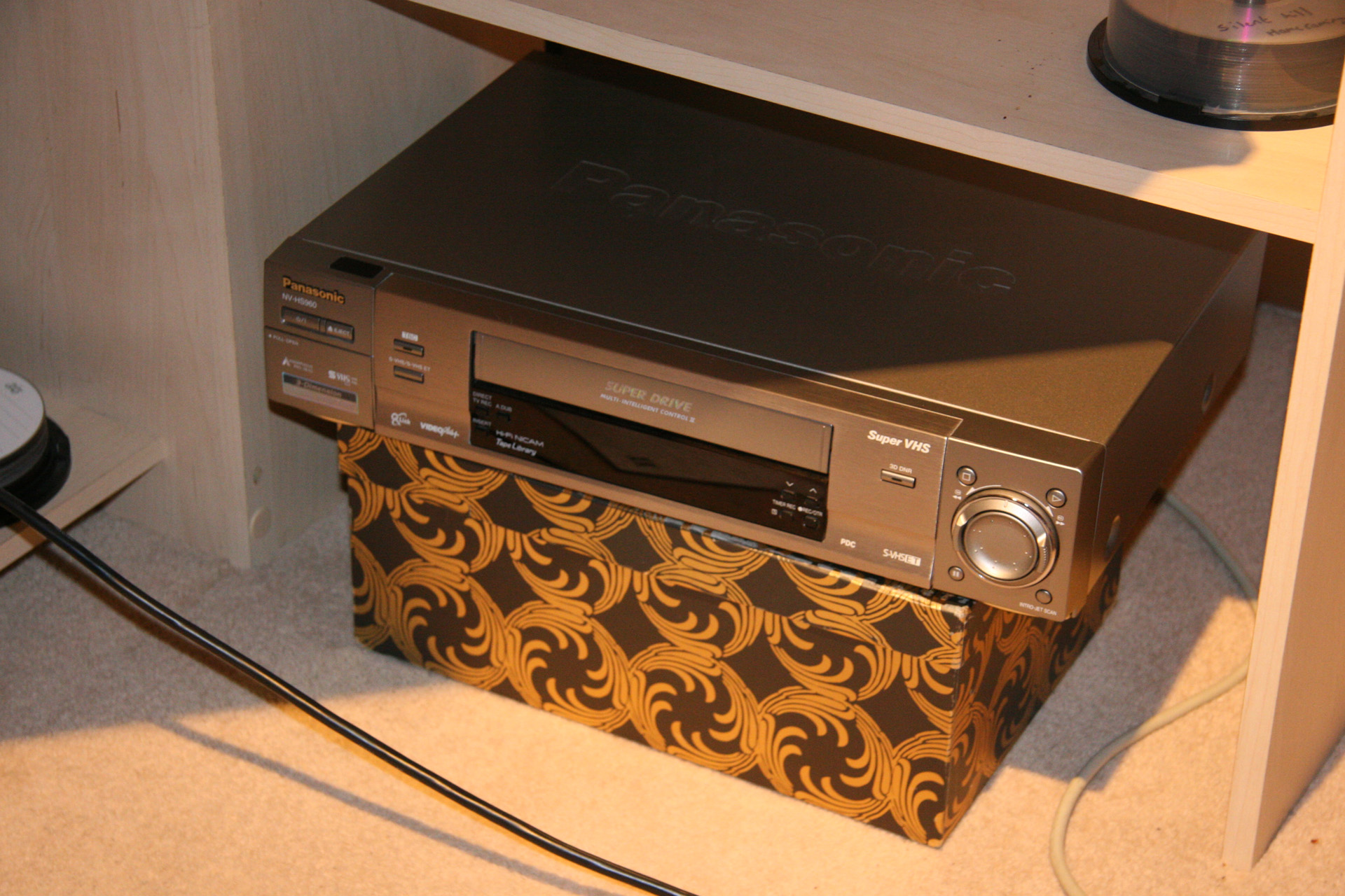

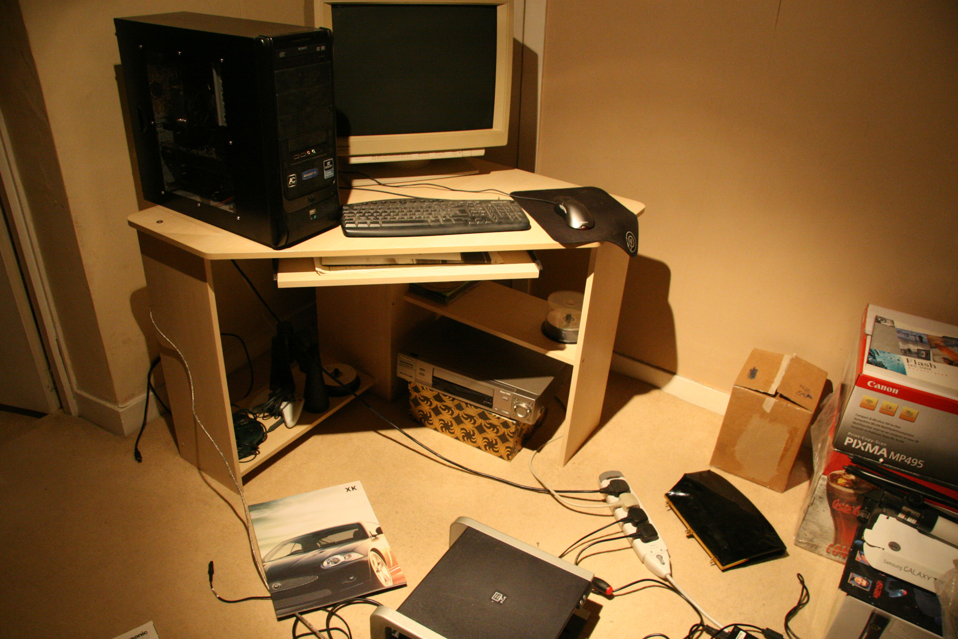

    Here are a couple of pics on how and where i left the VCR for a year in the loft, and i left tape in it in play mode
    That loft room also has a combi boiler in it so it cold during the day and warm when the central heating goes on in the evening during the winter months, in the summer it can get warm up there and on many occasions i have forgot to open the loft windows to let some air in, i dont smoke, and i have no pets, but i did get the new boiler put in during spring of 2012 and there was a lot of dust (PC keyboard for eample) but the VCR was well covered and there no dust i could see inside

    I tryed the VCR again, i get a fuzzy, liney ,snowy picture (with sound) ,IF i turn TBC on, otherwise its a grey screen with sound
