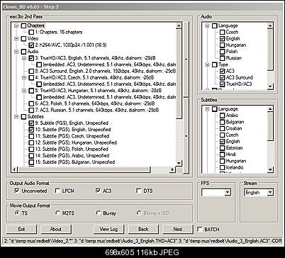

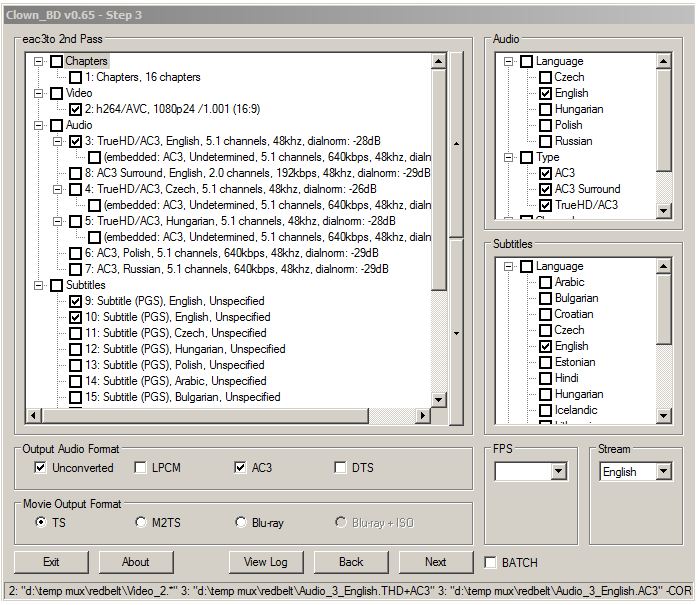

  6. Have a question regarding extracting the Dolby TrueHD audio in ClownBD,
    In the picture below the Dolby TrueHD is selected in the left side menu but in the right side menu under "audio/type" there are 3 different types selected. Should i de-select the "AC3" & "AC3 Surround" if i only want to keep the Dolby TrueHD audio or should all 3 remain selected?
    This could explain why my previous rip differed so much in size, i didn`t de-select the other 2 types.

  7. Banned
    Feb 2013
    No need to deselect
