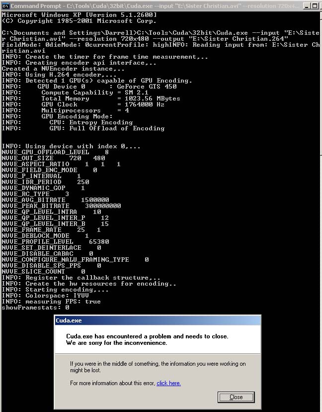

    It's not working on my end. I tried your profile in the zip file and changed the path the Cuda.exe and I also built the encoder set according to your instructions, copying and pasting the argument but it will not work. Matter of fact, I can't even run the encoder from a command prompt.
    the error code varies, depending on source...
    Error: The video encoding process has prematurely exited with an error
    code of -1073741674 (c0000096). Check the log for possible error messages.
    code of -1073741819 (c0000005). Check the log for possible error messages.
    One error said something about "anonymous pipe" but I only saw that once. The two error above happen every time, usually the second one.
    Every time I try to use the command prompt, it loads everything up and looks like it's going to do something but Cuda.exe crashes every time. Either something is wrong with the exe file that you posted for download or my system is wacked.
    Here is a screen capture of the command prompt crash...
    The external encoder feature crashes in the exact same spot.

    2013.03.27 - 22:49:23_Windows XP-32bit_2013.02.16.1 - postponeJobs:
    2013.03.27 - 22:49:23_Windows XP-32bit_2013.02.16.1 - Starting parents,..
    2013.03.27 - 22:49:23_Windows XP-32bit_2013.02.16.1 - startJobs: 22_31_43_0610

    helperCall: "C:\Unzipped\Hybrid\mencoder.exe" -lavdopts threads=4 -really-quiet -of rawvideo -o - -ovc raw -noskip -demuxer lavf -vfm ffmpeg -vf scale,format=i420 -forcedsubsonly -nosub -nosound -mc 0 "G:\MUSICV~1\BLUEOY~1\22-LAS~1.MPG"
    mainCall: "C:\Unzipped\Hybrid\cuda.exe" --resolution 640x360 --input - --sar 1x1 --format IYUV --control_mode cbr --bitrate 2000 --bitrate_peak 20000 --fps 30 --profile high --level 40 --offload full --measure FPS --showFrameStats 100 --deinterlace false --frame_typ frame --pframe_dist 1 --gop_max 250 --dynamicGOP true --pquant_min 12 --bquant_min 15 --iquant_min 10 --deblock true --cavlc false --nal_typ auto --sps_pps false --slices auto --output "C:\DOCUME~1\Darrell\LOCALS~1\Temp\22_31_43_0610_0 2.264"
    2013.03.27 - 22:49:23_Windows XP-32bit_2013.02.16.1 - 22_31_43_0610_02_video ### E:\22-Last Days of May_Title_1.mkv ### Starting Main@22:49:23.421:

    2013.03.27 - 22:49:25_Windows XP-32bit_2013.02.16.1 - SETTING colorformat --format: IYUV
    fieldMode: 0dieMode: 0currentProfile: highINFO: Reading input from stdIn,...
    INFO: Create the timer for frame time measurement,..
    INFO: Creating encoder api interface,..
    Created a NVEncoder instance,..
    INFO: Using H.264 encoder,...
    INFO: Detected 1 GPU(s) capable of GPU Encoding.
    INFO: GPU Device 0 : GeForce GTS 450
    INFO: Compute Capability = SM 2.1
    INFO: Total Memory = 1023.56 MBytes
    INFO: GPU Clock = 1764000 Hz
    INFO: Multiprocessors = 4
    INFO: GPU Encoding Mode:
    INFO: CPU: Entropy Encoding
    INFO: GPU: Full Offload of Encoding
    INFO: Using device with index 0,...
    NVVE_GPU_OFFLOAD_LEVEL 16
    NVVE_OUT_SIZE 640 360
    NVVE_ASPECT_RATIO 1 1 1
    NVVE_FIELD_ENC_MODE 0
    NVVE_P_INTERVAL 1
    NVVE_IDR_PERIOD 250
    NVVE_DYNAMIC_GOP 1
    NVVE_RC_TYPE 2
    NVVE_AVG_BITRATE 2000000
    NVVE_PEAK_BITRATE 20000000
    NVVE_QP_LEVEL_INTRA 10
    NVVE_QP_LEVEL_INTER_P 12
    NVVE_QP_LEVEL_INTER_B 15
    NVVE_FRAME_RATE 30 1
    NVVE_DEBLOCK_MODE 1
    NVVE_PROFILE_LEVEL 10340
    NVVE_SET_DEINTERLACE 0
    NVVE_DISABLE_CABAC 0
    NVVE_CONFIGURE_NALU_FRAMING_TYPE 0
    NVVE_DISABLE_SPS_PPS 0
    NVVE_SLICE_COUNT 0
    INFO: Register the callback structure,..
    INFO: Create the hw resources for encoding..
    2013.03.27 - 22:49:25_Windows XP-32bit_2013.02.16.1 - INFO: Starting encoding,...
    INFO: Colorspace: IYUV
    INFO: measuring FPS: true
    showFramestats: 100
    2013.03.27 - 22:49:28_Windows XP-32bit_2013.02.16.1 - -> 22_31_43_0610_02_video crashed:main send out an error: QProcess::Crashed
    2013.03.27 - 22:49:28_Windows XP-32bit_2013.02.16.1 - MAIN CALL CRASHED: main send out an error: QProcess::Crashed
    2013.03.27 - 22:49:28_Windows XP-32bit_2013.02.16.1 - 22_31_43_0610_02_video ### E:\22-Last Days of May_Title_1.mkv ### main send out an error: QProcess::Crashed
    2013.03.27 - 22:49:28_Windows XP-32bit_2013.02.16.1 - 22_31_43_0610_02_video ### E:\22-Last Days of May_Title_1.mkv ### finished after 00:00:05.000 with exitCode -1073741819
    2013.03.27 - 22:49:28_Windows XP-32bit_2013.02.16.1 - Killing helper,...
    2013.03.27 - 22:49:28_Windows XP-32bit_2013.02.16.1 - Killing process,...
    2013.03.27 - 22:49:28_Windows XP-32bit_2013.02.16.1 - 22_31_43_0610_02_video ### E:\22-Last Days of May_Title_1.mkv ### Crash: 1
    2013.03.28 - 00:46:52_Windows XP-32bit_2013.02.16.1 - save text to: C:\Documents and Settings\Darrell\Application Data\hybrid\autosavedJobs.xml
    It crashes every time, right at the "showFramestats: 100", no matter what video I try to encode with Cuda. That's where I got the two dll errors before. I thought I saw them again in the Appcompat.txt file but when I went to double check in my temp files, it was gone.
