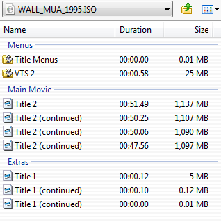

  1. I am trying to convert a DVD into avi, by using dvdshrink and autogk. I load the ISO file to dvdshrink and for the Main Movie I get "Title 2" and three more "Title 2(continued)". I double click all four of them and load them to the DVD structure and back them up (with the "split vob files into 1gb size chunks" unticked). The result is a folder with the following files:

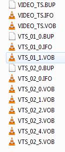

    Now, I cannot load the video_ts.ifo to autogk because it says "vob files are not found". When I load the VTS_01_0.IFO, it only converts the first vob file. My question is, which file should I load to autogk in order to get a single (or two maximum) avi file(s)? I have used this method only once before this project, but there was only one main movie title and only one vob created by dvdshrink, which I loaded to autogk.
  2. Renumber the VOBs consecutively so that you have VTS_01_1.VOB, VTS_01_2.VOB, VTS_01_3.VOB, VTS_01_4.VOB, and then load the first VOB into AutoGK. The rest will follow.
    However, because I don't use DVDShrink I don't quite understand what you did and if that was the original DVD structure. I've never in my life seen a single movie (if that's what it is) divided over 4 VTSs. Is that the way it looked in the hard drive before running it through DVDShrink (is that what was inside the ISO you made)? If so, why did you screw it up so much that you had to come here to ask for help? Next time just use DVD Decrypter in File Mode or DVDFab HD Decrypter to put the DVD on the hard drive (and not in ISO format) and then load the IFO or the first VOB into AutoGK. You don't need to use DVDShrink at all.

    Ok, I think I got it now. I unzipped the ISO and you are right. The numbering is different:
    Name:  vobs from ISO.PNG
    The VTS_01_1.VOB is the company's logo video and the VTS_02_1.VOB (until 5) is the movie. So, I just have to load VTS_02.1.VOB to autogk and I will get the whole movie in one avi file, right?
  8. Yep. Or the IFO if there are subtitles you want.

    Well, that was what initially confused me, cause when I loaded the ISO to dvdshrink the main movie was in four parts:
    At that point I was not sure if dragging only the first "Title2" was enough, so I dragged all four and I suppose that is why I ended up with the weird structure. For some reason I believed that dvdshrink was needed to attach the vobs into one. Then with the help of the people on this thread, I realized I don't even need to use dvdshrink, cause autogk does this job by loading just the first vob file of the main movie.

  15. If your pic is of the right pane after using the re-author button then I'm not sure I've ever seen a DVD which looks like that before. Normally there's more than one title, but each episode or the movie will be just a single title for each. Given you were opening an ISO rather than a disc, I'd guess there was something unusual about the way the DVD structure was changed when that ISO was created.
    Often you'll have a DVD which is made up of a large set of vob files and DVDShrink's re-author function will let you extract just a single title and then save that as a new set of vob files but it can't join multiple titles together. As I said though, if that's DVDShrink's right pane I'm not sure I've ever seen a DVD with a movie title which has been split like that.
  16. Originally Posted by hello_hello View Post
    Yes, it is the right pane after using the re-author button. As I mentioned on my first post, I have used dvdshrink only once before with another movie and the main movie was just one vob. That is why I got confused with this one and ended up here. I haven't created the ISO myself so I don't know if there is something with the structure or maybe just because it's a very long movie (almost 3 and a half hours). Never mind though, since autogk does the job. Thanks a lot.
