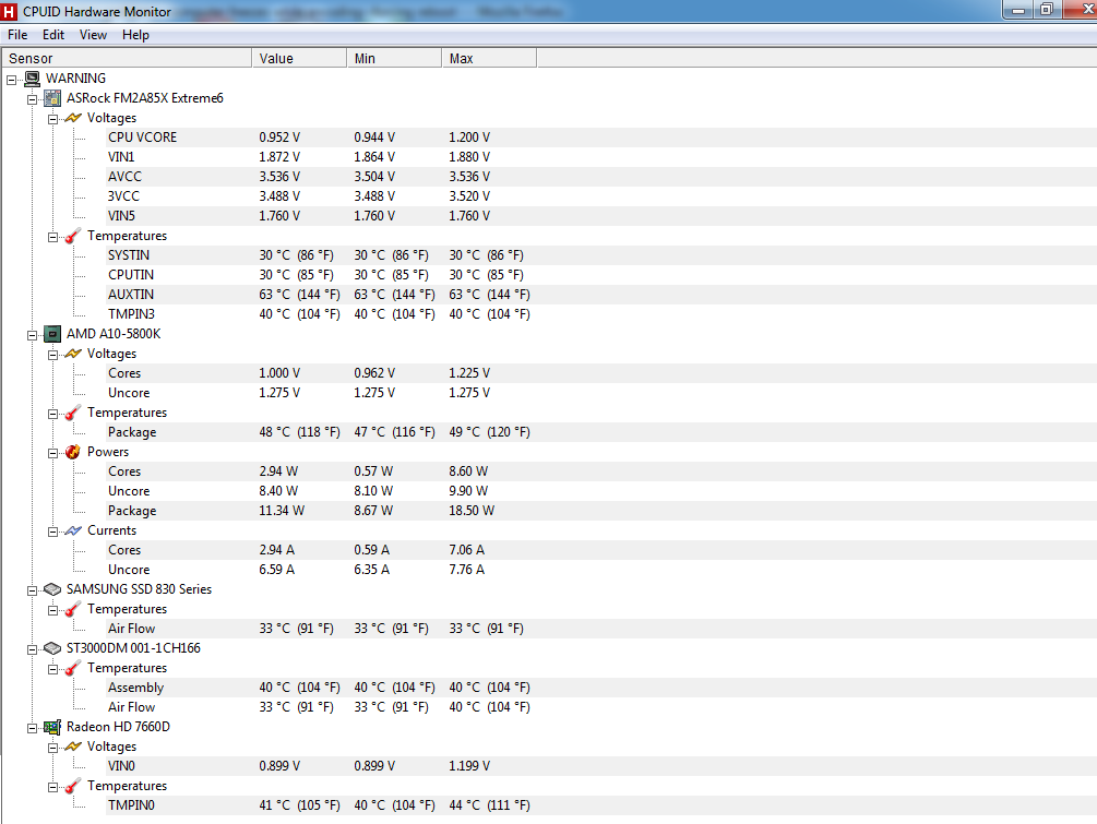

    Attached is a screenshot of HWMonitor info:
    I really appreciate all your help and insight. Will keep you posted.
    -=K=-

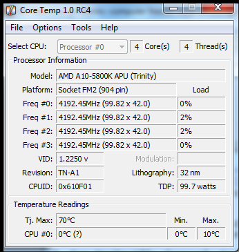

    Core Temp showed a reading of 0C. Not really possible unless the computer is in a freezer.

    I notice Hardware Monitor is not showing Core temperatures. Do you have the cores disabled in BIOS?

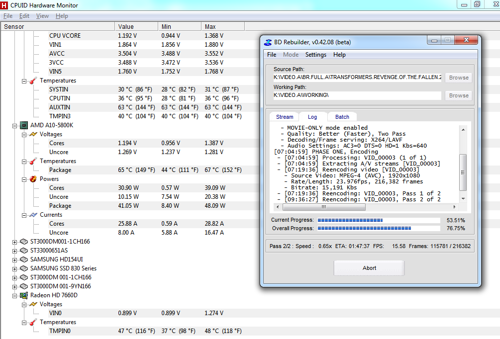

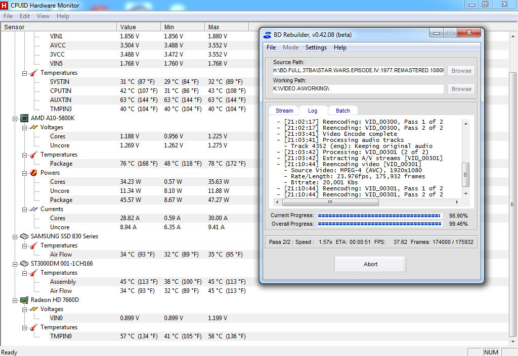

  13. Good news to report!
    Took advice and did BD25 (High-Speed Option)..completed in 2hrs including ISO. About 36-37 FPS. Temps got up to approx 78ēC during the encode.
    See attached screen shot with HWMonitor + BD-RB
    To put in perspective (and answer questions), the encode was full throttle vs idle. I saw the core temps in BIOS, but did not try to disable the temps (would not know how)..unless you can guide me to change settings. Mobo = ASRock FM2A85X Extreme 6
    As for core temp = 0ēC, that must've been some kind of fluke or app error. I believe changing the clock to 3.8GHz and voltage (via AMD and BIOS) made a big diff.
    Also watched a few youtube vids on how to effectively spread the Arctic Silver paste. Should be of great help too. Note to self: Air bubbles are your enemy. To be on the safe side, will probably upgrade the cooler/fan. What would you say is safe or expected operating temps for idle and/or full throttle? Would be nice to see lower temps
    This may be a silly question, but has anyone successfully run other apps in the background while encoding with BD-RB? I ask because it would be nice to do something other than just walk away..but only if it's ok.
    As a comparison, light surfing and using PowerDVD (not while encoding) raised temps slightly from idle, to 51-52ēC.
    Any suggestions for new cooler? Newegg shows some great 4-5star ones.
    Thanks again
    -=K=-

    78 C is hot. Hot enough to make me concerned if it were my rig.

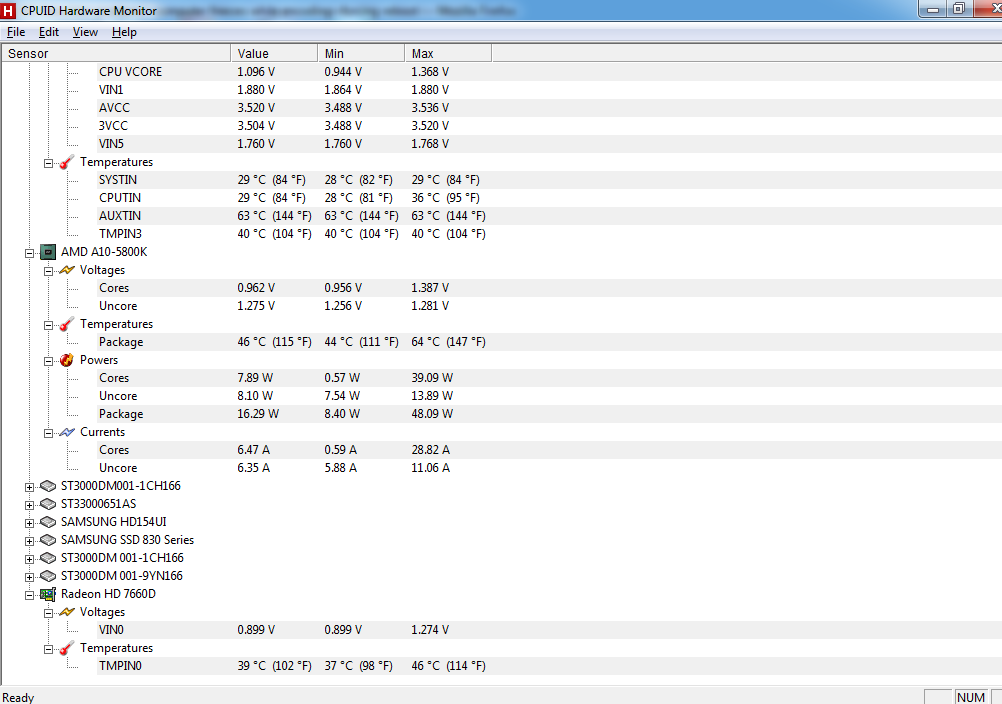

  19. Looks like some progress..CPU temps dropped to the mid 60s when running BD-RB. GPU temps dropped to upper 40s. Attached are idle and full throttle readings
Name:	2013-0221 HWMonitor-Idle.png
