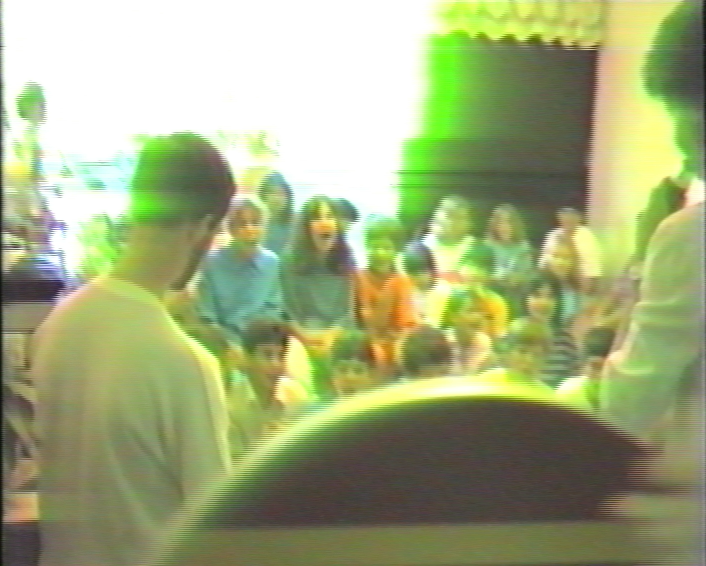

    i have a new video with a new problem that i never got before..

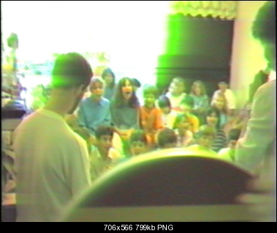

    this is the problem:
    I tried to move left the green by ChromaShift() but it doas not move that green Properly and make Things to looks worse..

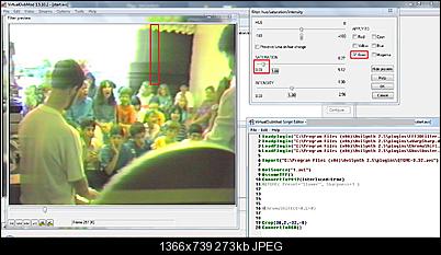

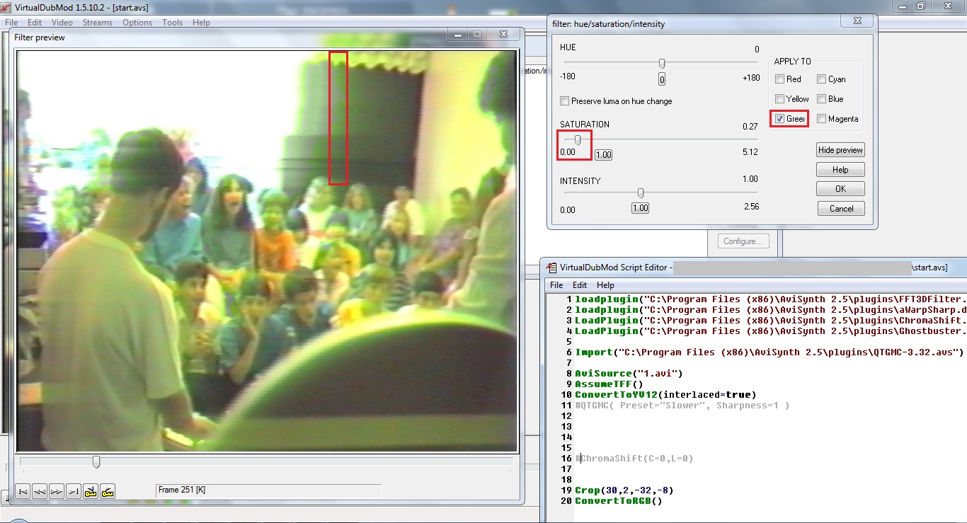

    I thought to weaken only the green by hue/saturation/intensity(1.2) in VirtualDubMod and it is the closet raiper i got:
    the hue/saturation/intensity(1.2) is Really WORSE plugin..
    how can i fix it?

    It does seem like a disaster .. But I saw here on the forum worse disasters
    thanks for the helpers!

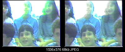

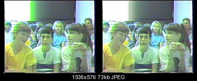

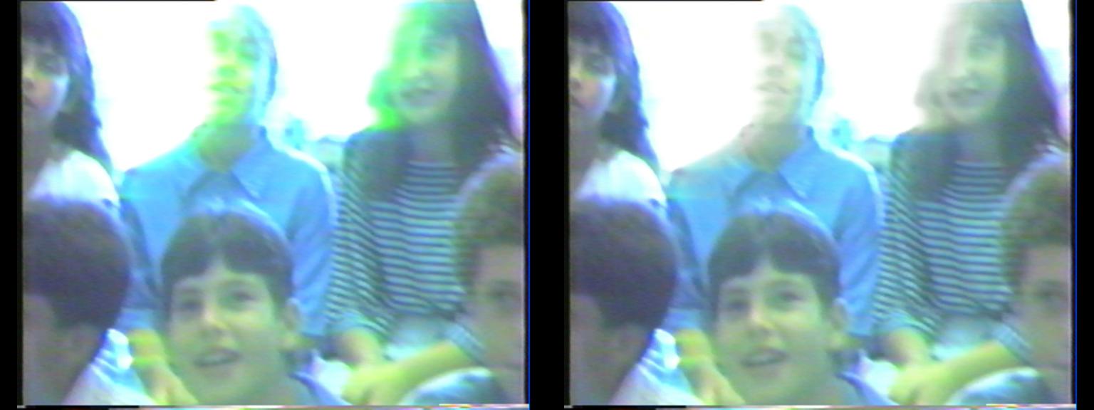

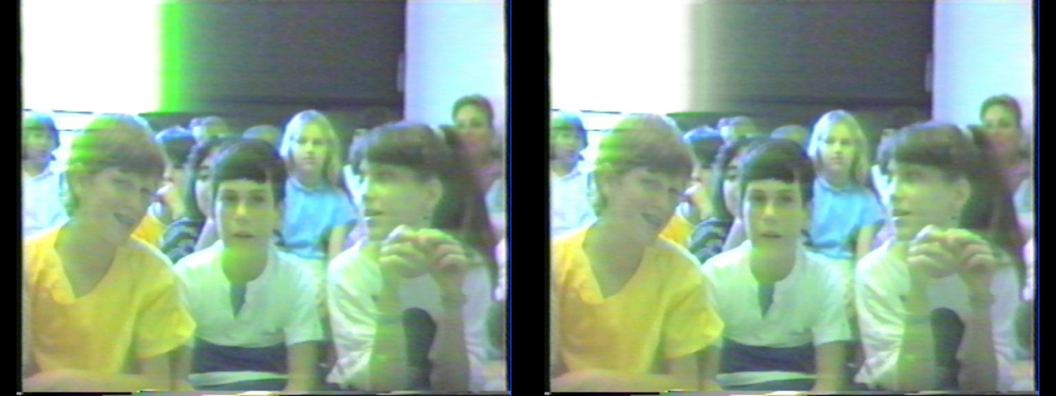

  12. I'm only addressing the green "bleeding" or whatever you want to call it. The result isn't perfect, needs tuning, and there's still a long way to go. But here's the general idea. Source on the left, treated on the right (simple bob for the demo):
    The script is messy and could be done in fewer steps, but...
    AviSource("new sample.avi")
    AssumeTFF()
    Bob()
    src=last
    # build a mask
    ColorYUV(cont_u=-256, cont_v=-256) # luma only
    ColorYUV(off_y=-200) # eliminate pixels below 200, needs tuning
    BilinearResize(16,576) # low res for fuzzy image, needs tuning
    ConvertToRGB() # for general convolution
    GeneralConvolution(0, "0 0 0 1 0 -1 0 0 0") # emboss, we only want light to dark transitions
    ConvertToYUY2() # back to YUY2
    BilinearResize(768,576) # scale up to original size, intentionally blurry image
    Crop(0,0,-16,-0).AddBorders(16,0,0,0) # shift image to the right, may need tuning
    mask = ColorYUV(cont_y=200, gain_y=1200) # adjust contrast, brightness, needs tuning
    inv = MergeChroma(src, Invert(src)) # inverted colors
    Overlay(src, inv, 0, 0, mask)
    StackHorizontal(src,last) # for comparison
    The video also has purple/blue bleeding on the dark to light transitions. That could be handled similarly.

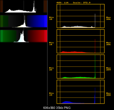

  15. I recommend examining the mask as it's being built by adding return(ColorYUV(autogain=true)) at intermediate stages. The script needs a better way of blurring the mask. BilinearResize() to a small width then back up is very crude and causes several problems (small bright patches are missed, the mask pumps as the camera pans, etc.). I'll look into that later. Also, something like GeneralConvolution() that works in YUY2 would be better (though it's just used in building the greyscale map so it's not big deal).

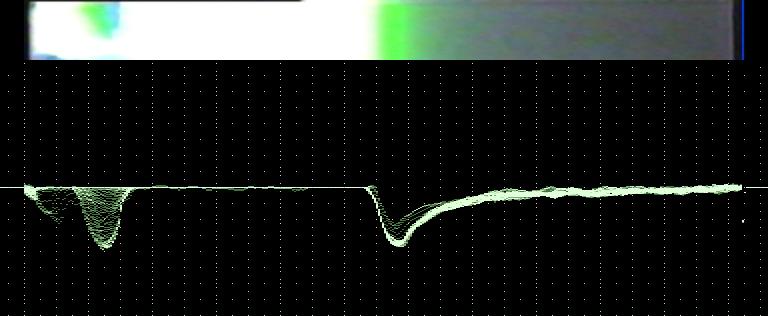

    Now we need use the mask to replace the green bleed. If you look at what the green bleed does at the transition between the bright window and the darker wall you'll see that the chroma channels are deflected down (V shown, U similar):

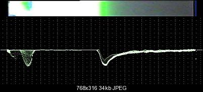

    So if the chroma channels were blended with inverted versions of themselves they would neutralize each other (resulting in grey). Inverted chroma:
    inv = MergeChroma(src, Invert(src)) # inverted colors  Overlay(src, inv, 0, 0, mask)
    and finally blend the inverted chroma with the original image using the mask:
    The problem here is that any real colors in the image will get neutralized too. A better solution might be to use a flat image that's the opposite color of the green bleed.
