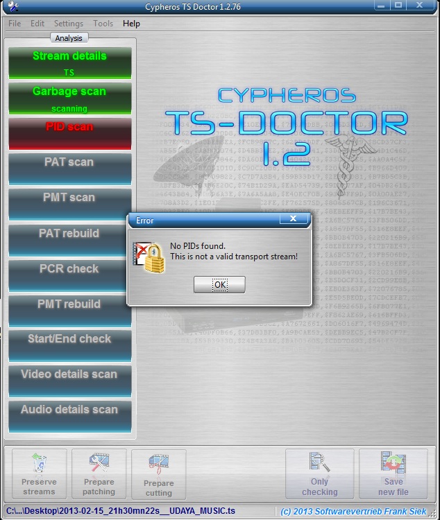

    You are exactly right DB83. Here a screenshot. First of all I renamed the file extension from .$ts to .ts and opened the renamed file via TS doctor and the result is this screenshot. What is he next step I have to proceed?

  14. The manual (page 10) says that if you have a 'transport stream defect' you should do a hard reset (power down, unplug and leave for a while). Try that. If it's not a corrupt file, or an encrypted one, then I am at a loss. I have tried analyzing your sample and playing/editing in various programs and it is simply not recognized. Maybe a software update would solve the problem. Sorry I can't be of more help.

    Unfortunately my ts-doctor trial has expired - I have no use for the full version. You may try the other scanning modes and the help files.
    All I know is that this program did solve a simlar problem some time ago which is when I advised that OP to try ts-doctor.
