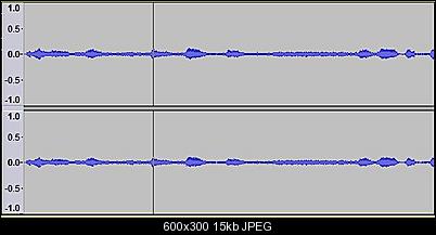

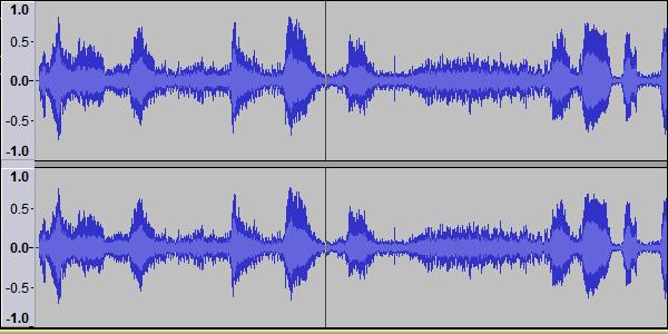

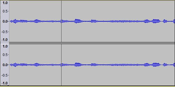

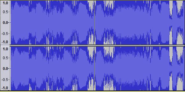

    Does the software you use have VU meters to monitor the volume level? If not, all I can suggest is go by ear -- just listen for distortion while you capture. Of course, if the distortion is on the tape you won't be able to work around it by adjusting the volume level. You can also load the audio into an audio editor and check the wave forms.
    Too low:
    Good:
    Too high:
    Originally Posted by gil900 View Post
    Do you have some tips for how to decide about the volume on each tape to make the process faster ?
    Too low:
    [Attachment 16279 - Click to enlarge]
    Good:
    [Attachment 16280 - Click to enlarge]
    Too high:
    [Attachment 16281 - Click to enlarge]
    i have this software. but to get the closet to "good", i need to set the volume level to 100%.
    and this settings was not good. so it can't be Sign for adjusting the volume.
    but Anyway that gave me the answer About what should be the standard volume.

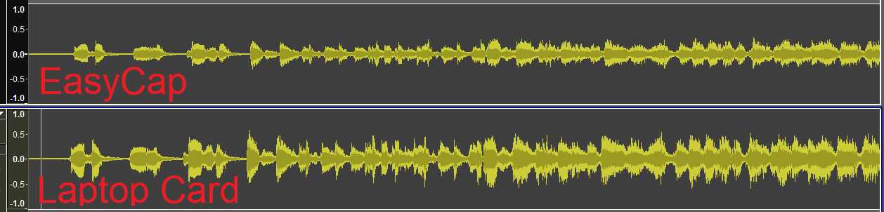

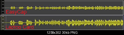

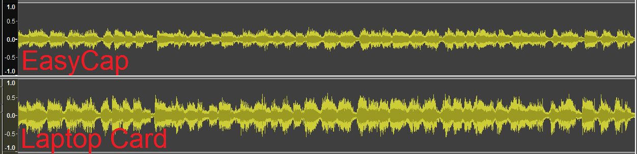

  14. OK.. I tried to record with the PC card device and with the easycap device.
    this is the Results:
ID:	16284Click image for larger version
    is that tell you Something?
    what is Better?
    i think i hearer the same noise but in the laptop it may higher
    EDIT:
    by what hello_hello wrote, i understand that the laptop card is better.
    I correct?
  15. In theory the laptop card waveform is closer to optimal.
    Assuming the "noise" you refer to wasn't there, then ideally the closer the audio peaks are to maximum without being "clipped" the better, because that'd give you the best signal to noise ratio (noise being any introduced by the hardware itself, which should be so low it's not really a factor).
    However if you're simply recording noise that's already on the tape then it's effectively part of the signal you're recording so the audio/noise level won't really change according to the volume at which you record.
    The perceived relative level can change quite a bit according to the listening volume, so in order to compare the two more effectively I'd use Audacity's normalising function to raise the peaks of both to maximum level (or adjust the volume of one until they both sound like their volumes are the same) and then listen for differences. That way the PC/sound card is also amplifying both by the same amount so any noise added while amplifying the recorded audio stays constant each time.
    It's even possible one method may record a wider range of frequencies, or have a flatter frequency response than the other, and sound nosier as a result because it's recorded a noisy signal more accurately, although hopefully that's not the case. The visual stuff can help to work out why you hear what you do, but ultimately I'd go with my ears, given I don't listen to audio with my eyes all that often.
  16. yes, the noise is in the tape.. I checked it.
    so i will use the laptop card for capture.
    i found this guide with your words("normalising function"):
    it may halp me

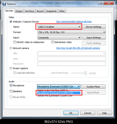

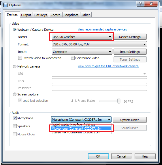

  17. Using a separate audio capture device along with a video capture card is a recipe for sync problems. Using the video capture card's own audio ports is usually safer.
  18. Originally Posted by jagabo View Post
    but i have no problem to do this on Debut Video Capture Software
    If you thought that i Recording the audio on other software and the video on this software so it may right but this is not the case
    I checked it and everything is fine
  19. When both the audio and video are captured by the same device they use a common clock for timing so they can get precise results. Different devices will be using different clocks for their timing. That can lead to the audio and video drifting out of sync over time. All you can do is try capturing some long videos and see what happens.
  20. OK i will test it and see if it.. thanks for the warning

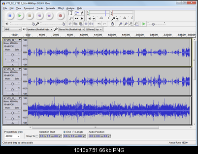

  21. Originally Posted by gil900 View Post
    if i change the Audio to the "good" then i have a problem in VLC Media Player when i change in this player the Volume to the max ( 200%) but up to 100% the sound is OK.

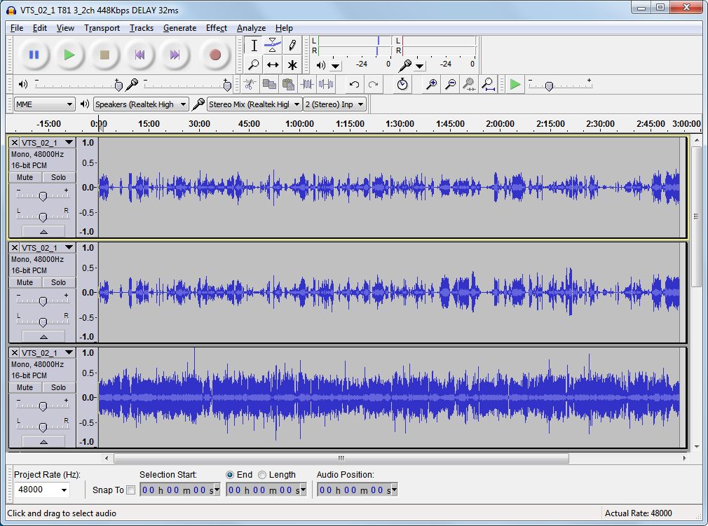

    Of course. VLC at 200 percent plays the audio back twice as loud as intended. The result is the same as if you recorded the sound twice as loud and play back at 100 percent. As you've seen, if the peak volume of the audio is over 50 percent, doubling it at playback will cause peaks to be clipped.
    Here's an example of three channels from a commercial DVD with 5.1 audio:
    As you can see, it has peaks all the way up to the max. But some may not have such high peaks. TV shows tend to have a smaller dynamic range.

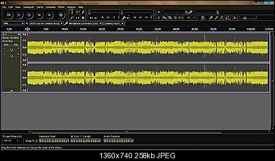

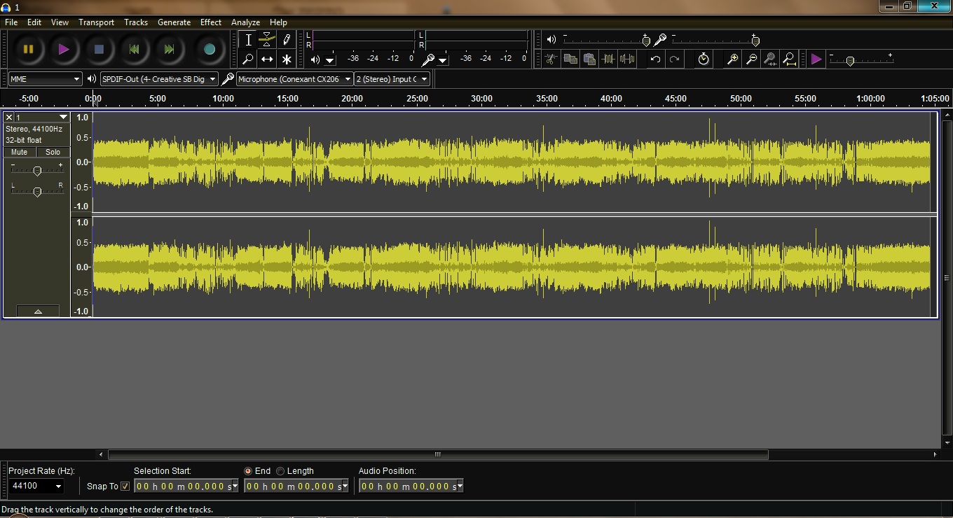

  22. the reason way i am asking about it is because this is the first time that i get this problem in VLC on 200% sound.
    so i think that something is not ok..
    this is how the audio look in my case:
    i make it by the "Amplify..." in Audacity.
    i hope that i did ok
    so is that ok? or i did wrong?
  23. Anywhere in that range is fine.
