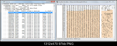

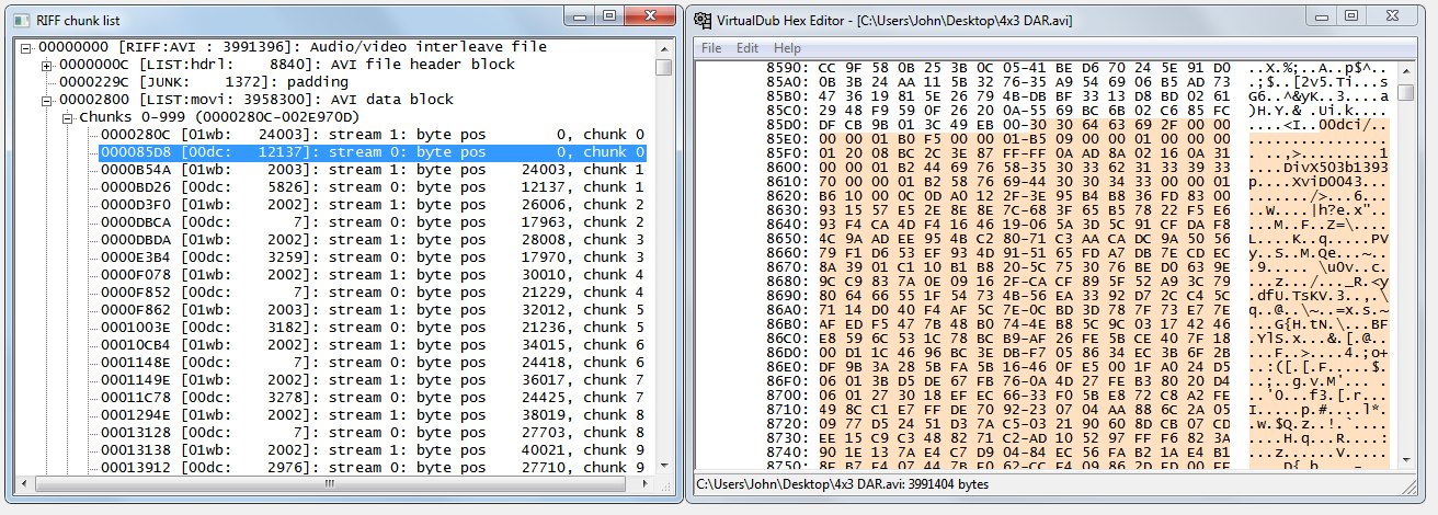

    From VirtualDub's hex editor and riff viewer:

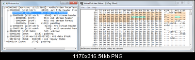

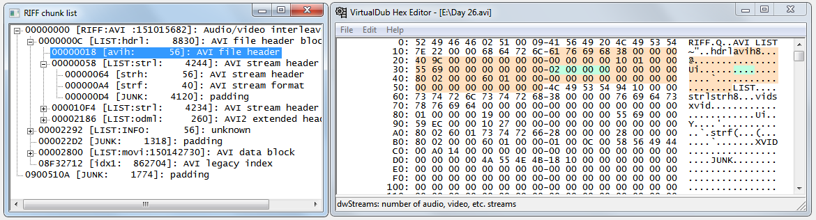

    In this example the "avih" chunk is highlighted (by clicking on the chunk in the left window) in the right window in orange. In the right windows you can see the first four bytes are "avih", the chunk's length is 0x00000038 (56 bytes). For basic AVI header elements the hex editor can show the field names. I clicked on the "02" in the right window and VirtualDub showed the size of that field (four bytes) by highlighting it in green. It also shows the name and function of that field at the bottom of the window (dwStreams: number of audio, video, etc. streams".
    You can probably write your own parser faster than you could analyze, understand, and adapt somebody else's.

    i just need the 00dc values. once i have that, then i can make dynamc adjustments to the seek position for each frame..should be instant once worked out..thanks.
  27. Originally Posted by vhelp View Post
    No, the audio and video chunks will be interleaved. You have to parse all the chunks. As with all chunks, the length of the chunk is the dword following the chunk ID. Your process be something like:
    1) read 4 byte chunk id
    2) read 4 byte length
    3) if this is a chunk you're interested in do whatever you need to do
    4) skip ahead (seek) length bytes
    5) repeat 1-4 until done
  28. Member vhelp's Avatar
    Mar 2001
    New York
    ok, i think i figured it out, no wonder why i wasn't getting it initialliy when i tried...the hex value are reversed, when i want to calculate the length, (the position after the chunk id) it is not 0AD4 = 2772, instead it is D40A which now = 54282, which is what shows in the above example. hex always confused me. so all i really need is the offset only, not the length. i will have to play around till i get it working in the seek routine. i'm getting closer. thanks again.
  29. Originally Posted by vhelp View Post
    Of course, AVI is an Intel architecture based container. Always little endian. I mentioned that earlier in post 12.
