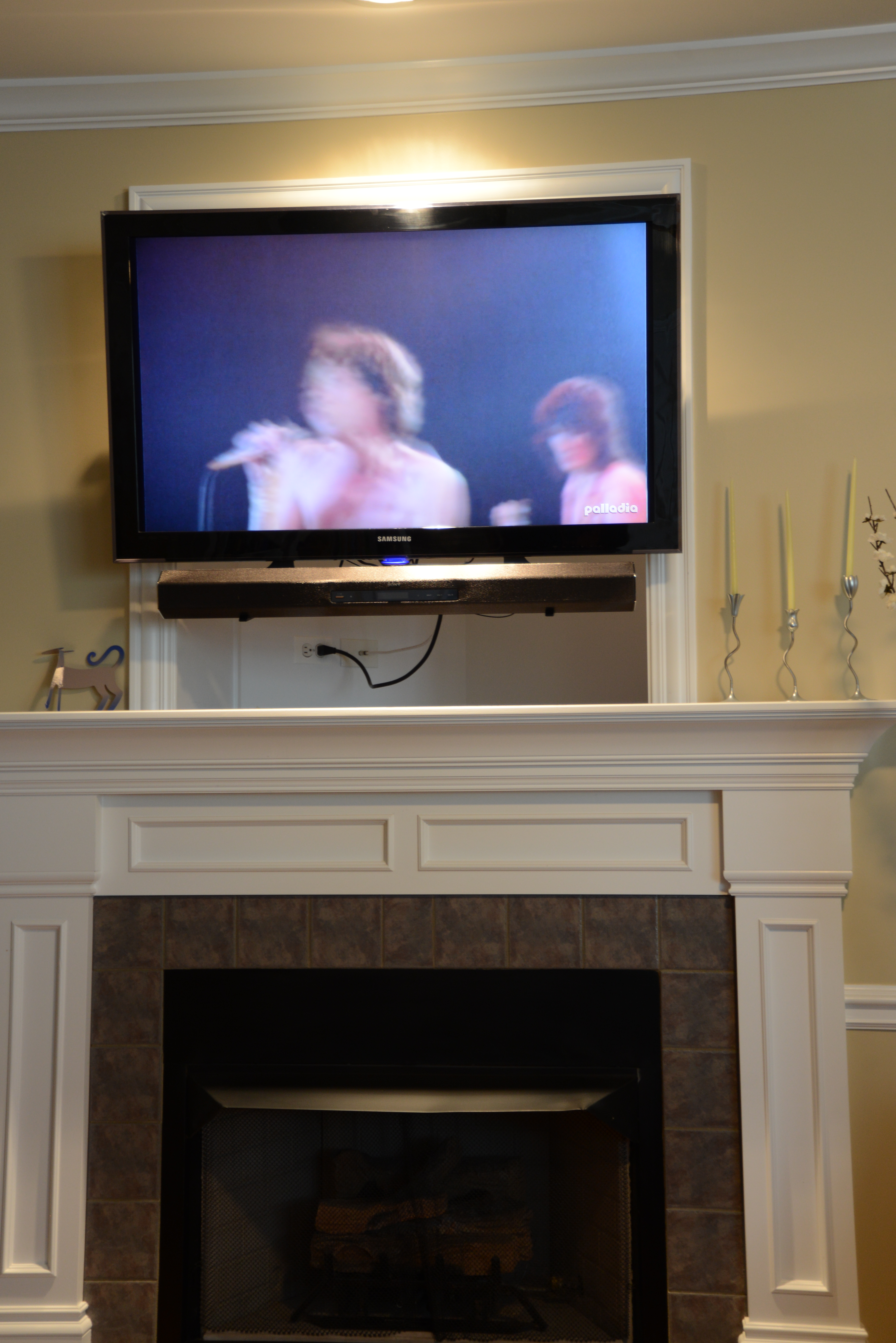

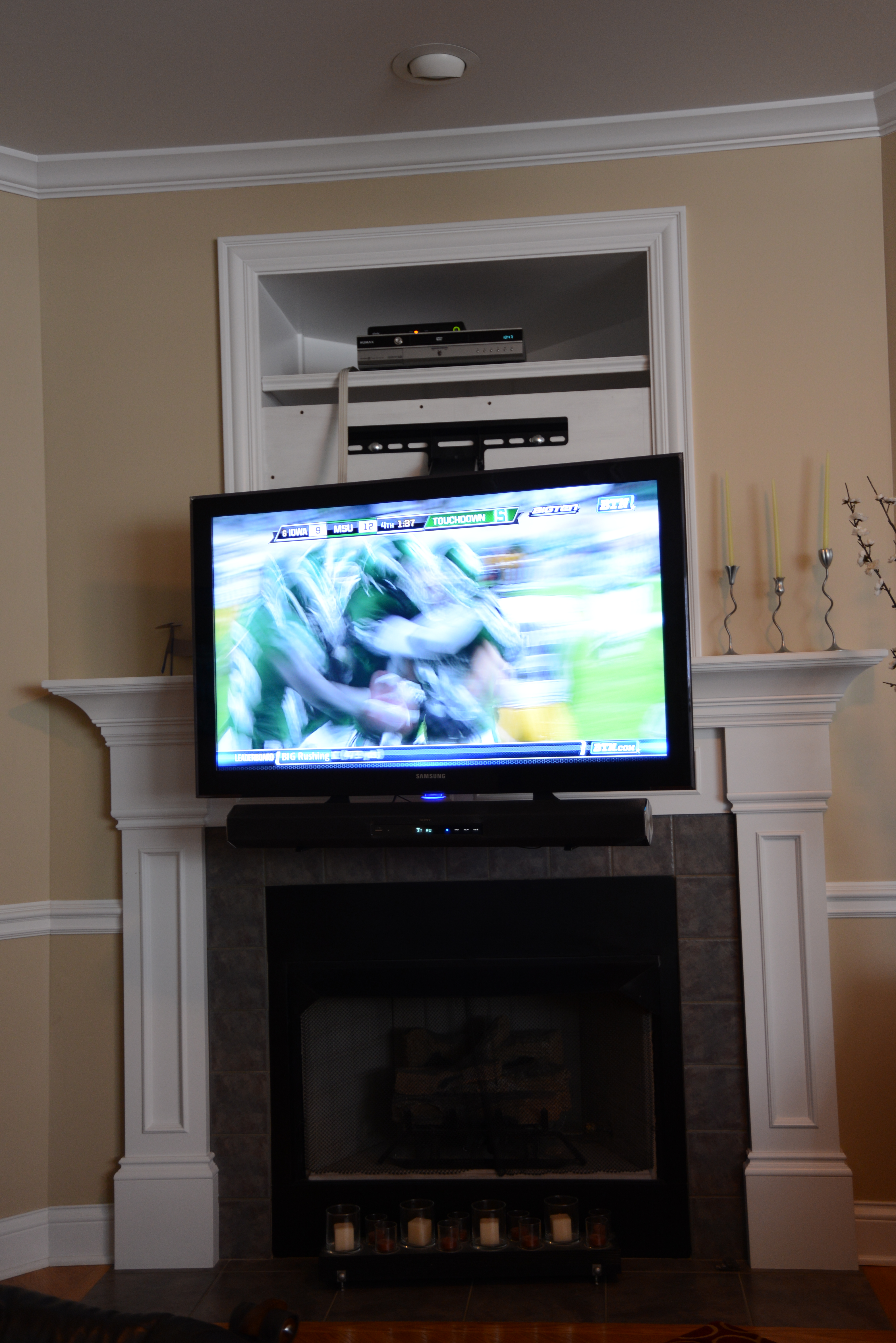

  5. I had a similar issue, where the alcove for my TV was above the fireplace mantel. Lots of space for components and the cords were hidden behind the TV, but the viewing height and angle were terrible. This was especially true, as the room is very long (open floor with living room and kitchen) and the wall angle was 45 degrees, so unless you were in one particular seat, you had an off angle view of the TV. I searched for a long time before I found a solution that was acceptable. The solution that I found was the Down and Out Swivel Mount from Dynamic Mounting http://www.dynamicmounting.com/index.php. It is more expensive than many of the less maneuverable mounts at over $500, but they do offer $100 rebates for getting the word out about there products.
    I had a builder friend of mine build out a short wall within the nook to attach the mount too. I'm pretty happy with the end results. The mount offers the flexibility that I was looking for and solved the viewing angle, height issue. I've attached 2 pictures of the mount in the up and down position. I still need to replace a few cables and touch up the paint to improve the visual appearance. I am impressed with the cable management as well as the ability to adjust the height of the TV on the mount as well as fine tune the force required to change the position of the TV. Overall a great solution.
