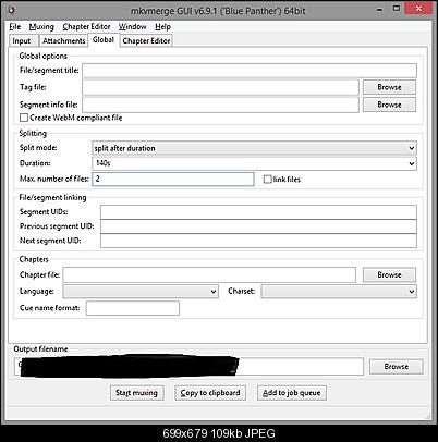

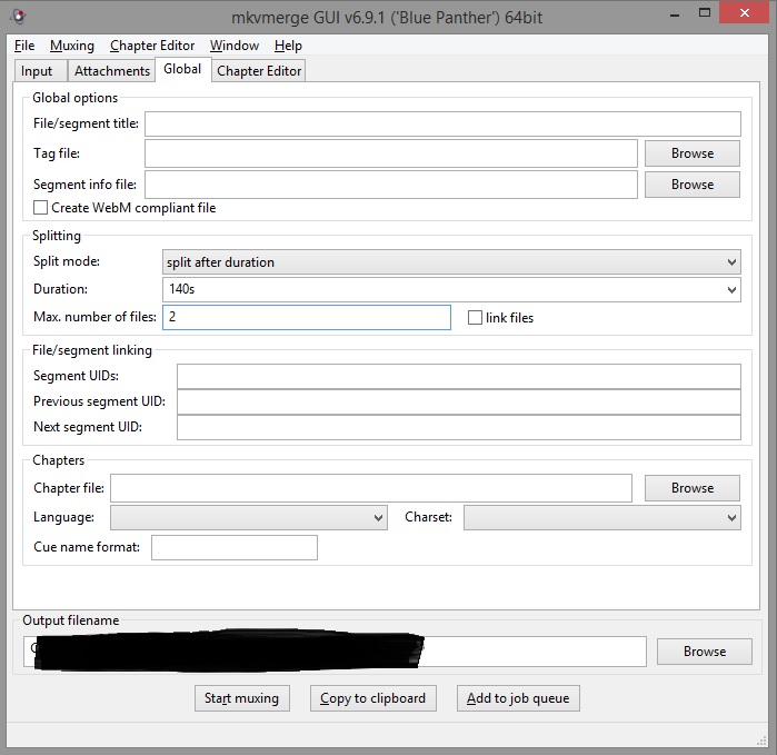

    I have done the splitting successfully using mkvmerge GUI v6.9.1
    all you have to do is to put the value "2" in the "Max number of files" field.
    so it will split the files to 2 parts, splitting in the time stamp you have given in "Duration" field.
    If you wanted to remove some part of the video in between,
    For example, you want to remove video part from 0:01:20 to 0:05:45, then do the following steps.
    1. split the file in 2, giving the duration for splitting as 0:05:45 or 345 [ (05min*60)+45sec ] and value "2" in the "Max number of files" field.
    you will get 2 files, one ending at 0:05:45 (FILE A) and other one starting at 0:05:45 (FILE B)
    2. now split the first file which is ending at 0:05:45 (FILE A), in 2, giving the duration for splitting as 0:01:20 or 180 and value "2" in the "Max number of files" field.
    you will get 2 files, one ending at 0:01:20 (FILE C) and other one starting at 0:01:20 (FILE D)
    Here the second file (which is ending at 0:01:20 is the one which you want to remove)
    So you the wanted file parts in 2 files

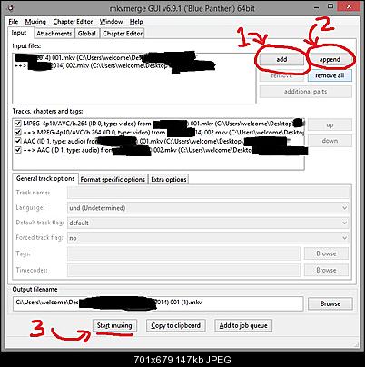

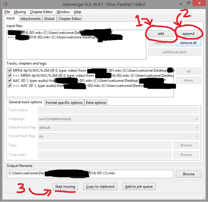

    3. Append the 2 files [one which is ending at 0:01:20 (FILE C) + one which is starting at 0:05:45(FILE B)] using mkvmerge GUI
    Done
