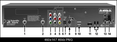

    Thanks again for all the responses, guys, you've been really helpful! I have a Scientific Atlanta Explorer 8300HD DVR. It has a few ports on the front that say things like Aux. Input, Aux. Video, and Aux. Audio. It also has a port on the front that looks like it may be a USB port. I hope this helps.
    Ever heard of Google?
    Optimum online: Scientific Atlanta Explorer 8300HD Digital Cable Box/DVR
    http://optimum.custhelp.com/app/answers/detail/a_id/2239/~/scientific-atlanta-explorer...able-box%2Fdvr
    DVR User Guide: http://www.optimum.com/pdf/user_guides/dvr_guide.pdf
    The USB ports won't help you. They are reserved for future use and nonfunctional.
    The eSATA port is used for attaching an external hard drive for extra storage, but the recordings are still encrypted and unusable by any device other than the individual box that created them.
    The only port on your DVR that might output a high-definition signal that you can capture using a computer without buying a capture device is an IEEE 1394 port. IEEE 1394 was used by some early HDTVs and video recorders instead of HDMI or DVI connections. However, there are very specific technical requirements for using this approach and even if they are satisfied, it frequently isn't possible to capture DVR recordings that way. The output stream is often scrambled or the IEEE 1394 ports are blocked to prevent it.
    Your best chance for reaching all the goals mentioned in your original post is still to use one of the two Hauppauge capture devices I mentioned to capture the output from the DVR's component video connections and RCA stereo audio connections or optical S/PDIF audio connection.
    Capturing from the HDMI port on a DVR is more difficult because cable boxes and DVRs apply HDCP to their HDMI output and HDMI capture devices are designed to prevent recording HDCP-protected output.
    It may be possible to use the composite and S-video ports plus stereo audio ports with a standard definition capture device. However, the resulting video will be of lesser quality than that obtained using component video for capture and it may only provide the opportunity to record a picture that is letter boxed, pillar boxed or both. You would need to get a standard definition capture device and software that ignores analog copy protection in the signal for your computer, or something like the Dimax Grex digital video stabilizer that removes analog copy protection to allow you to use a DVD recorder for making a DVD. I should warn you that I have seen reports from users that say the Dimax Grex and similar devices worsened picture quality to some degree, although not every owner experiences a significant problem in that area.
