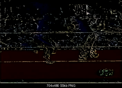

  13. I know that my original script with the original video left lots of pixels with Y outside the 16-235 range, but they were mostly oversharpening halos and the black borders, not really parts of the picture. If you want to eliminate them you can use opt=coring in ColorYUV().
    One way of seeing where all the superblacks are is:
    ColorYUV(off_y=240).Invert().ColorYUV(gain_y=2560)
