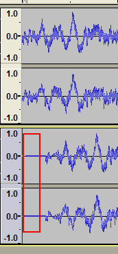

  4. Don't use AAC audio for intermediates. Many encoders pad ~40-60ms at the beginning
    Use uncompressed audio

    The 1st is more than a possibility. Yes, you started with MP3 in AVI container, but AAC in MP4 typically adds a padding muxing delay (at least many AAC encoders and MP4 muxers do). Each clip will be offset ~40ms . I repeat: it's terrible to use as an intermediate. Use search, this has been discussed before. If you don't believe me , test it yourself, zoom in to the timeline
    Name:  aac delay.jpg
    The solution is to use the same container and audio, or better yet uncompressed audio. ie. AVI + copy the MP3 , or AVI and uncompressed pcm wave . The problem is you are probably using AVC with b-frames . This can cause many problems in AVI container - mixed up frame order, green or black frames, b-frame decoder lag. If you encode without b-frames that should solve some of the issues , but reduce compression effciency
